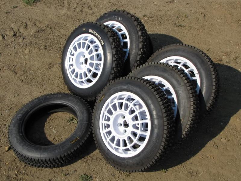

Here are some pics from the WRC, their tires are super narrow, our requirements are a bit different. We need a tire that gives excellent traction in snow and ice but at the same time handling on cold dry roads, the compromise would be a -1 / -2 sizing from your low profile tires or sticking with the base OEM sizing for your car. For us in the W203 it would be 205/55R16
And never deflate your tire, that is dangerous and not effective because then you are not applying equal pressure across the tread - don't believe that just look at your tires that have been driving around under-inflated, the wear are at both of the shoulders and not in the center. A snow tire will generate more friction because of the tread and underinflated can cause it to overheat on dry roads at highway speed.
And finally wider can be more slippery than narrower, look at F1 in the rain and even with rain tires they will spin as if they are ice. Rain tires for most motorsports are narrower than the standard dry tire
