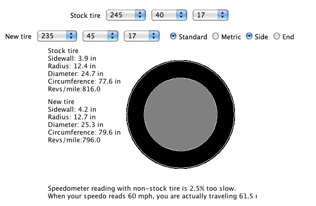

I have a '03 C230 SS rear tire is 245/40/17. Could I use 235/45/17?

see attached
225/45 17 would be better
Attached Thumbnails Can I possibly use 235/45/17 from 245/40/17-picture-2013-11-17-10.09.33-pm.jpg
