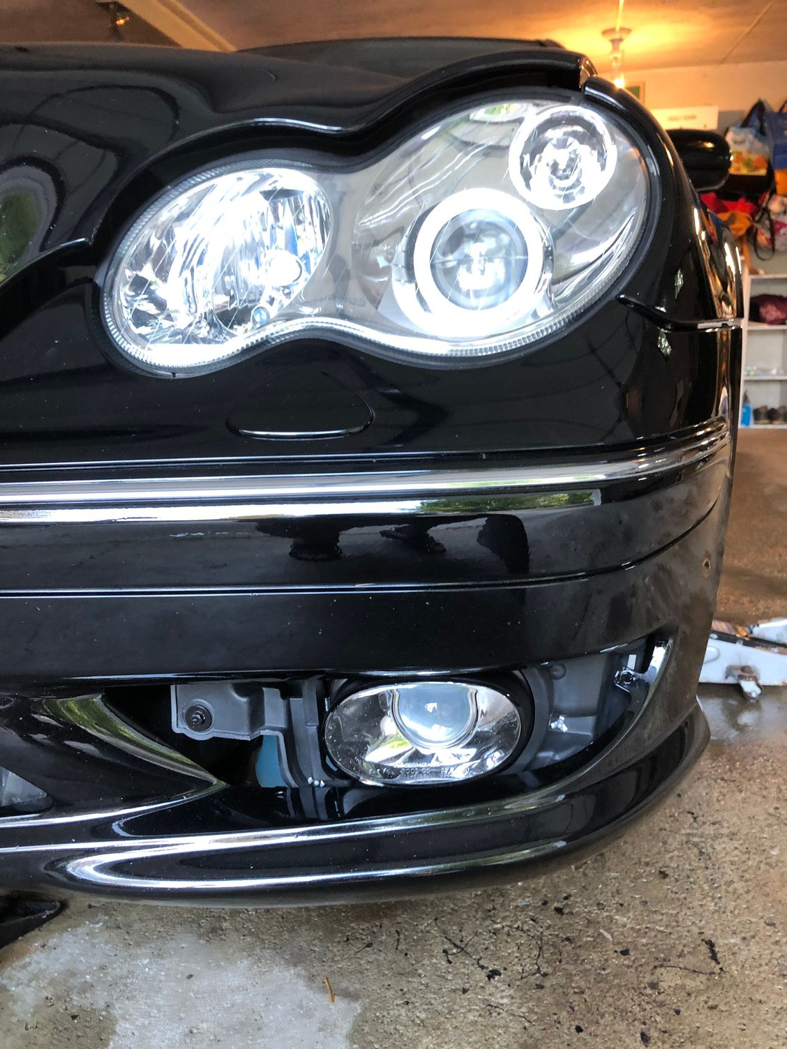

Just had the bumper off for some work - upgraded and replaced fog lamps with aftermarket projector style…
After installing, and going to plug in wire harness…I was very glad I installed my new Philips CrystalVision Ultra 4000 bulbs on the bench…the bulb is against the washer bucket.
I didn’t measure…but this image shows aftermarket and OEM HELLA being about the same depth…
Taking off the bumper is really easy. Just, no one ever writes about the front rubber clip tabs in the bumper that align/go under the headlight in the corner of the fender - just know they’re there…
Aftermarket fog lamp on left, OEM HELLA on right
Aftermarket project fog lamps
9006/HB4 light is able to touch windshield washer reservoir bucket…I haven’t fully aligned bumper to fenders nor tightened it all down…but if it stays this close…I’m putting foam between them, at least.
New projector style fog lights with Philips 4000 CrystalVision Ultra bulbs. (Note, height is high here are car is on jacks and safety stands.)
