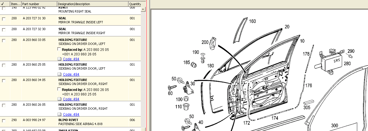

The airbag is riveted to the door which is surprising since the door was supposedly completely replaced by a high end body shop that charged 2500 for the job when it was dented at some point. I would have thought they would have just used bolts or something.

all door airbags are riveted to the door, that is the way they came from the factory. So your high end body shop was keeping it to spec
Attached Thumbnails Door lock acutator broken?-picture-2014-09-27-3.21.34-pm.png
