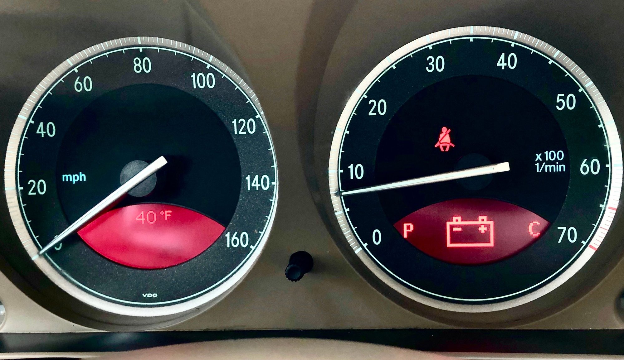

My SL550 displayed the dreaded red battery on the right side of the dashboard display and I checked both batteries, with and without the engine running. With the engine running both had good voltage - about 14, but engine off only the front starter battery was well above 12V. A new rear
battery along with a code reset did the job. All good now.
