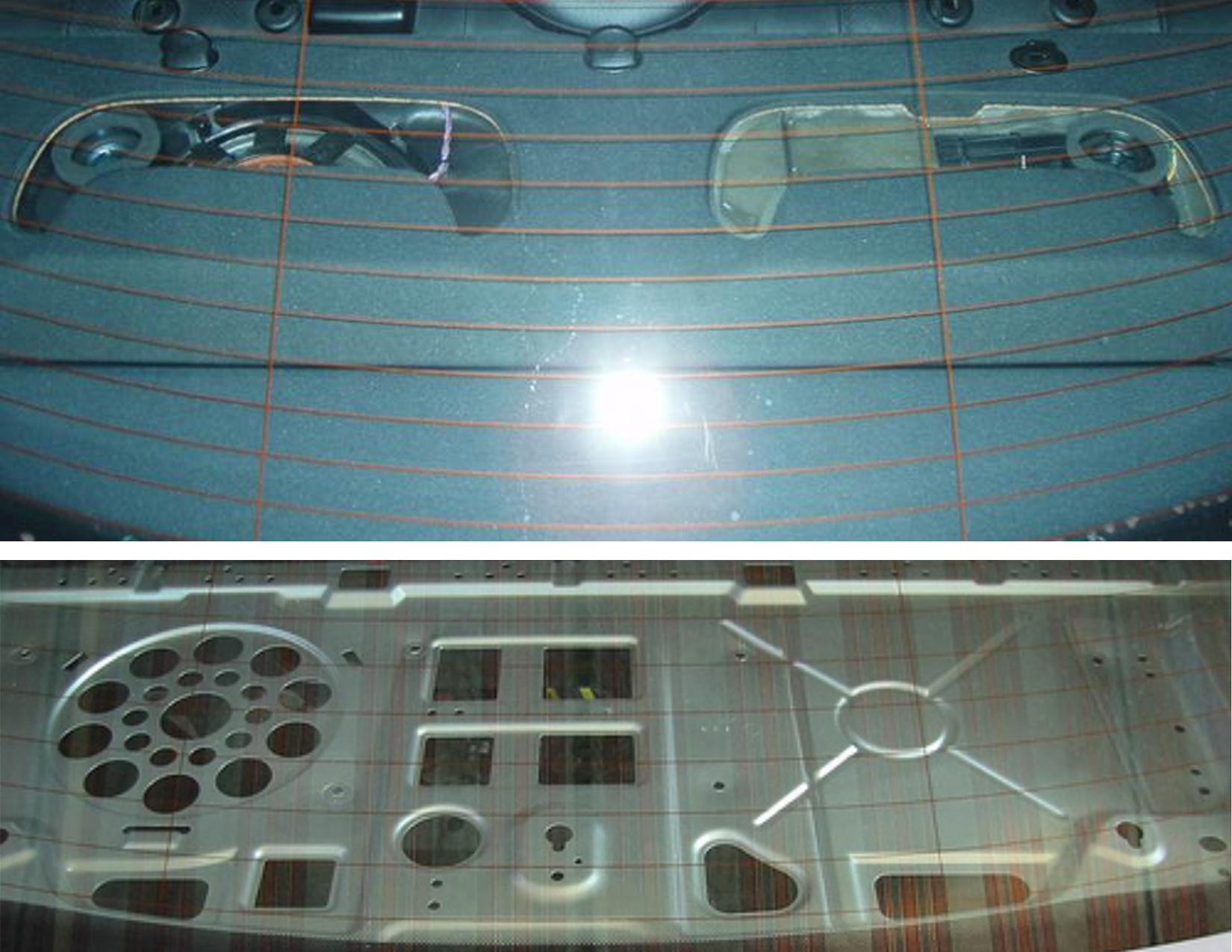

Here is a picture of rear deck with HK.
Attached Thumbnails Battery replaced, now Rear decklid H/K speakers don't work-w203_rear_deck-hk-all-removed.jpg

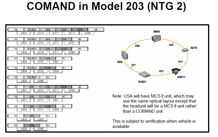

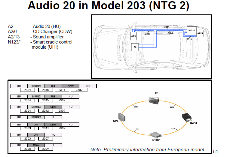

You don't state which car you have, but if it's a MOST-equipped system then I doubt it's your amp. Regardless of how many add ons you have (CDC, phone etc) the amp (if installed) is always second after the Audio gateway in the HU (also known as the MOST loop master). If your amp goes out you wouldn't get any sound at all, and it would affect the other loop devices behind it...
Attached Thumbnails Battery replaced, now Rear decklid H/K speakers don't work-w203-ntg2.png   Battery replaced, now Rear decklid H/K speakers don't work-w203-ntg2-comand.png
