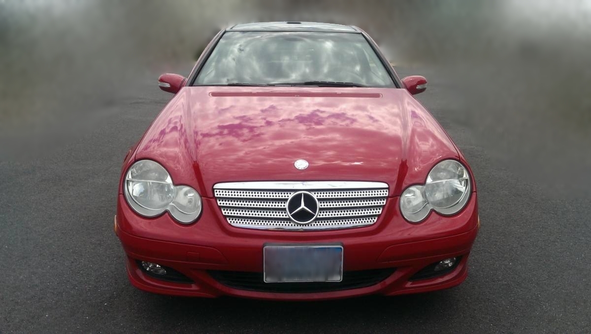

Damaged the front grill on my 2006 C230 Sport Coupe but can't find replacement. Googled and also searched Ebay and Amazon and there are a lot available but none look like mine (see picture that I found on line). Would any front grill that is advertised for a 2006 c230 coupe fit?

From looking online, it looks like the 2006 and 2007 C230 V6 Coupes have the same front grille as my 2005 C230K.
My 2005 C230K Coupe:
If that is the case, you'll find it very hard to find that grill. When that front grille came out, it became desirable for other coupe owners.

OP sounds Canadian, eh? Since 2006 C230 Sport Coupe is also known as "06 CL230".
Konstaner, if you're in GTA, I have a mint condition used plain slant fin grille as in your picture,.... I also have a used scratched bullet holes Evolution grille as in RedGray's photo.

Well,... your CL203 is really a C-class, not technically a CL-class (CL/CLS are coupe version of S-class). I think they just put CL on some of the Canadian CL203 as a marketing thing. I guess your CL230 have the "CL230" badge on the rear? Which makes it quite rare.
The slant grille as you have pictured is $100. Your photo has bracket behind the star - that's not included. Do you need that bracket? I have 2 of these (pre-facelift A203-880-03-83) slant grille, the other one I'm keeping since it's on my car with the Schatz chrome grille strips inserts.
For you, fitting a pre-facelift grille onto a post-facelift bumper might require some minor dremel work on rubber/plastic tabs on a non-visible part of the bumper.
I've decided not to sell the Evolution bullet hole grille (A203-880-12-83 (9744)) since it was such a pain to get it.
I also have a Mark Cummins starless fiberglass grille, very similar to Mattig grille but fiberglass - it looks like this:
https://mbworld.org/forums/c-class-w...l-c-coupe.html
I got it used and it cracked on the previous owner who epoxy it and then sprayed it with rocker-panel paint,... it'll need a lot of elbow grease to return it to shiny fibreglass condition.

Removed the front grill and the part # stamped on it is A 203 880 1083

A 203 880 10 83 is likely plain slant grille - post-facelift 2005+ coupe
I have,....
A203-880-12-83 (9744) - Grille assembly (post-facelift 2005+ C-coupe, with perforated holes - Evolution) - pictured top
A203-880-03-83 - plain slant grille (without bracket) - pre-facelift - pictured bottom
These are pictured below to give you an idea of how different to bottoms are,... there's A108-987-05-40 x 2 "Grille tab adapter" for putting post-facelift 2005+ grille on pre-facelift bumper (still need to dremel middle part) as this was a popular mod for those with pre-facelift coupe. But there's no similar adapter for putting pre-facelift grille on post-facelift bumper (what you'd be doing here),... thus, you're better off looking for a post-facelift grille.
Depending on how damaged your grille is, I would suggest epoxy glue from the inside/back. Also, the plain grille are always good candidate for (usually carbon fiber) wrapping.

Ok I understand -- Parts of the two ribs at the top left and right of the star are actually broken off and missing -- Have neatly trimmed them and wondering if I should use epoxy or "Gorilla crazy glue" to glue parts of the lower ribs that separated.

Use a good name-brand (Loctite, 3M, etc) two-part epoxy. The 5-min stuff is more than strong/good enough for the grille.
You do not want to use a "Super Glue". That bond is too ridged and the thermal coefficient of expansion of "Super Glue" isn't a good match for a plastic grille that is exposed to outside temperatures between -7F and 102F (and those ~10 year temperature extremes are just in Central/Southern New England!).
In fact, the front grill could be exposed to even higher temperatures in hot Summer sunny rush hour traffic.
