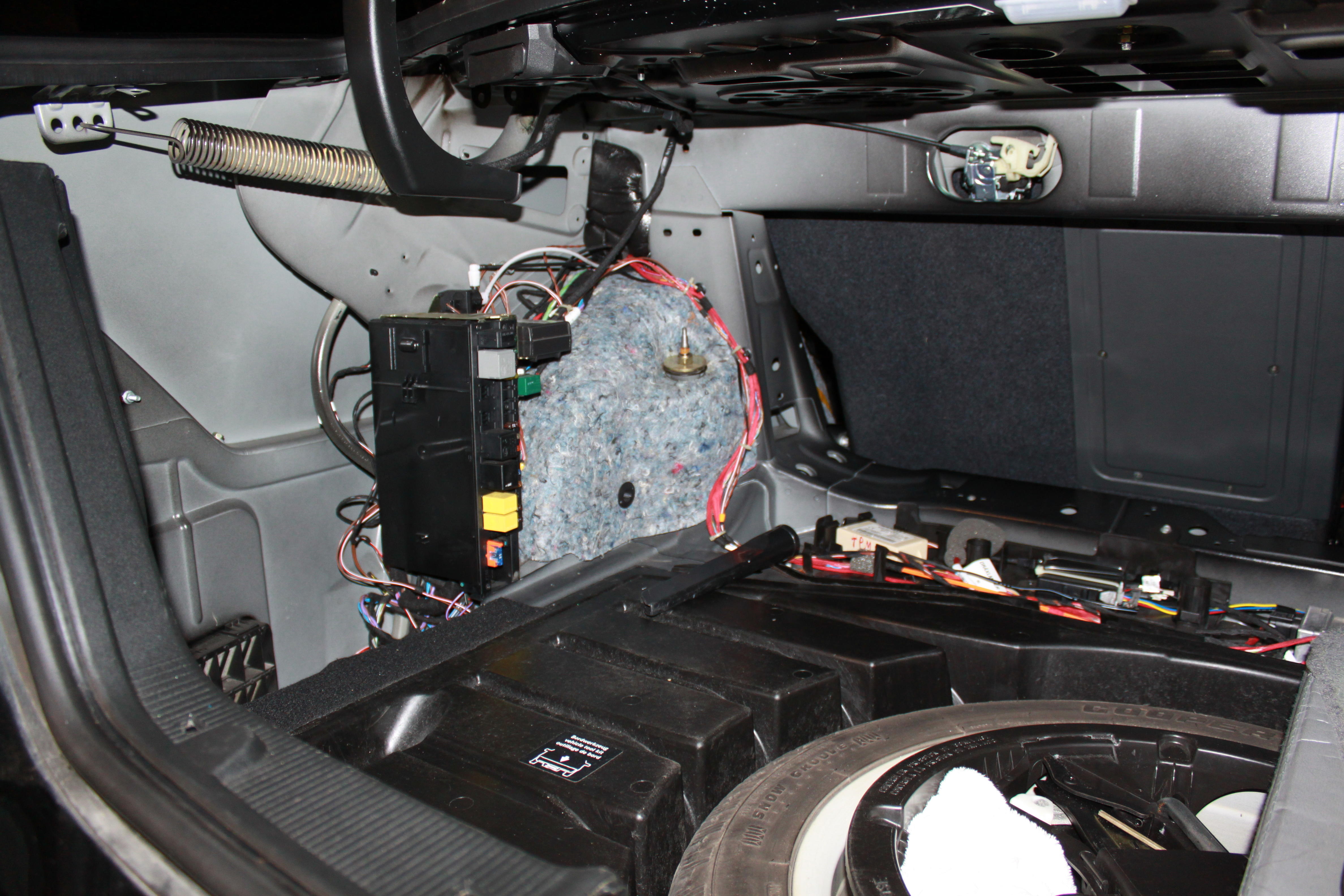

You will need to upgrade your upper control panel with one that can send the CAN signal to the rear SAM to activate the retrofitted sunshade.
There is a CLEAR step by step in the Retro-fit section of WIS.
(I can try to post at a later date...)

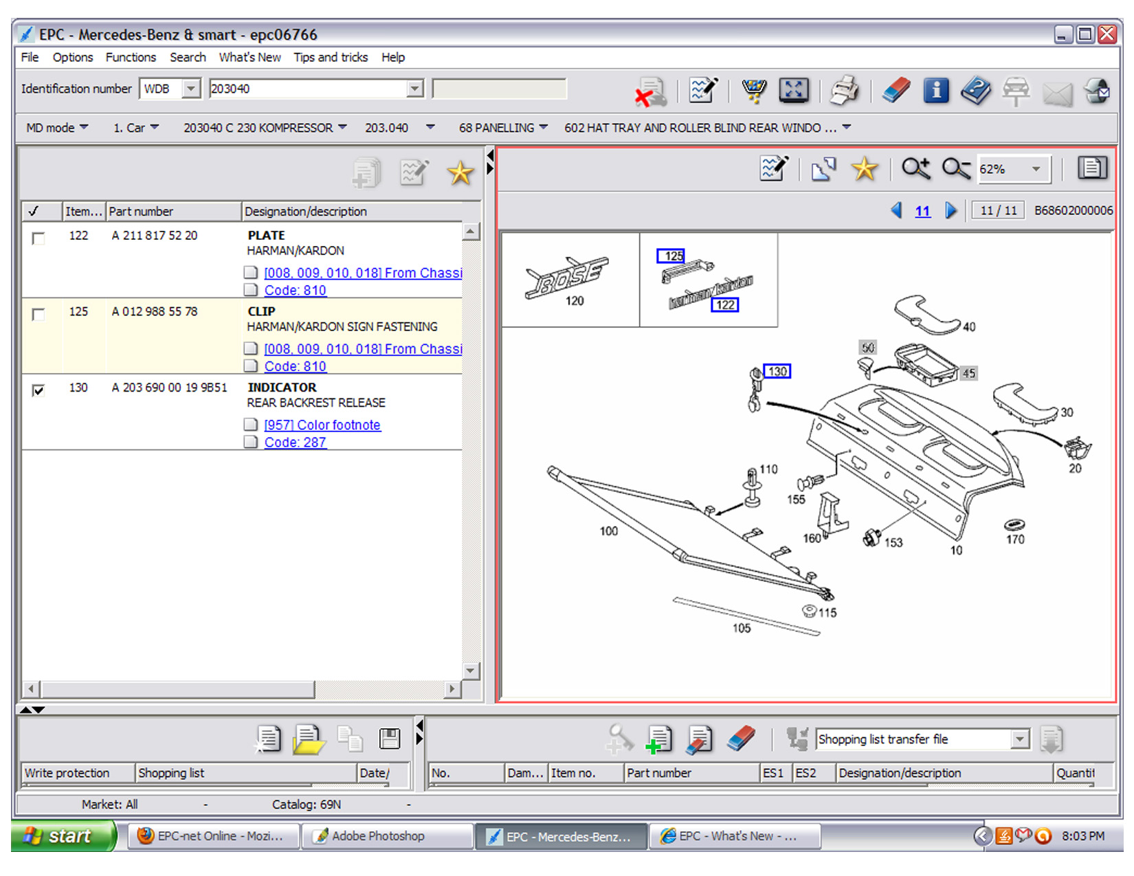

Essentially you install the switchrow, the rear sunshade and parcel shelf (I would get a complete working unit out of a wreck/eBay) ENSURE the tabs and clips are intact - there are some "fragile" and glued in clips/etc. Then, you plug the motor into the rear SAM.
Again...I can try and support later - but I KNOW searching the forum you can fins stuff here - even on polarity reversing/etc...
