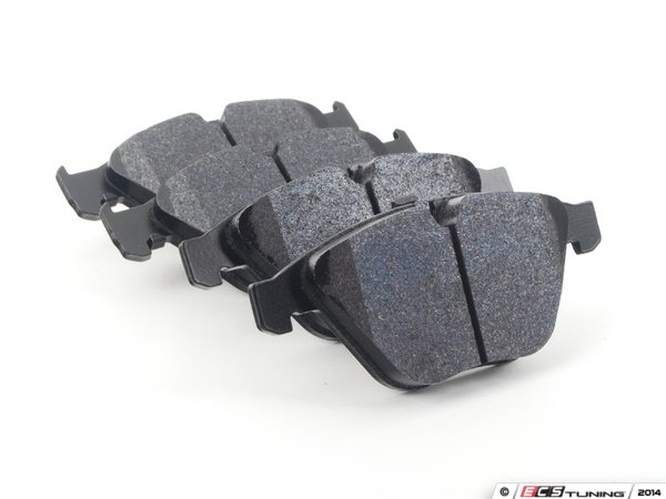

Who did the brakes?
Very roughly, the wheel should turn with less than ~15 ft/lbs of effort.
Btw, for cars/automotive, it's front/back, not medial/lateral.
Most new brake pads have tapered edges. That's to allow the pad to seat/break-in properly.
https://www.ecstuning.com/b-hawk-par...hb551b.748~hk/
