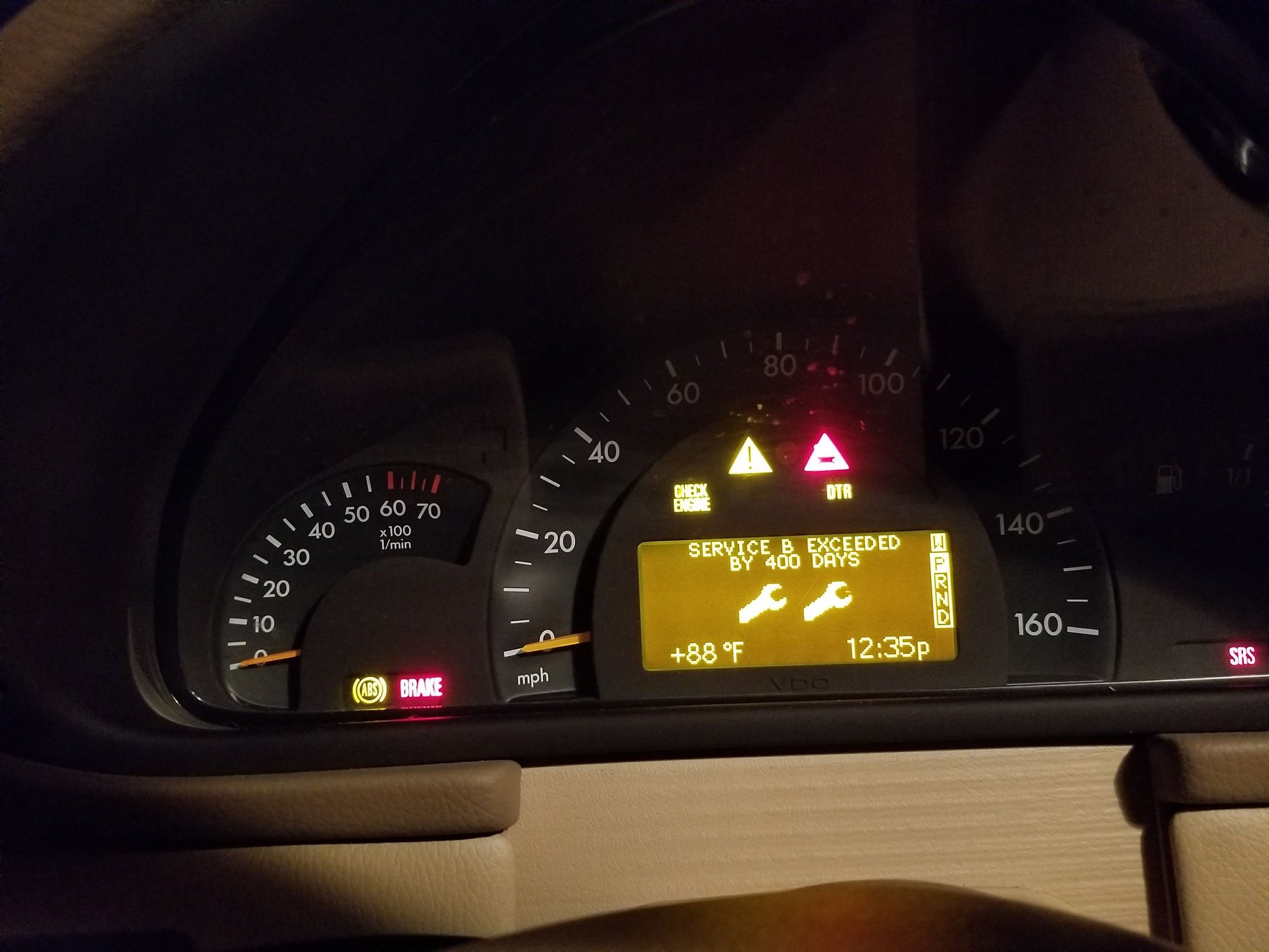

Hello, I need a little help, actually, a LOT of help.
I have a neighbor that has a 2001 C320. She bought it over a year ago, used it for about a month and left it in the garage, sitting!! She said, “I haven’t turned it on since”.
She asked me if I could help her get the car to turn on. I said, I can try. Well, there’s several issues. For one, I have never worked on Benz, only on American cars. Two, I have never worked on a car that’s been sitting for over a year.
So what I’ve done so far. I tried to turn it on, dead! Battery didn’t charge, so I got a new one. Installed it after removing the cover, which looks like it has some kind of filter on it.
So good so far, checked the oil, still has oil and shows the right amount. It has antifreeze, ok, time to start it up and it turns but does not turn on. Ok, so go to start it and she says, oh, it doesn’t have gas, ohhh okkkkk. So we put about a gallon she had in the garage for her lawn mower. I try to start it again and it turns but does not turn on.
Do I need to replace plugs? Or what should I do to get it to turn on. I attached a picture of the console.
Suggestions?
Service B??
Console info

Its still just a car. Is the check engine light on? This would give you an indication. If it is you would have to get a OBDII reader for basic codes. If the CEL light is not on then I would suggest simply adding more gas, at least a couple of gallons. Does the fuel pump turn on when you put the key in position II for a moment before you crank? you could check for fuel deliver by looking under the hood. Remove the air filter and check the fuel rails, there will be a knurled screw cap covering a shrader type valve. Push it in to see if there is fuel pressure.

Check OBD codes, see what they mean,
