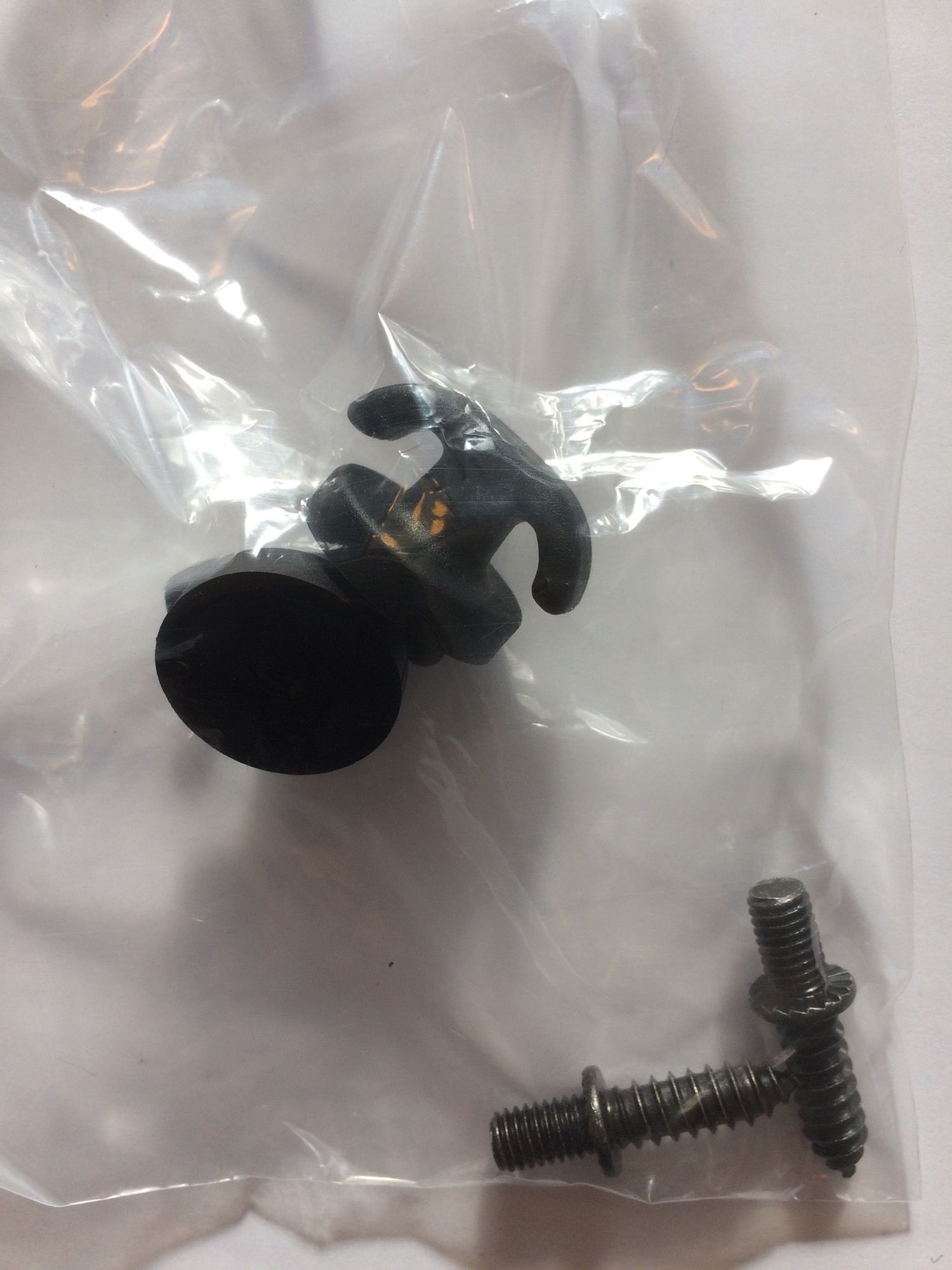

I need to determine the best location and method for attaching the upper anchors. The net I bought from Amazon includes attachment hardware shown in the first picture.
Attachment hardware

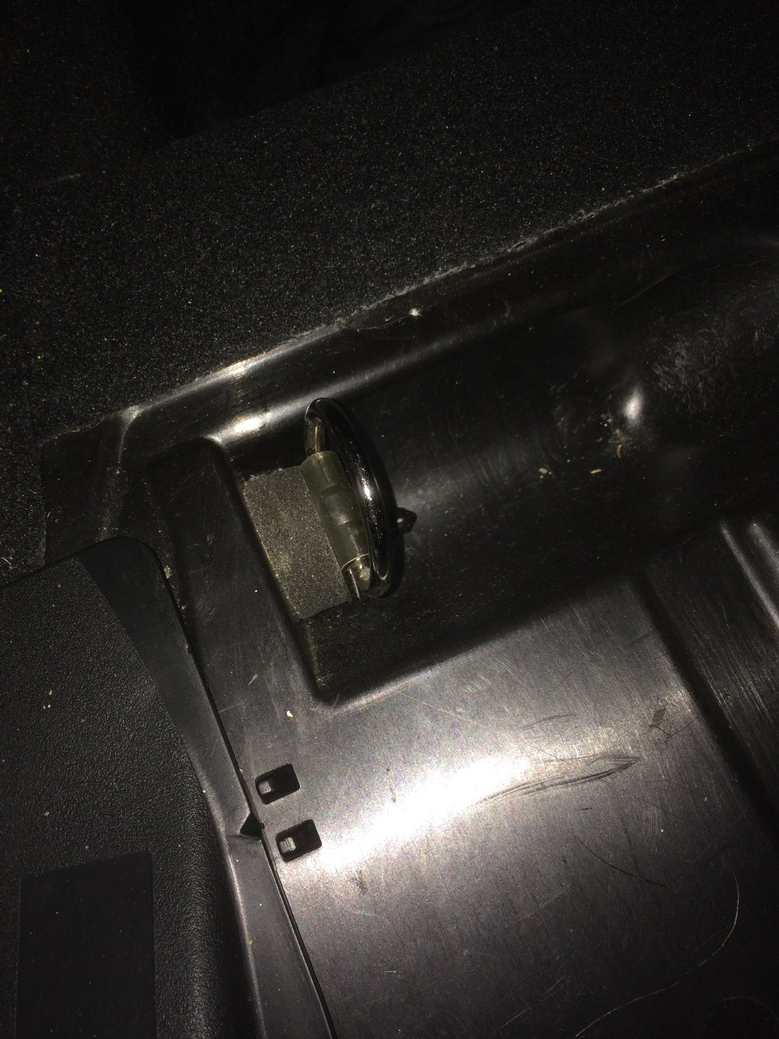

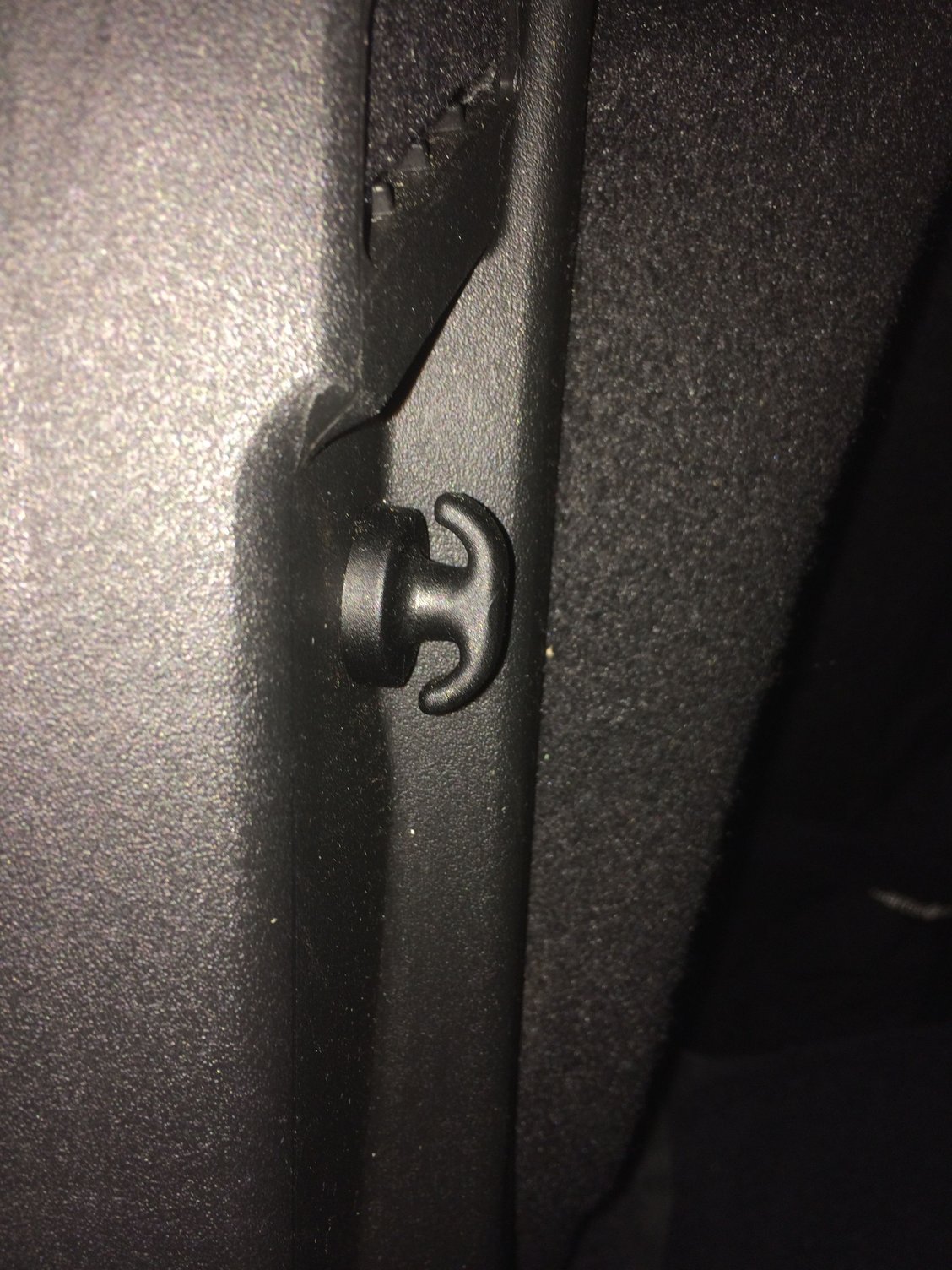

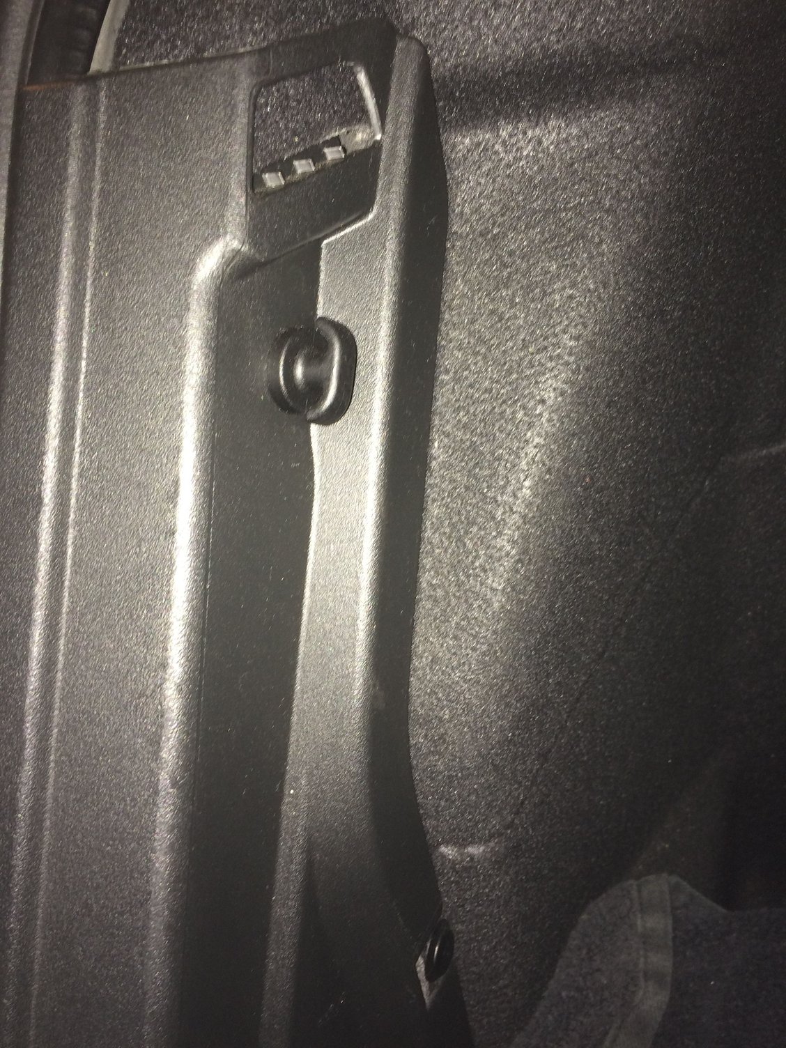

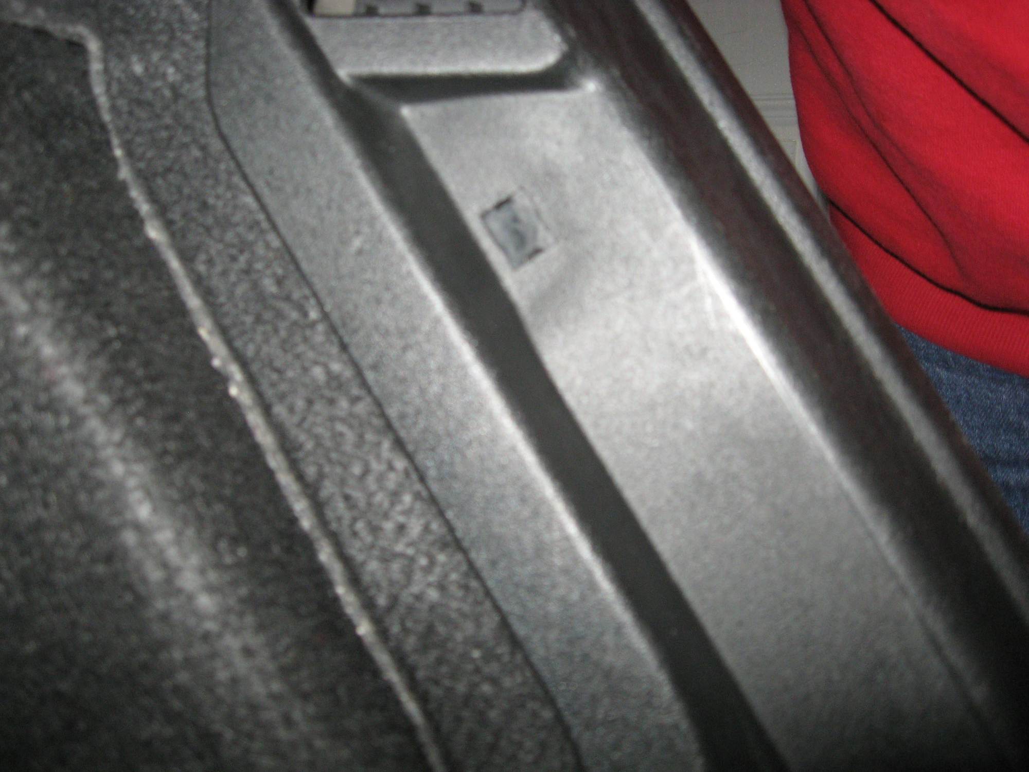

The kit also includes some screws for securing these to the car. I'm trying to determine the best place and method for attaching them. I this picture of the back wall of the trunk, I can see a black plastic rectangle that appears like it will pop out if pried with a screwdriver.
Possible attachment point
Another view
Has anyone installed a net and used this area to attach an anchor? I don't want to drill into anything and cause damage. Also, there may not be enough clearance for the anchor from the kit and I'm wondering whether there is a Mercedes part that might be a better fit.
Thanks in advance for any suggestions.

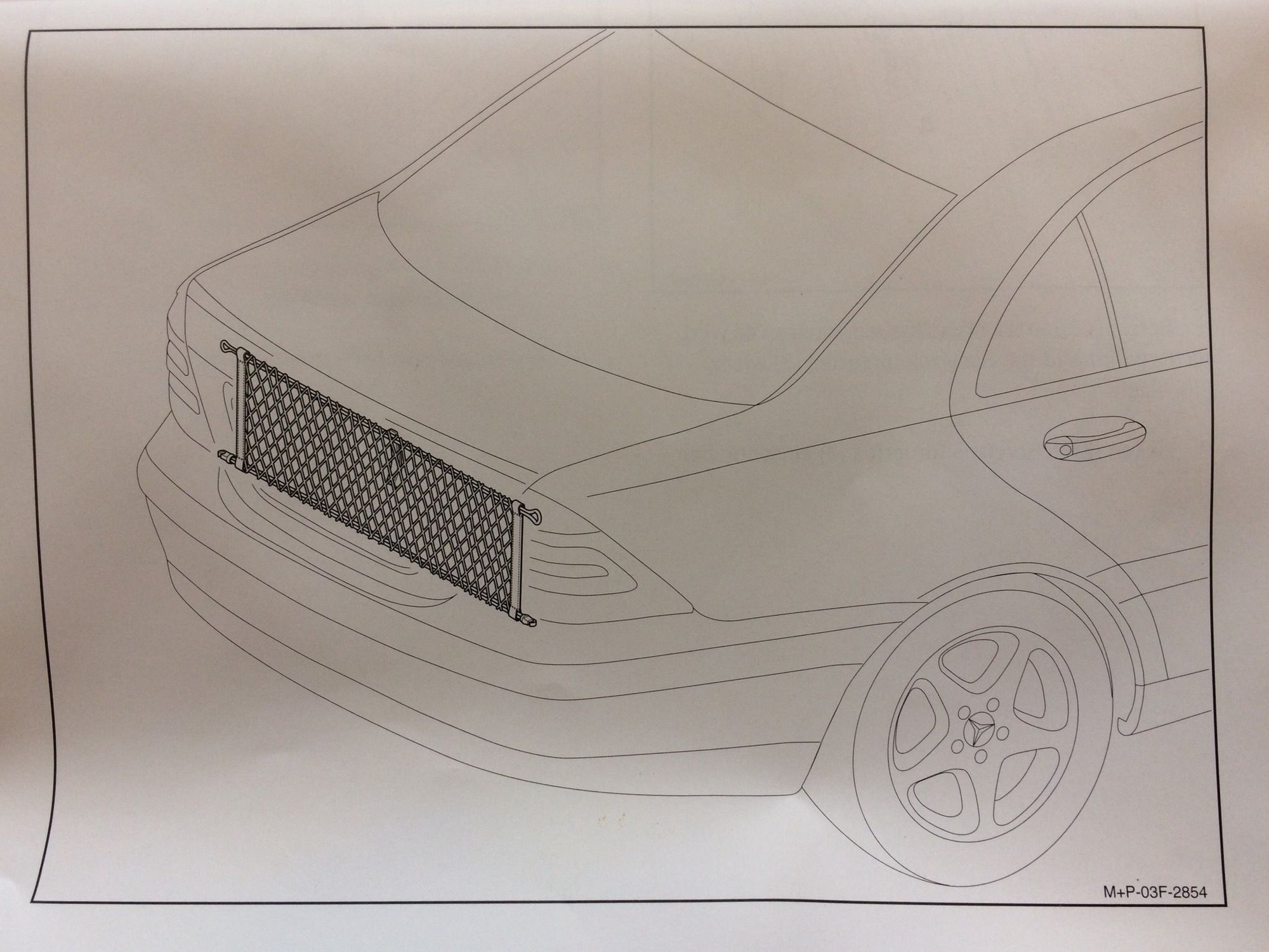

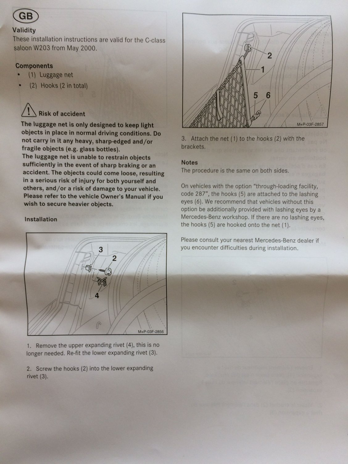

Here you go!
Hope this helps...
I’ll look for OEM instructions too...

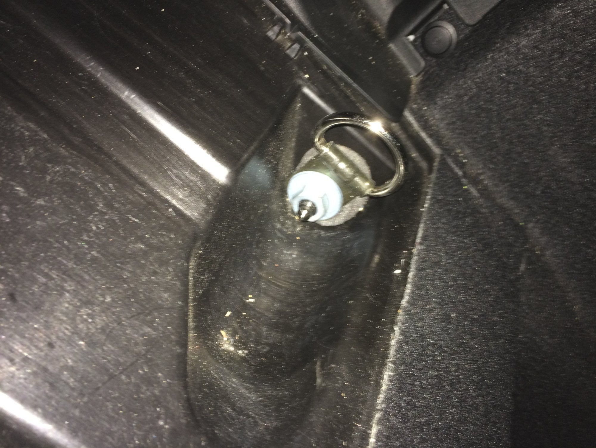

More
pictures...

This should
do it.
2109840929 are the bolts needed for the front D rings.

Step 2.

Many thanks. This is exactly what I need.

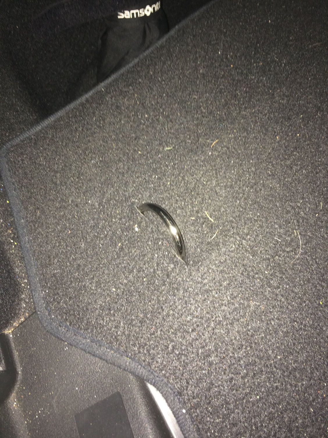

Am I correct that this is the rear D-Ring? (The one closest to the back of the car.) I think the thread I referred to may have had the part numbers swapped between the front and the rear.
Do you happen to know the part number for this part?
Thanks

I "modified" the hardware that came with the net to make it fit in the spot for the upper attachment points.
Hardware from kit trimmed to fit trunk panel
The plastic "rivet" can be pried out of the trunk trim panel using a small flat-headed screwdriver. Once out of the trunk you can separate it into two parts. The part with the opening is reinserted and serves as an anchor for the attachment hardware.
The "plug" is no longer needed.
Here's the net installed on the upper anchor points.
I found a two-pack of the D-Rings on ebay for $9.97 shipped. They won't arrive for about a week, but I should be good to go when they do.
