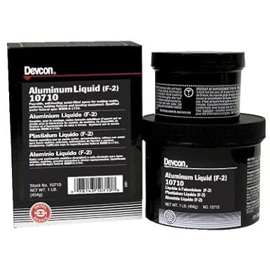

Btw, for those that would like to know what *I* would use, since I do not do things the cheap/cheapest way , I would use some of my Devcon Aluminum Liquid (F-2) Part# 10710.
Still, I have used JB-Weld in the past.
In fact, on my Stang, I used it, over 15 years ago, to additionally secure some adjustment bolts, that should never ever ever ever move. It also protects the bolts/nuts from the elements (dirt/rain/etc). That part is also rather close to the very hot headers. Even today, that JB-Weld looks like new.
However, I've since learned about the Devcon specialty products, and know a number of people/companies that use it. And, I like those Devcon products even more. :-)
Devcon Aluminum Liquid 10710.

There may be other solutions, such as gluing in a stud with previously suggested Devcon aluminum weld or something. I suspect they may just be high quality epoxy products, not your lepage 5 minute stuff.
