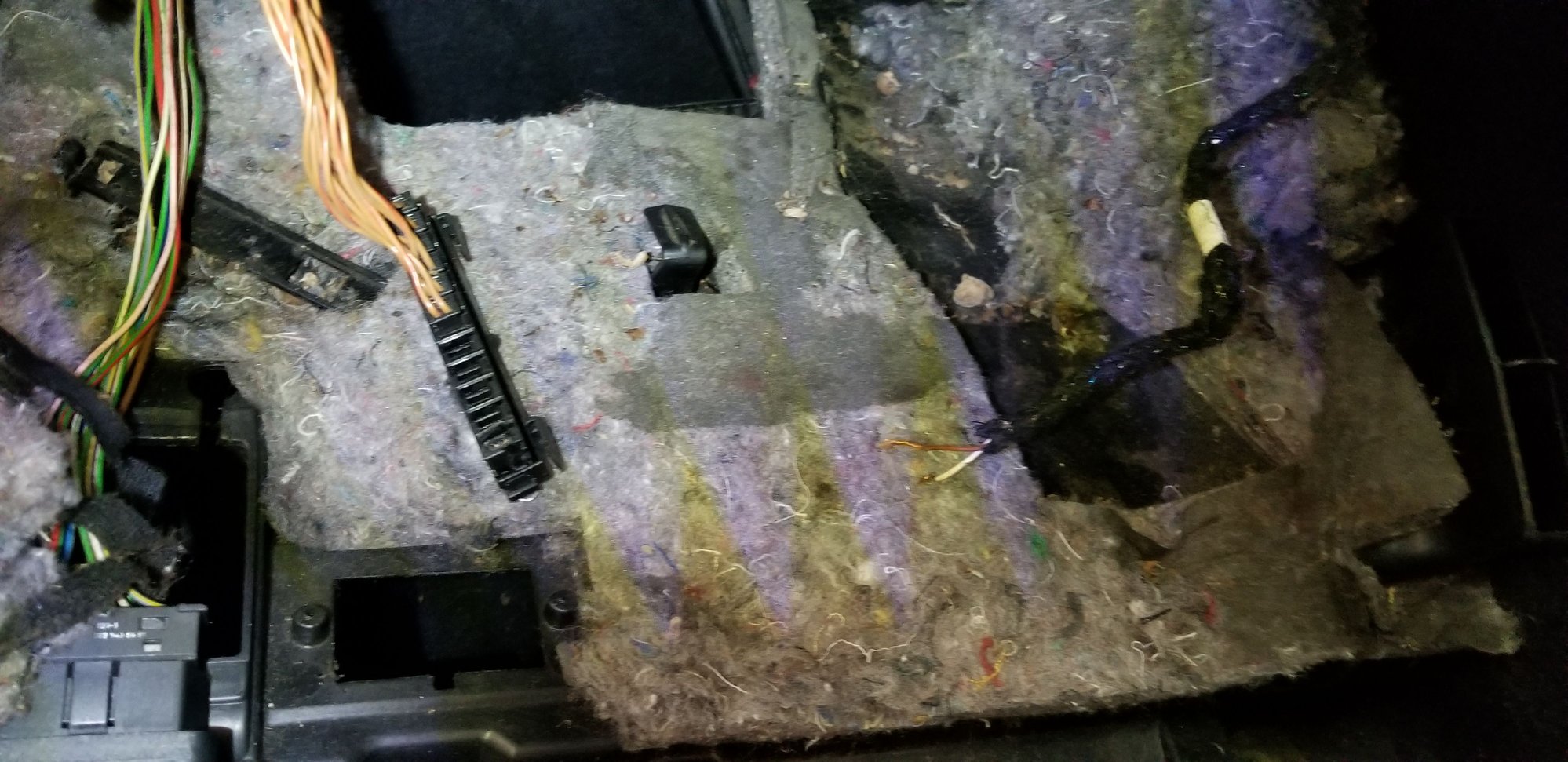

Besides the potential of having a bad TCM and/or transmission, bad key, and possibly broken shifter assembly, I'm thinking I may have a wiring issue. When I removed the panel under the steering column, I found this wiring harness (with brown wires) dangling down along with the two wires (brown & white) on the right. Does anyone have a clue what it is any why anyone would have disconnected them?
