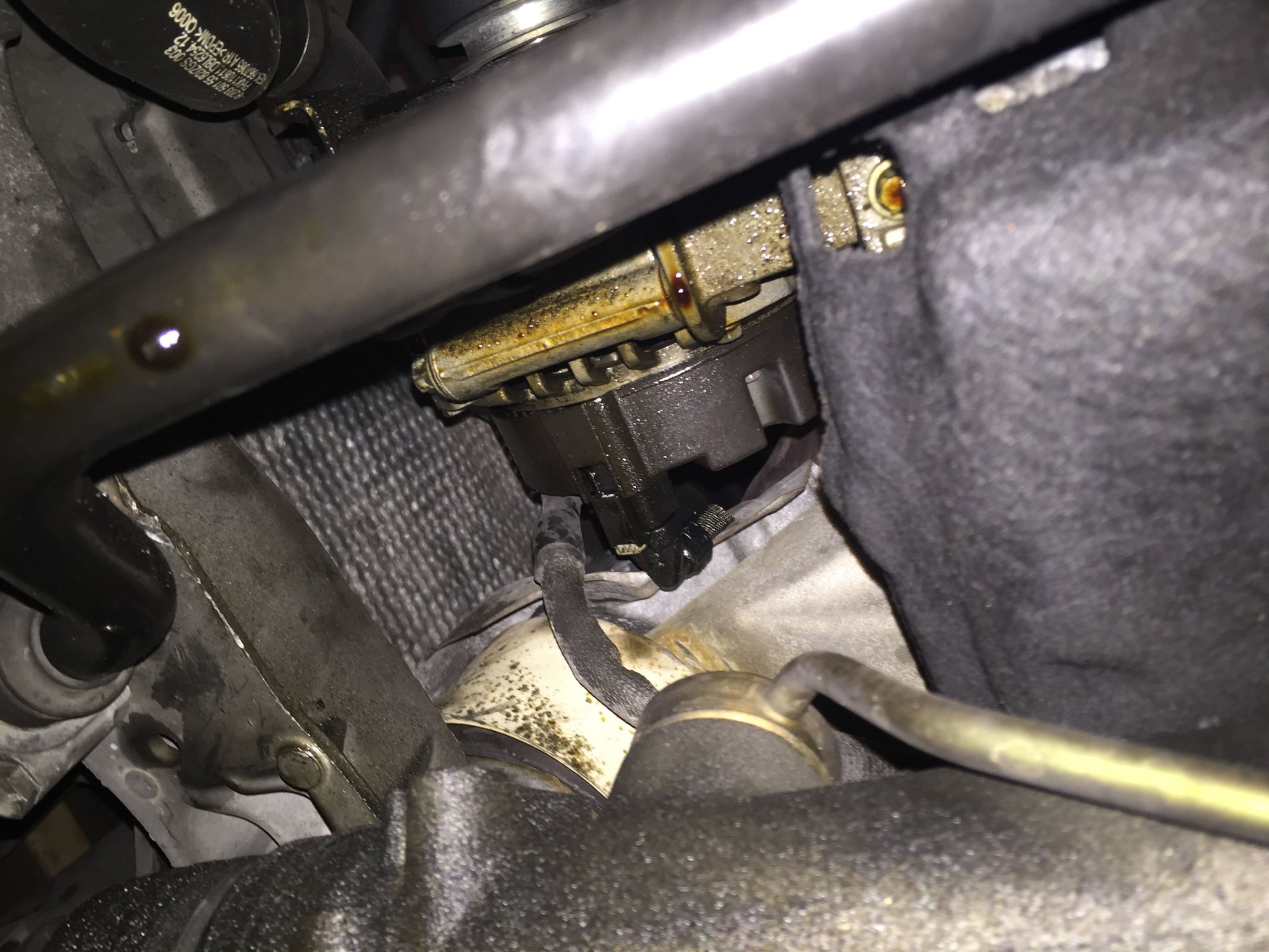

After cleaning up the engine, I can see the source of the leak more clearly. Can someone please confirm this is the oil pan gasket in the picture? If so, it appears to be major work to replace unless I can get away with using a sealant such as Permatex...

I cannot confirm if a sealer would make it but I wouldn't use it, and yes I can confirm that taking the oil pan down is not a minor job. I have the instructions to get it down as I looked for it a few weeks ago as I had to resurface the cylinder head, change gasket, and did a lot of stuff on the upper side of the engine, and on the bottom I saw a leak too that could be the 12$ hose (that I'm replacing because it was spitting oil like nuts) or effectively the oil pan.
By the moment I will finish all the upper stuff I'm working on, and if the leak continues after this then I'm pretty sure the source is around the oil pan, and to take it down there is a bunch of stuff to get out down the car.

Just finished doing a lot of work as well trying to eliminate other sources of leaks (cam magnets, engine wire harness, valve cover gasket, water pump, and power steering pump). I originally thought the oil was coming from the power steering pump seal, but it was probably just the fan blowing the oil from the pan gasket all over the engine bay. I will write this one off as preventive maintenance . Let me know if you do end-up taking down the oil pan. My alternator is getting soaked pretty bad. Do you mind posting or sending the work instructions you have on here? I do have access to a lift, but this may be a little too much heavy work for me...
