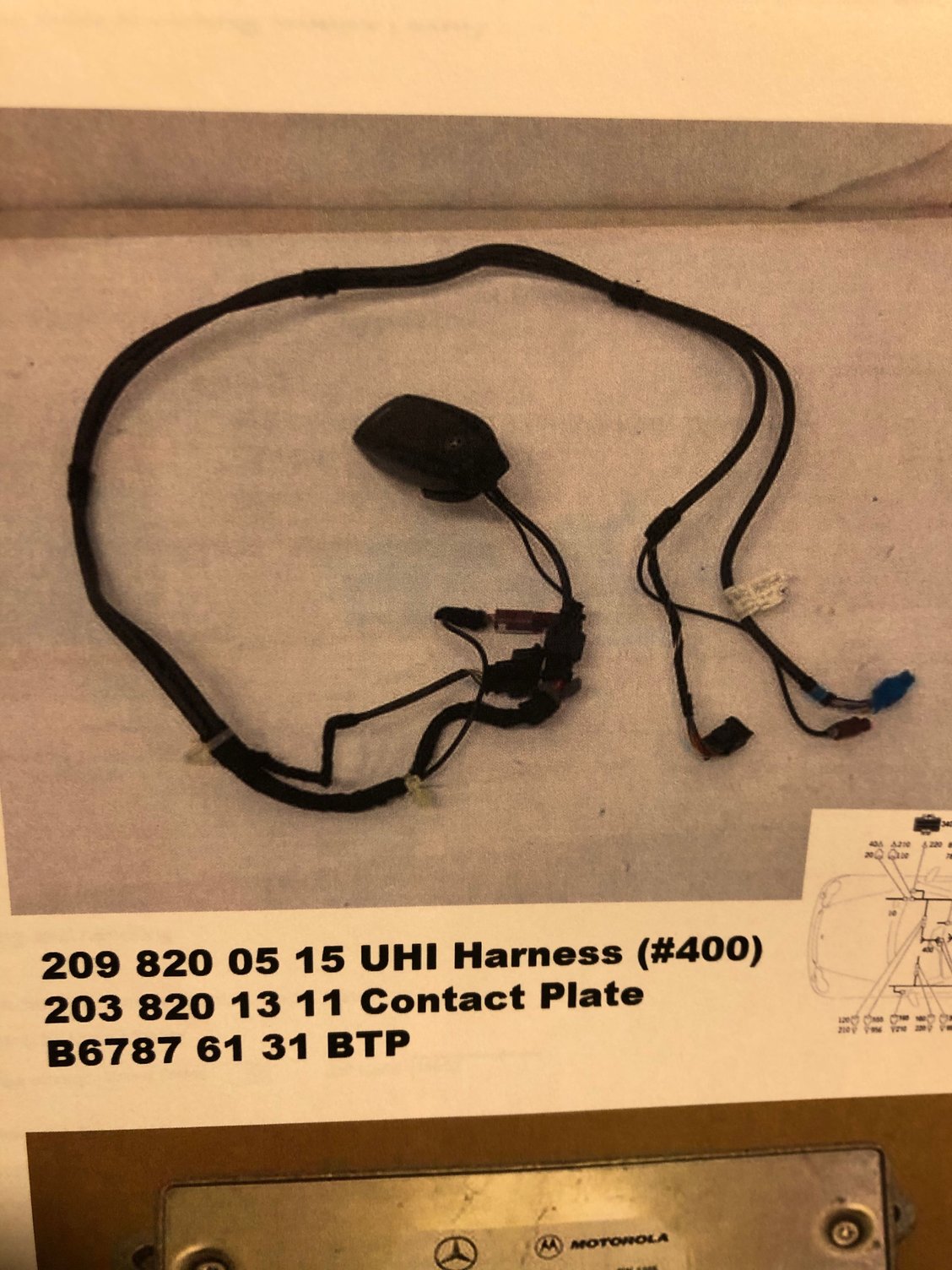

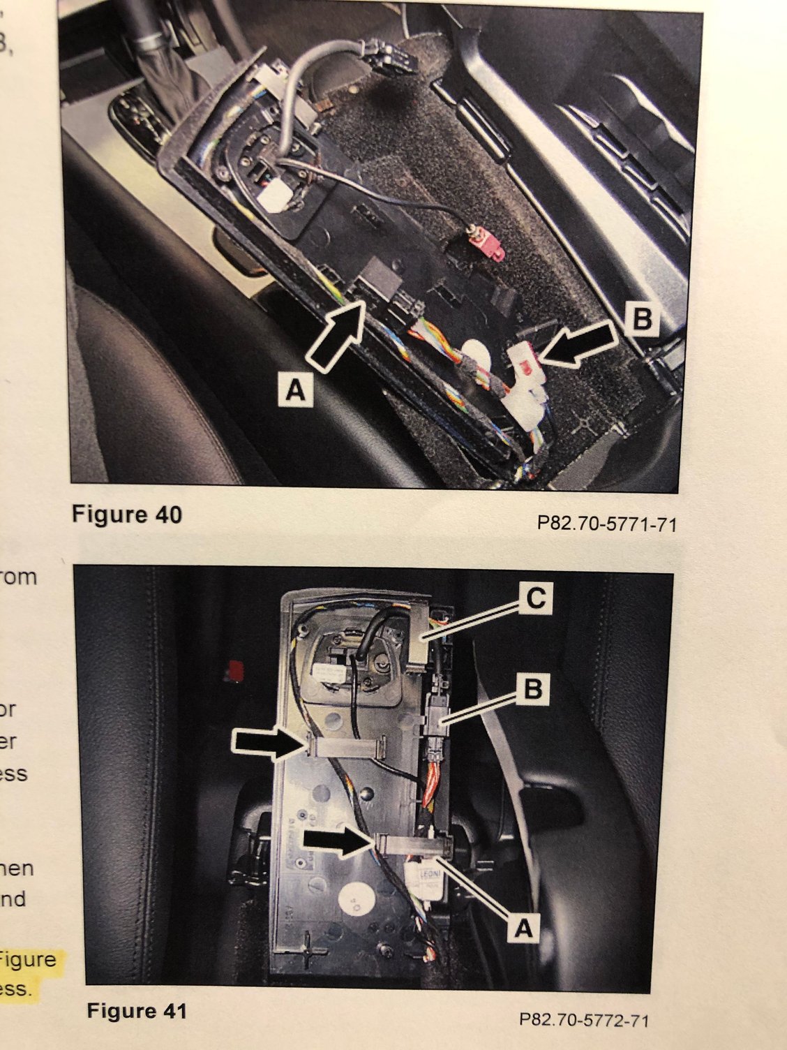

You’ll need a whole “system” that includes a bunch of parts in the trunk...those parts are a little easier to find.
The hen’s tooth will be the connector plate in the console, where you’ll knock out the triangular shape in the floor you’ve pulled up.
Here are some pictures.
Please search the w203 AND the AMGw203 forum, but use a computer, not a phone...the search function is a lot better.
