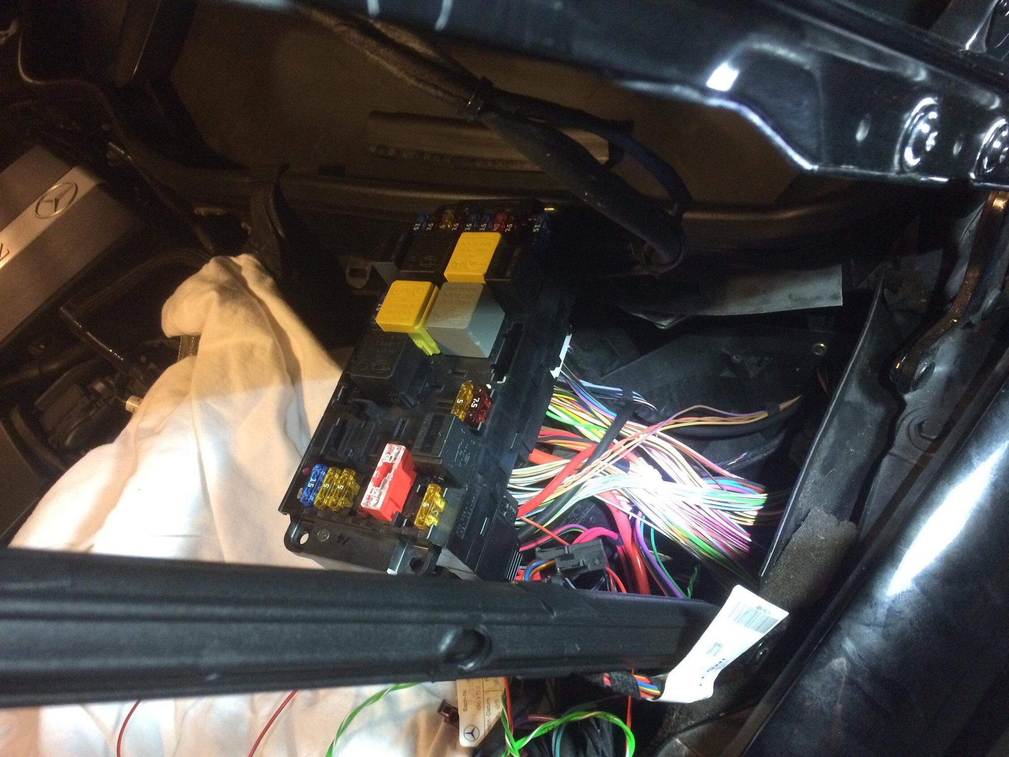

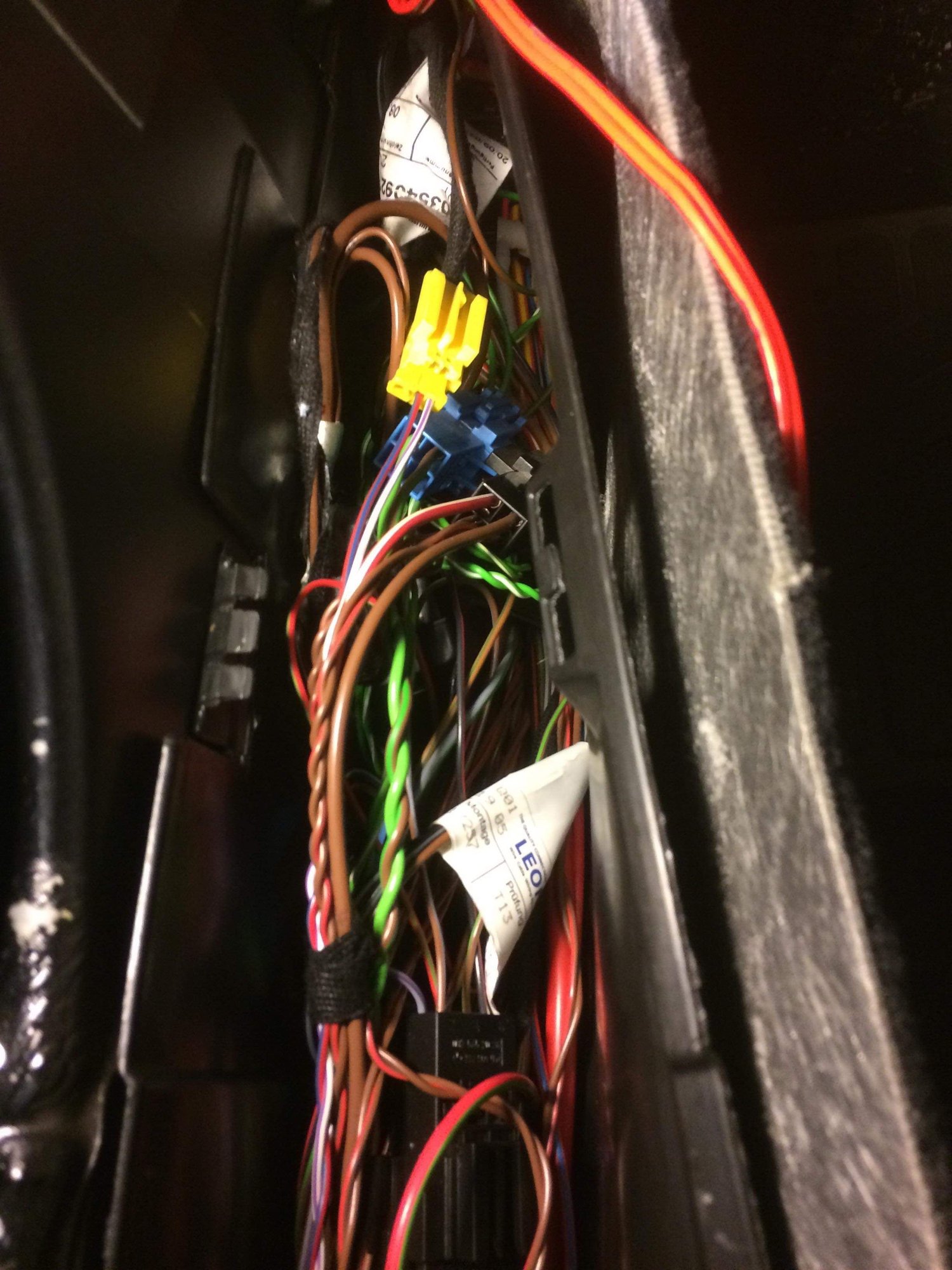

Pull out the inner door jam threshold- and peel back the carpet.
CAN issue might be found with corrosion in there if you have water.
Then get to cowl and find why water is getting in/into from SAM.
Here is a picture of SAM out and the innards of said driver’s threshold...
