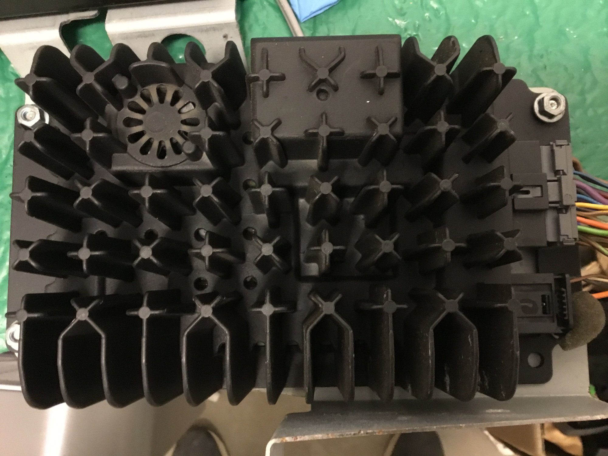

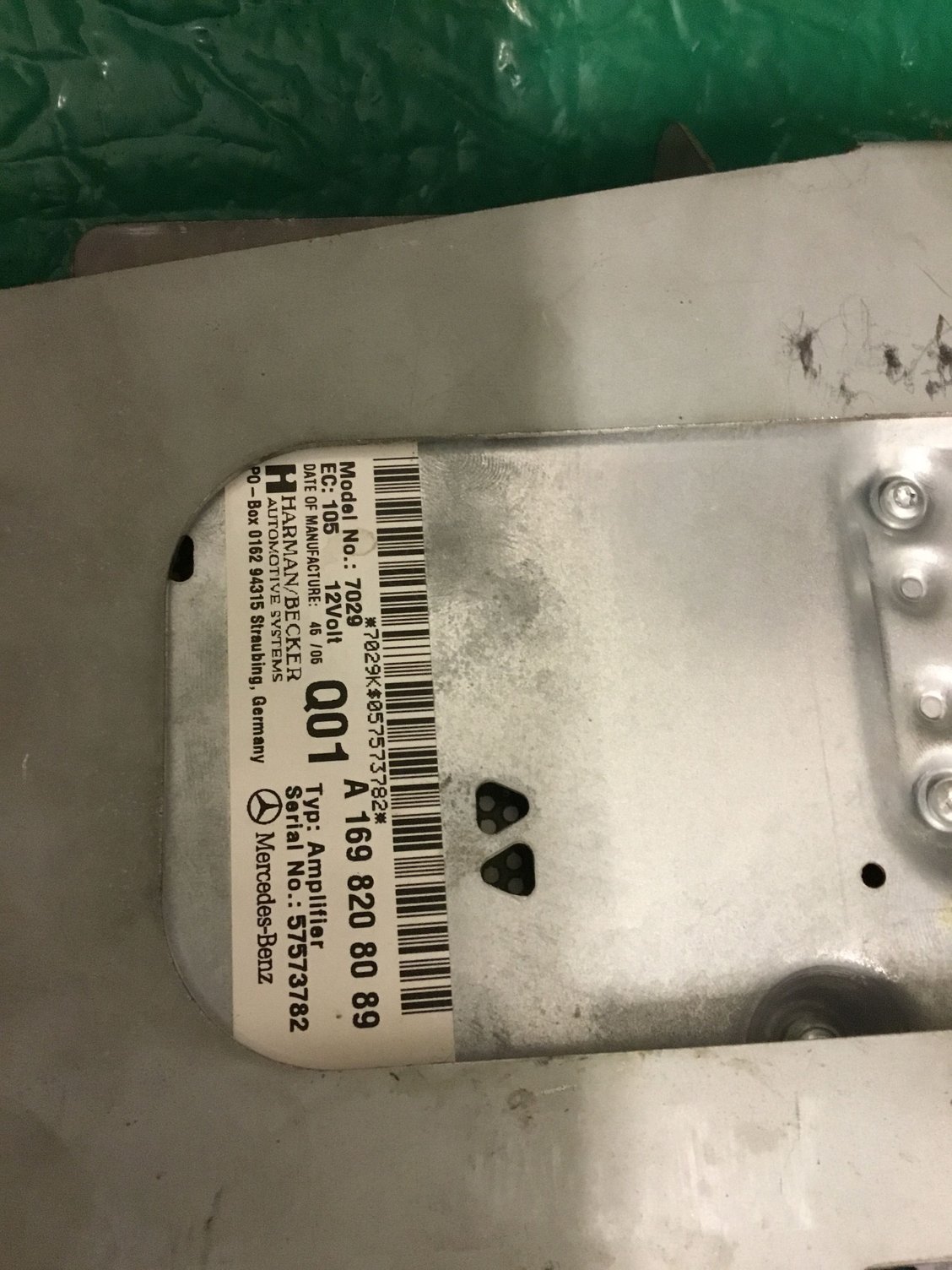

I have attached photos of a Harman Becker amp that I removed from a 2005 sports sedan. Mercedes may have been using BOSE equipment in 2004, and your amp may look different.
Super helpful thanks Kevin!

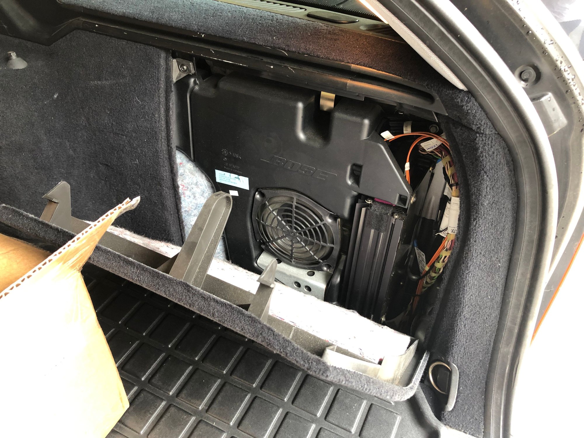

I found the amp location and am trying to figure out how to remove the stock Bose amp which has several connectors and fasteners holding it in....
2004 c240 wagon radio amplifier location right rear panel in trunk area

You'll have to pull the trunk floor and the side panel immediately ahead of the one you already pulled. I'll try to find the instruxtions somewhere on my computer.
The amplifier comes out with the whole plastic woofer box that says Bose on the side. Once out then you can separate the amp from the sub.
On the wagons there's a sefect where the rear window seal leak and drips water on the amplifier. That's how mine failed and a couple more I found in the JY. Rust in the amplifier. See that bundle of wires on top of the amplifier. Unplug that and you'll find corrosion.
