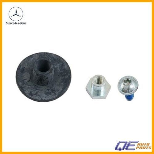

Dear Pacific Man,
I was calling mbz dealers and auto stores to find the following A. white plastic rectangular bracket (photo enclosed), but instead i was told by the dealer that I need to buy the following part number 2037200114, which is a black, round, rubber bracket (photo enclosed). So I just bought the the black round rubber bracket. I hope the Parts Employee at the dealer was right - do you think the rubber bracket could be used instead?
Photos below:
black, round, rubber bracket - part #2037200114

It may well work. When I did the front window I could not get the right part. I Frankensteined a bolt/nut/grommet combo into an expansion post and it still is working fine. It appears that you bought the factory version. When I did the rear window I Was able to get the part, white clip, and that worked as well.

Hey, I used the black round rubber bracket and its workin! So great....thanks for your help!
Old Sep 17, 2019 | 08:17 PM
johnhef's Avatar
Joined: Feb 2010
Posts: 263
From: Frederick MD
83 500SEC, 87 300D, 02 C32(x2), 02 C320T (x2), 03 C320T4, 03 C320T, 03 E55, 05 E320CDI, 06 E320CDI
The black rubber piece is the updated part.
