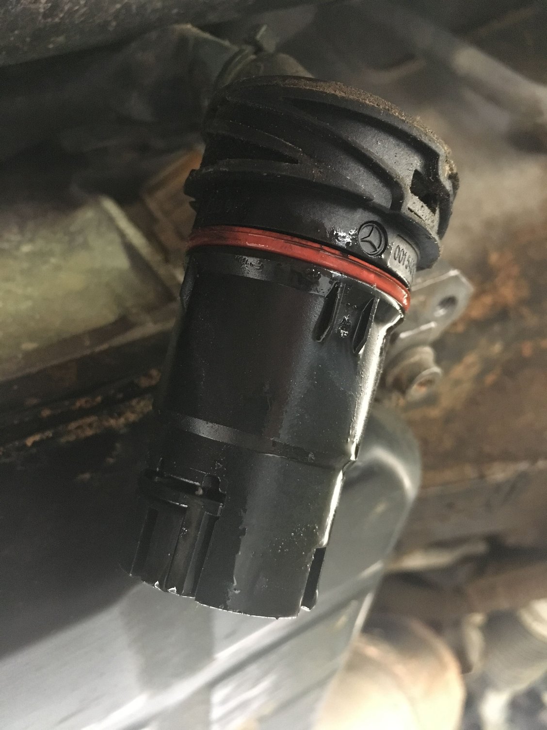

I have pulled out the pilot bushing and checked it and the plug had a little film of oil on it so I ordered a new one. The new one somehow fit into the transmission fine but it wouldn't accept the plug. I couldn't get the plug to go all the way into the pilot bushing so I ended up just pulling the o rings off the new one and placing them on the old one and reinstalling the old one back. I also pulled the carpet on the passenger side floorboard and pulled back the metal plate and checked the TCU and there isn't any type of oil or water damage on the unit. It looks practically brand new.
Here is how the pilot bushing looked when I pulled it out.

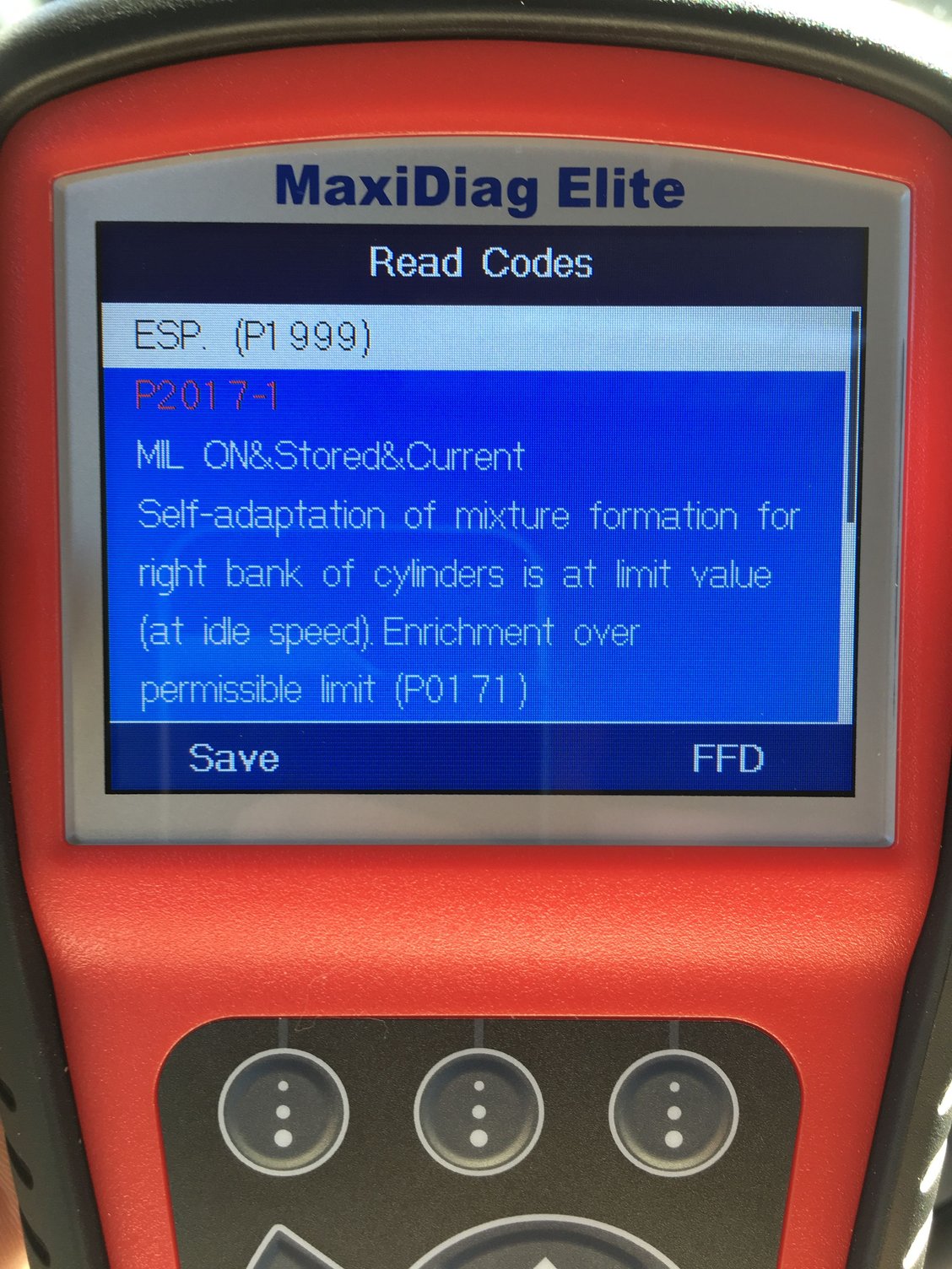

I've run many different full scans on the car with an Autel MD808 Elite scanner and it never gives any type of transmission codes. The only codes that ever show up are under the motor as stored codes. Normally a p0400 which is more than likely the EGR valve and then these two have showed up recently.
