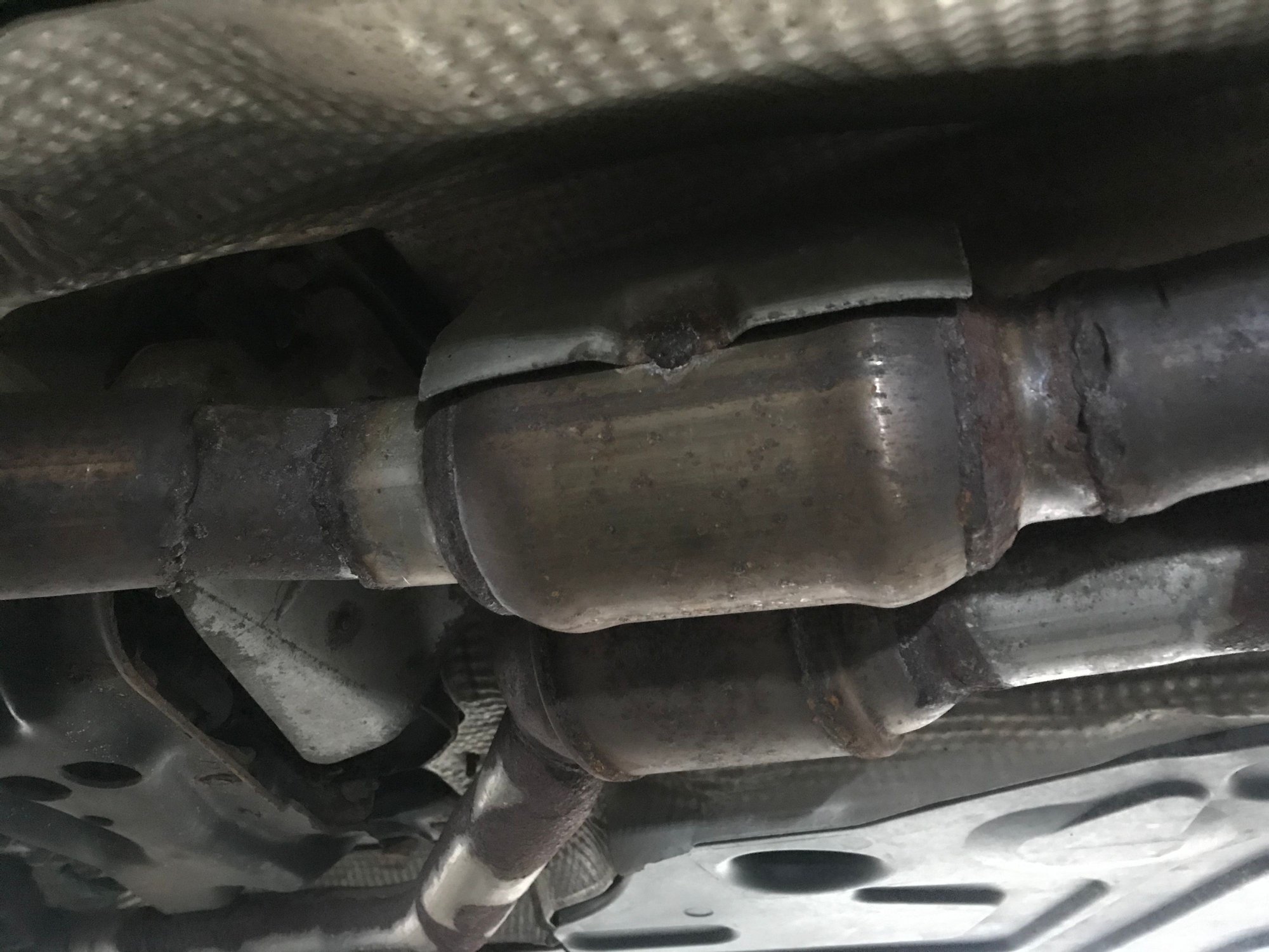

I did some more looking . It looks like there was allot of MICKEY Mouse patching on the exhaust.
The drives side rear CAT shows welding the Passenger side rear into the rear V I call it where the left and right join and welding ,
The rear 3 bolt bracket seem terrible ( aka don't touch it ) bracket for the rear where the V pipes join the muffler.
So I guess my plan is to buy the driver side pipe that comes with the V I call it , then cut the V off and custom weld or coupling. .

New update so I took a saws all to my exhaust I cut right in the middle of the vehicle I remove the section that goes from the engine pipe to the middle of the car remember there are two catalytic converter‘s. When I removed it out of the vehicle I blew into it and clearly I was not able to I ran hot water through it and now I can blow right through it. So basically my misfiring codes were because they were slightly clogged. I’m going to reinstall it now with a coupling adapter since I cut the pipe. What upsets me is why did my mechanic who is pretty reputable not do this or suggests he was ready to charge me $1700 when I actually all we have to do is cut the intermediate pipe in the middle soak it overnight reinstall weld and be done

So I can back home to do one more test cause I was not 100 % convinced it was the front CAT. After I cut the drives pipe in half and removed fron cat I put a air hose to make sure I had flow from the middle of the car where I cut the intermediate pipe back and guess what!. Debris was popping and there was not flow out the back muffler. This tell me it is the rear cat is the clog. I have attached a picture and it shows some one had bee here before..NOW WHAT
I understand the federal laws, RED Gray. I just mad my machinic charged me 240.00 to tell me I need 1700 in work. When really I just need a rear CAT welded in. that's all. REDGRAY thanks for you other post I appreciate the help.
