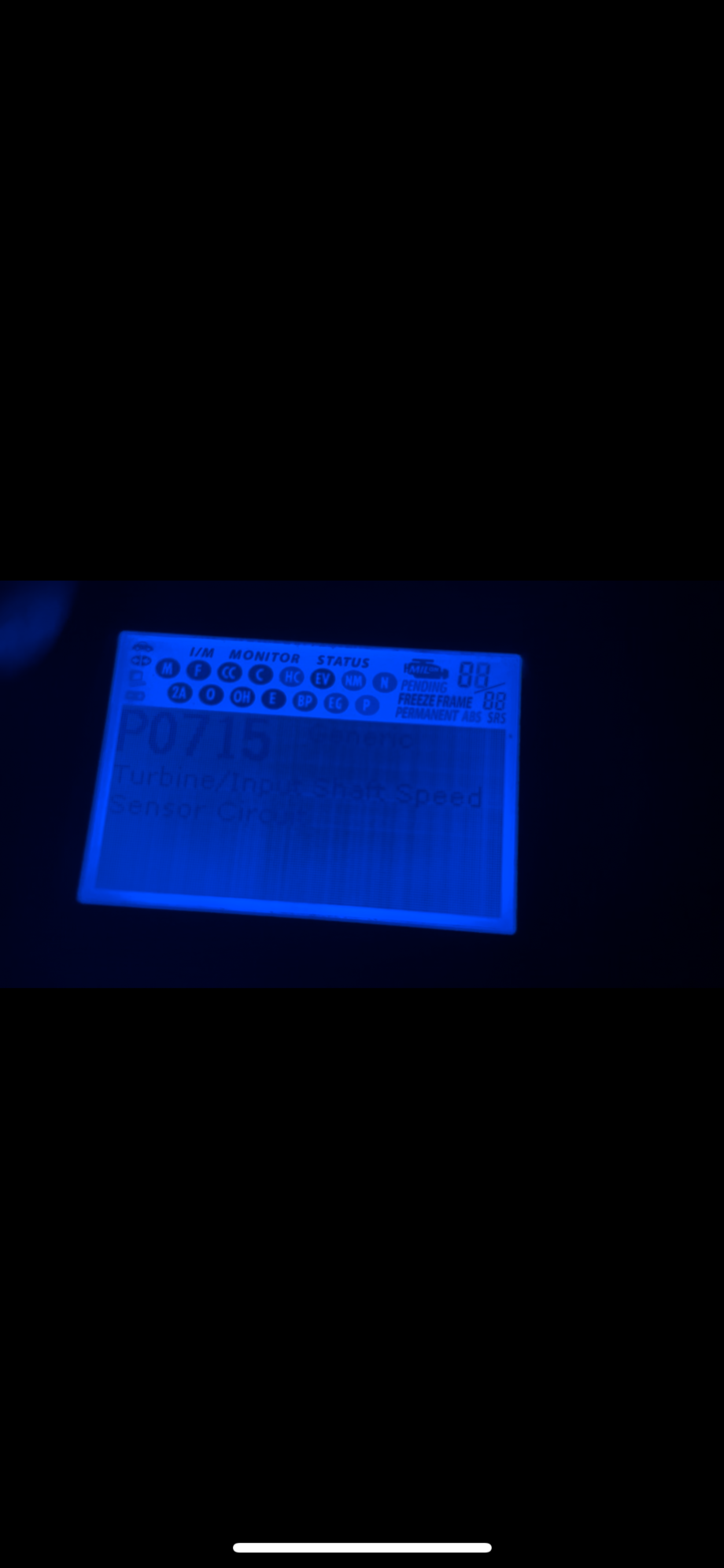

will this budget code reader help with with my code p0715 ? I just dropped in my rebuilt m113 engine also changed my throttle position sensor . Before I went on any test drives after getting the motor back in I let her idle for a few hours shutting it down every half hour 45 minutes & checking for leaks of any kind , also the fluid/oil levels making sure there was no funny business going or no codes !, the engine sounds healthy so I went for a drive . All seemed well on the first test drive. I was able to drive it for almost 20 miles around my city doing regular driving then on the way back home it went into limp mode & gave me a check engine light & I had my cheap code reader plugged in the whole test drive so it also gave me a single p0715 code simultaneously . I checked the 13pin plug & it only had a few drops oil on it I’ve seen worse on cars that have no transmission issues but hey I cleaned it off , let it dry plugged it back in . Nothing happened still same code ( can’t erase it ) . next thing I’m going to do it check the TCU but I doubt it’s got oil in it because my plug was so clean even right at the transmission, you never know till you know ! . So my problem is I need a better code reader that can specifically help with this p0715 & not go over my budget .
