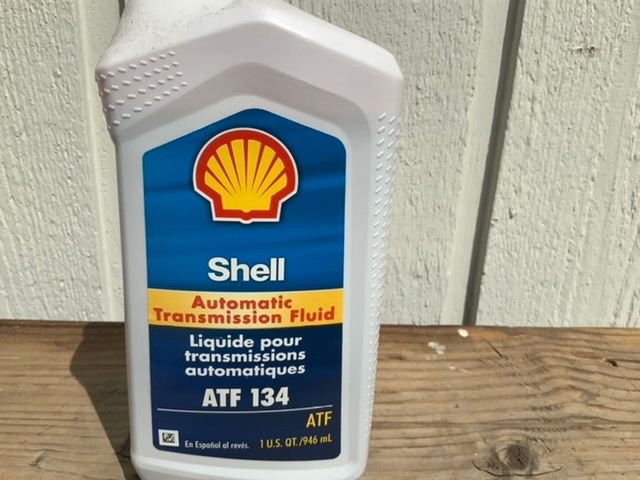

This is what I use:
$24/case of 6 qts from an oil distributor.
I’ve also used Valvoline Maxlife Multi.
Fine print on the Shell 134:

I also have a w204 with the 7 speed but I used the Shell 134 in my daughter’s 2005 C240 4Matic with the722.6.
My understanding is each time they brought out a new spec, it was compatible with the earlier version. The shell label specifically mentions compatibility with .12, I assume same for .10 spec.
i used the Valvoline MaxLife in the 2003 C230. Two changes now, about 80k miles (140k total)
