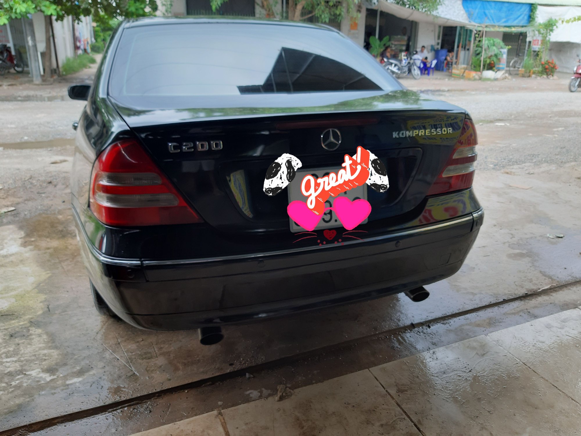

Welcome! Please post a photo of the C200K. You might try posting the question in the W203 section, helpful owners will see it.

EATON 307170 Supercharger
W203042 c200K, Engine A271
W203042 c200K, Engine A271[/QUOTE]
