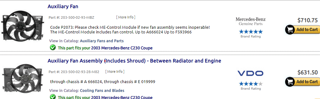

Well this in interesting. Here's a page from Pelican Parts. Notice any difference? EPC has two listings, both of which say "up to A666024", both under part number A 203 500 02 93. No other notes. So, before you order a fan, note which side the electrical plug is on your car. Autohausaz and FCP Euro only show the one with the connection on the right side.
