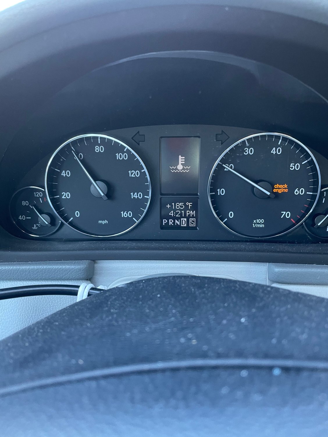

What does this mean
I had coolant one pop up while coolant was low and this is different obviously it’s a temp thing but my temperature is normal so not sure what it means help tia

I would check your owners manual I think that comes on when either car is overheating or has a fan issue. As temp looks okay I would check fans and for codes.
Do you know why your check engine light is on?
Edit: Just pulled up the manual for your car check page 346-347.
If it has just that picture and nothing else the car is saying you have an issue with your fan.

Check engine evap stuff
The fans work and temp don’t is normal I was getting low coolant but filled it up and was ok
actually bought new cap and now this so I bought the old cap maybe that has something to do with it

I'm thinking your ambient temperature sensor has failed or come loose. Check the connection. It's in the front bumper. Not sure where it is exactly for a facelifted model but for pre-facelift the sensor is in the lower R side of the car next to the fog light.
As for the CEL, what does a code reader say?

on the facelift it's on the same side Right passenger on the bottom next to fog lights.
You should provide the check engine codes it could be a faulty sensor you don't want to just start guessing... and always try to use OEM or OE parts from my experience anything else has given me issues.
