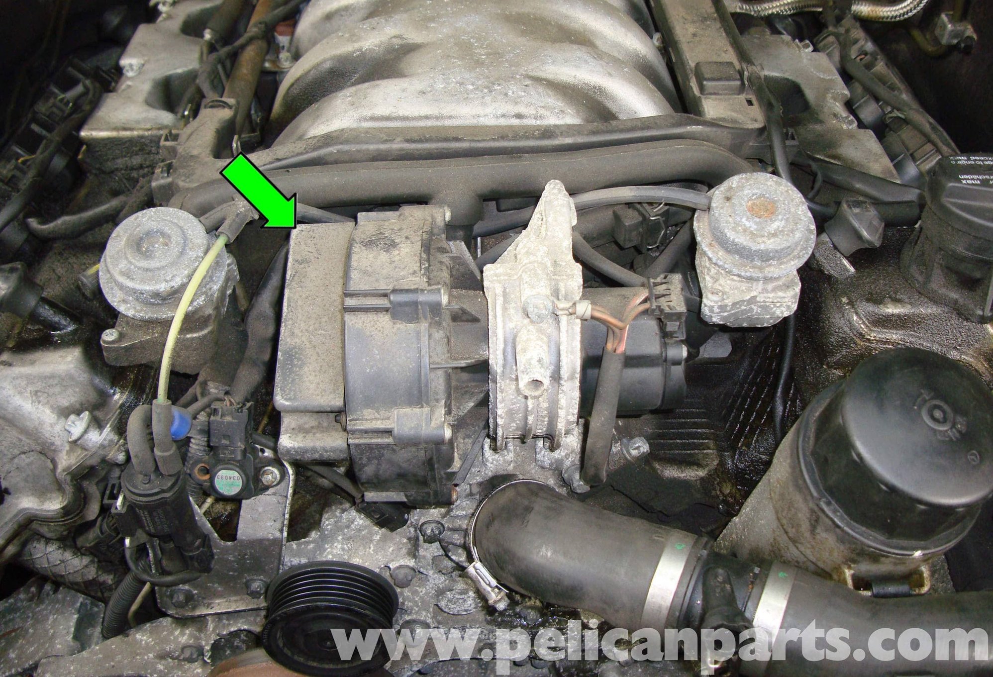

Are you sure its not the Secondary Air Pump?

Where would I find this. If it is operated by the serpentine belt it won't be that as I have had the belt off and noise still persists.
I found it . But I have no engine check light or any warning lights. I will put a stethoscope on it today when I get time.

Its not operated by the belt. Its under the air filter in the top front of the V. Here´s a picture.
