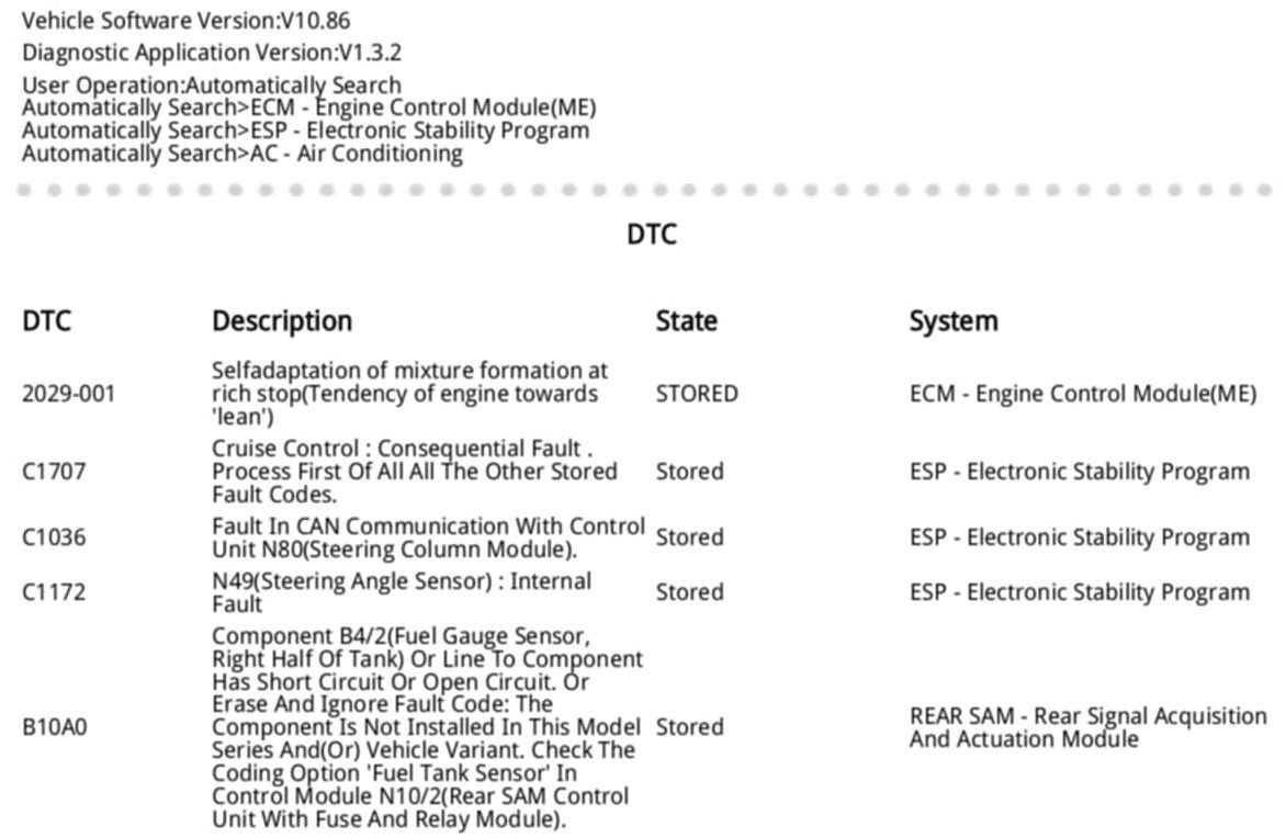

Good day folks wonder if anyone has a view on this issue!
The car is a 2005 C160 Coupe auto with 109000 miles on it and have been semi recovered by a local firm after the engine just died doing around 60mph.It wouldn't restart but after the recovery guy towed me about 500 ft to a safer location, I tried it again and it started. Drove it about 15 miles home with no problem. My mind starts remembering a similar thing happening a couple of months ago when it also cut out around 3 miles after the fuel reserve light came on which I thought rather strange as usually you can drive a lot further than 3 miles before you run out of fuel! Anyhow, on this occasion I poured 5 litre's in the tank & it started up straight away so didn't give it any more thought other than not to trust the reserve light. With both situations of cutting out, I'm wondering if this is a faulty fuel pump?
The car has half a tank of fuel in it and apart from a P2029 code and esp which I'm aware of, there are one other code shown. Voltage when running is between 13.8v & 14.2v.
Any thoughts on this would be really welcome !

I'm about to go with my uneducated gut & order a new sender unit, here's hoping it's the issue!

Some great tips there so thank you! Diagbostic tool is a TOPDON & the C160 is a slightly detuned 1.8 Kompressor
