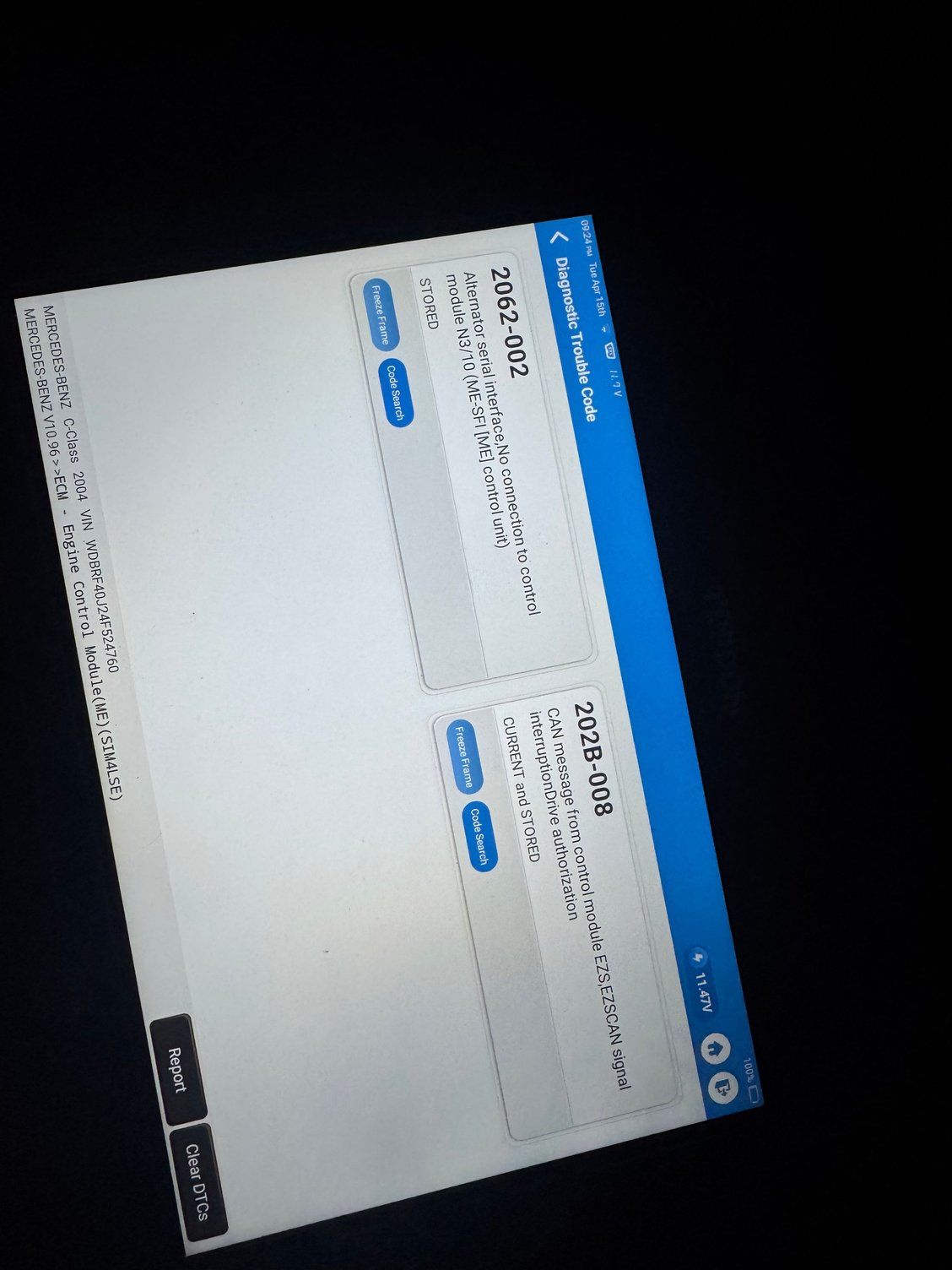

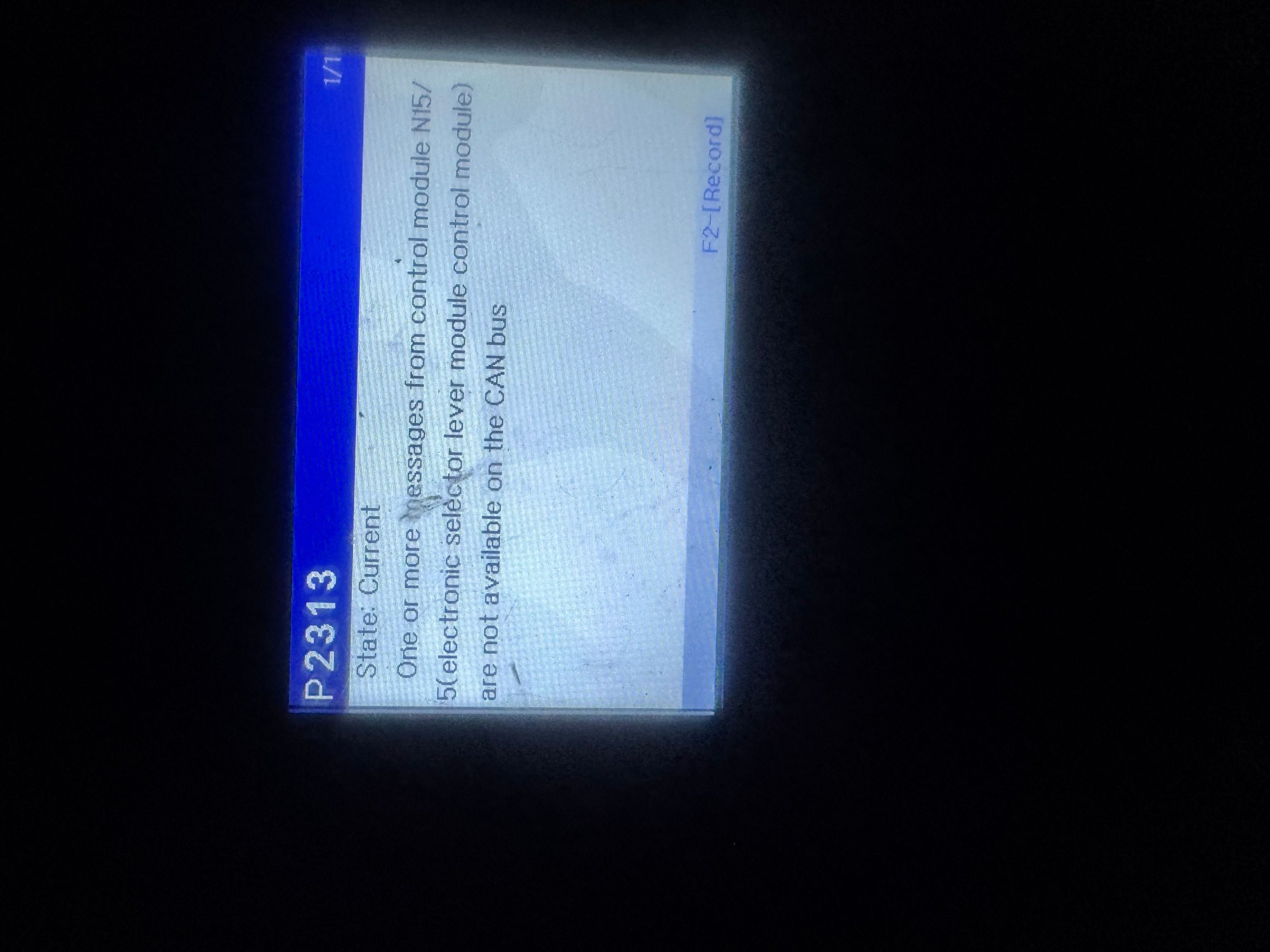

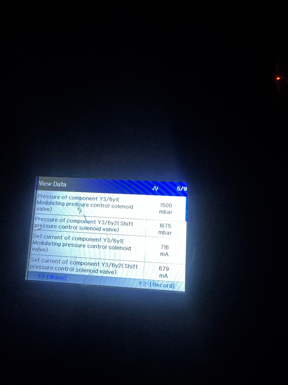

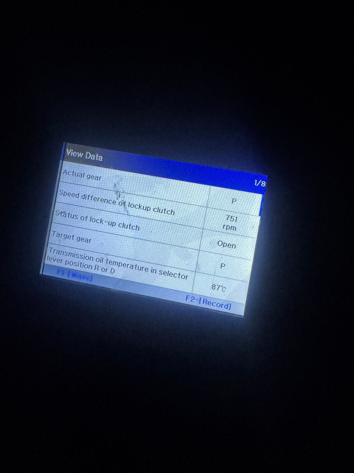

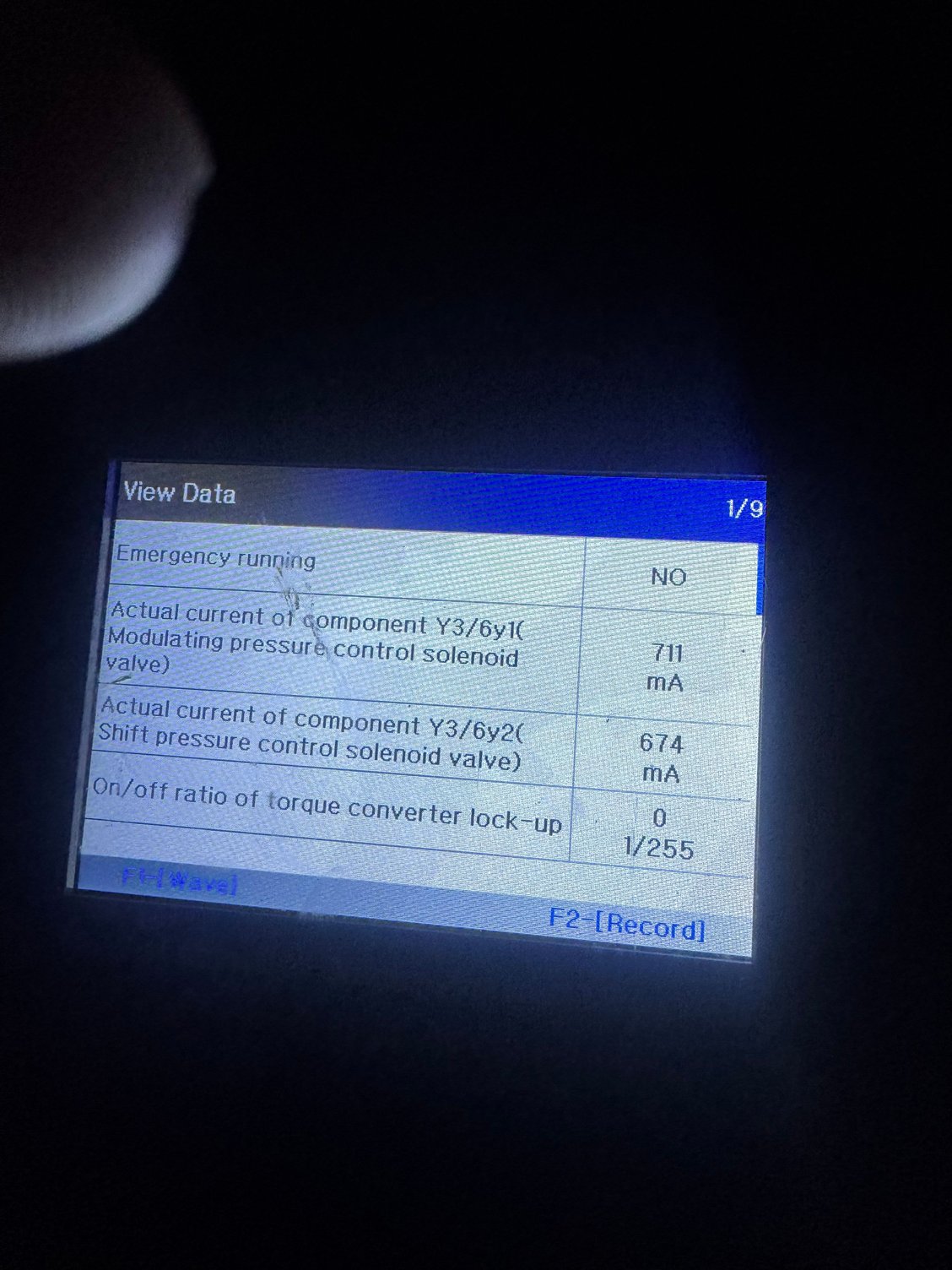

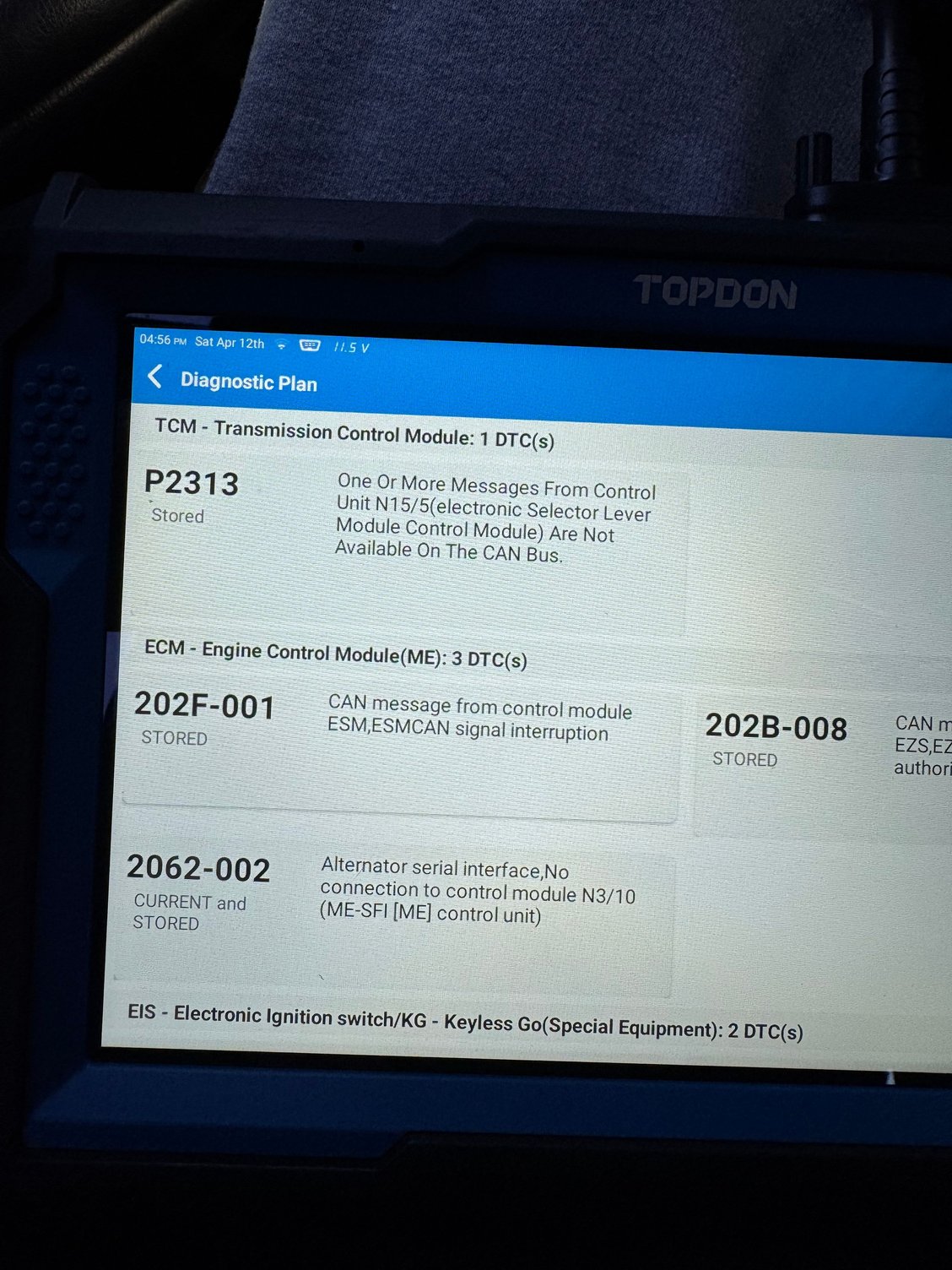

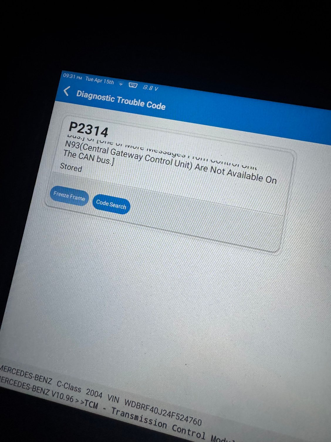

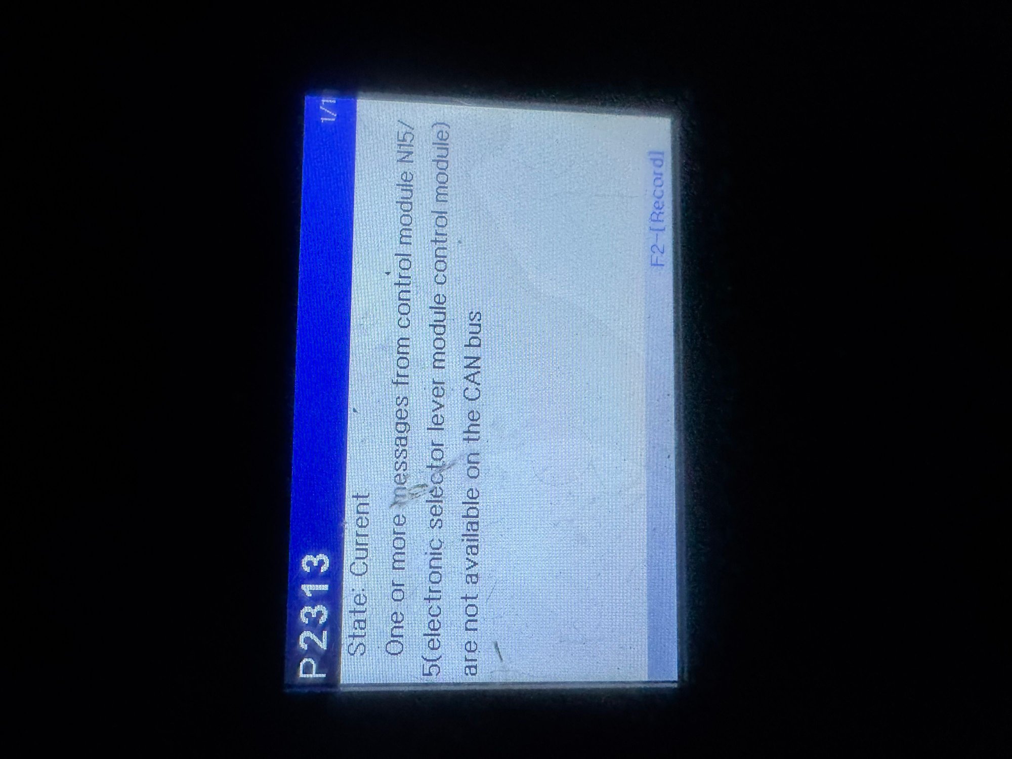

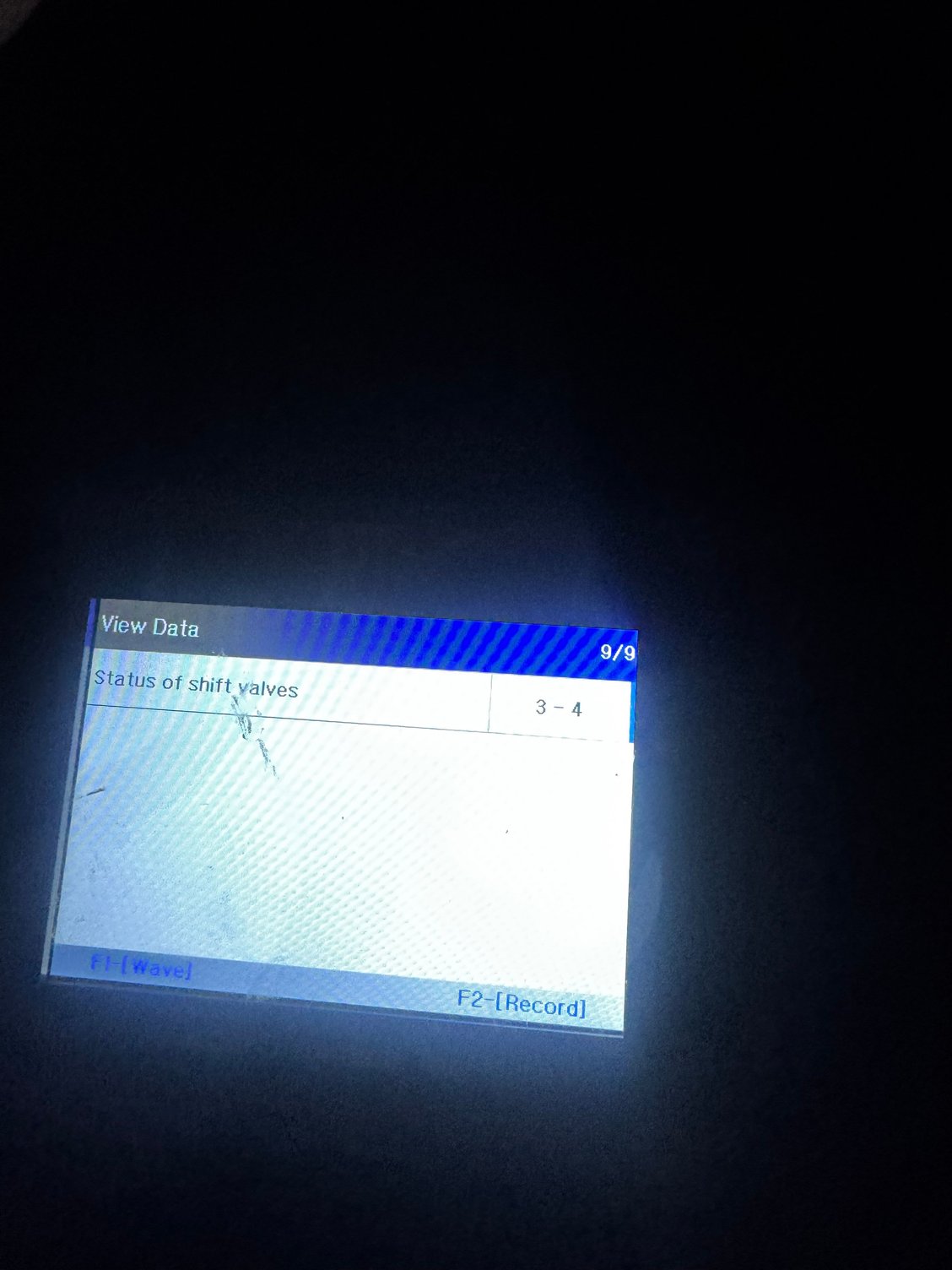

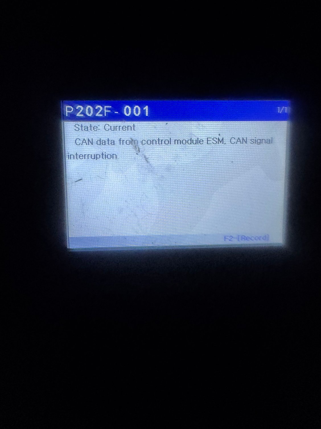

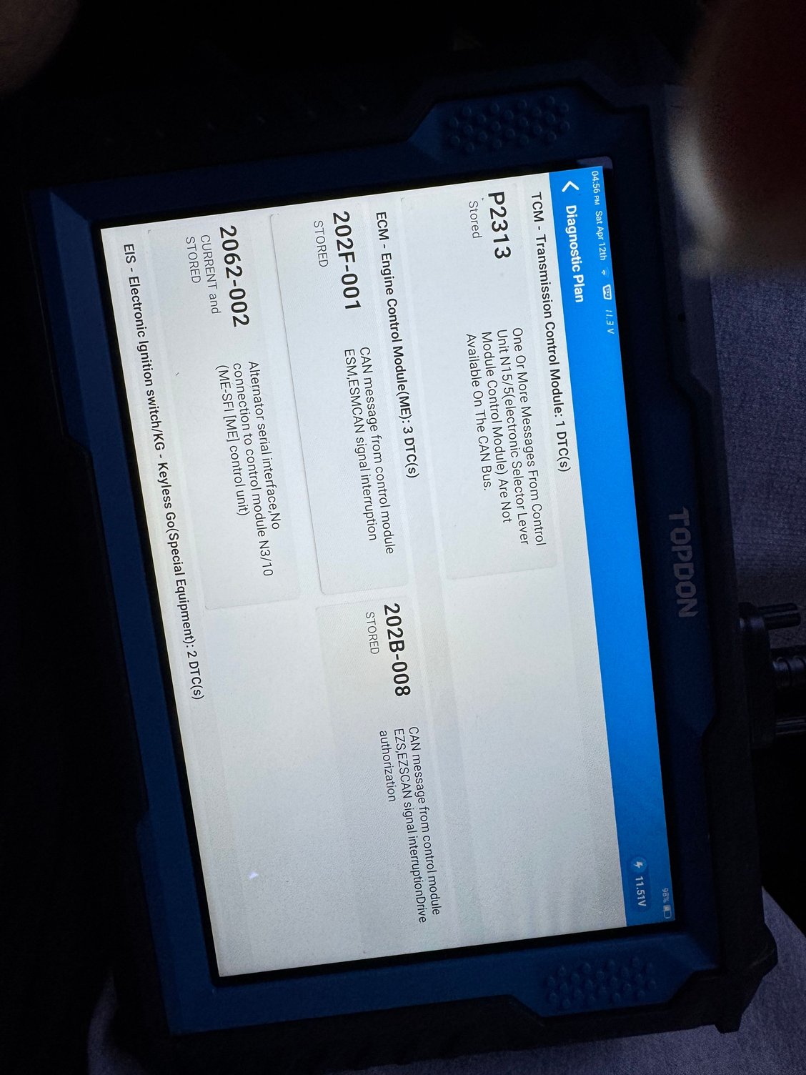

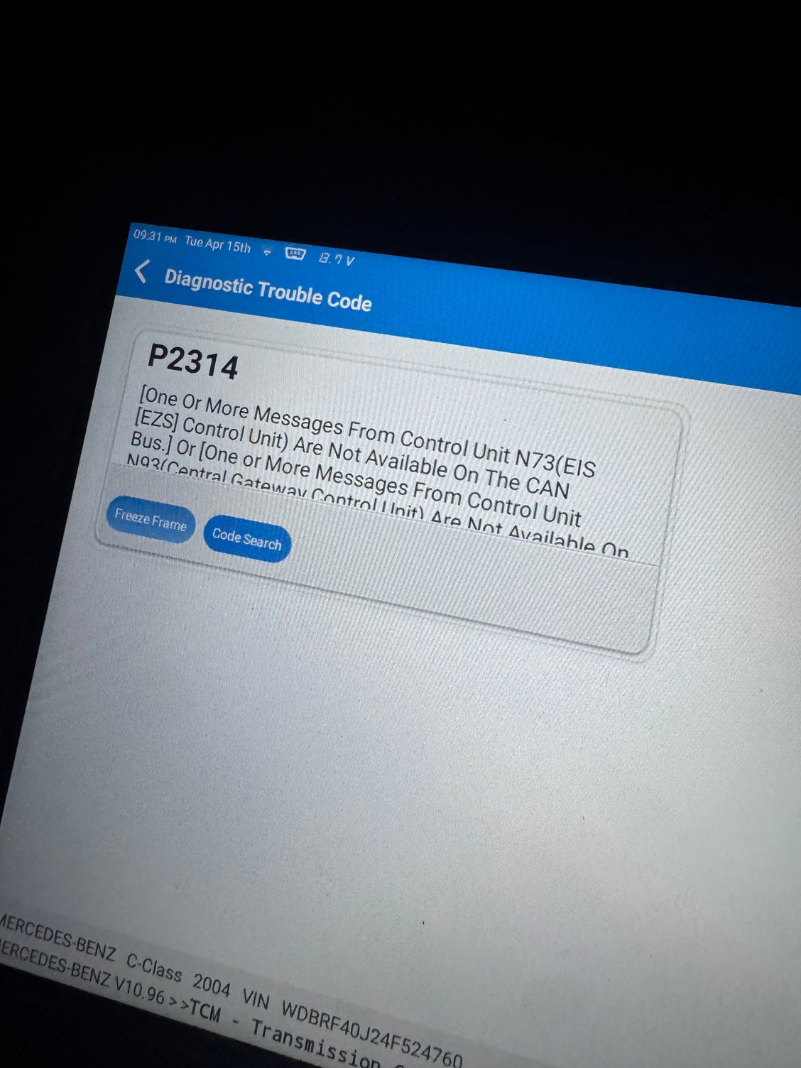

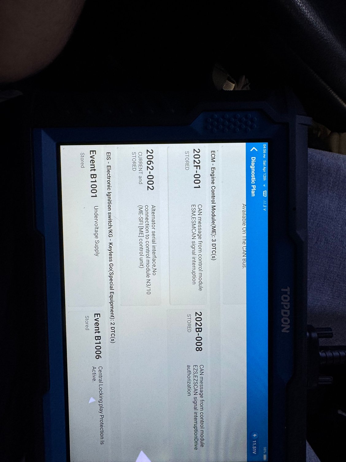

To make it short and to the point 722.6 I can select park reverse neutral drive but as diagnostic tool refers to on park and nuetral my “status of shift valves” are 3-4 and in reverse or drive it says not present . I’ve replaced everything from sonnax shift kit ,solenoids con plate ,connector tested gear lever module but still it believes it’s in 3-4 on park and drive which makes no sense to me as if it believes it’s in 3-4 shouldn’t it be revving high ? Here what comes out on my obd scanners . Also , can data keeps giving random malfunction no connection codes with several different modules , could the faulty can connection be the reason to transmission not knowing what do to ? Also where is the can data bus located , thoughts ?
