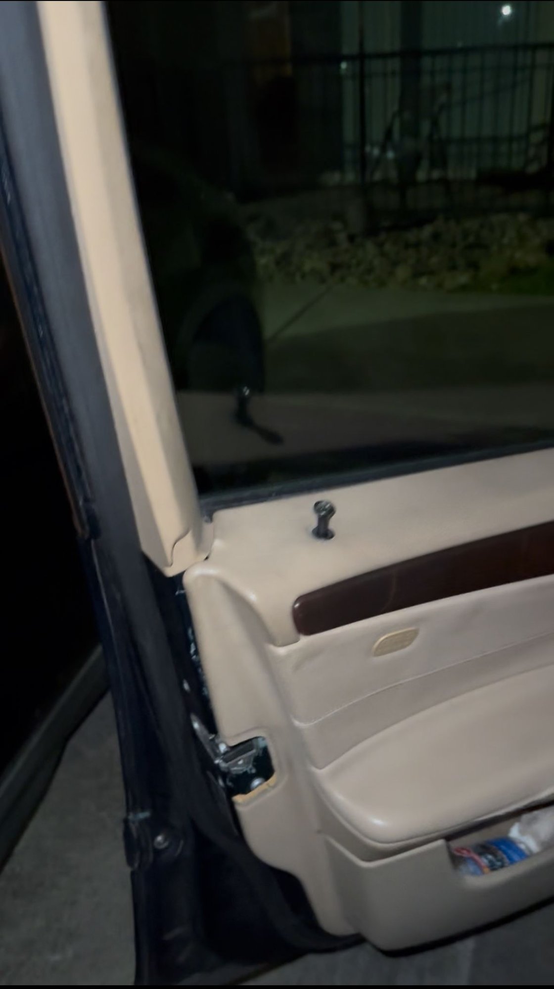

This is the front driver sidr

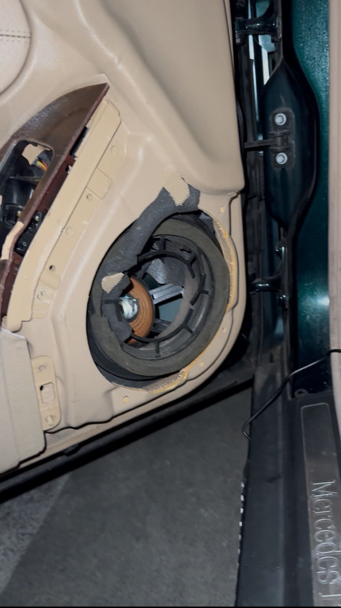

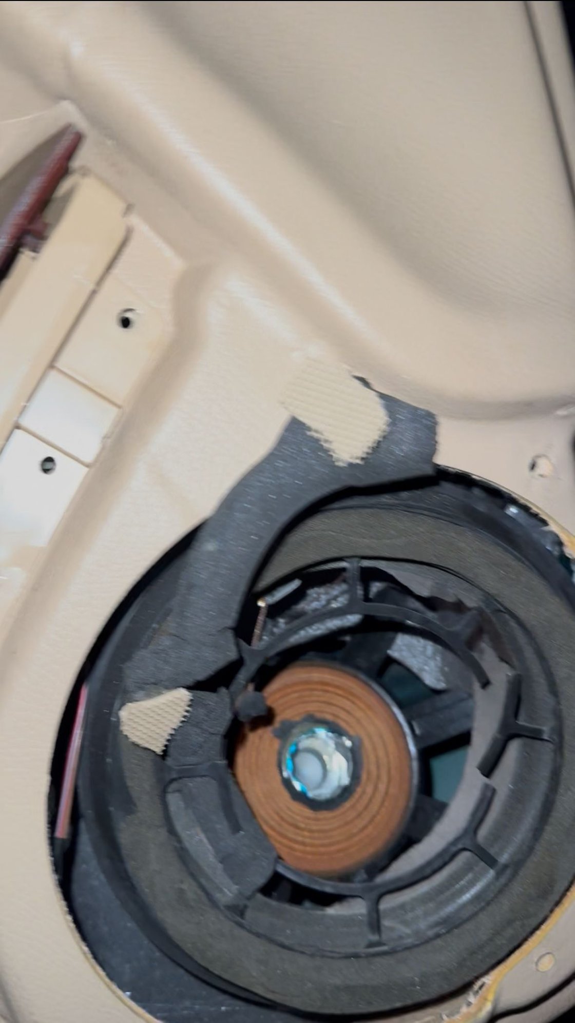

This is the damage to the speaker
Speaker damage
Speaker damage

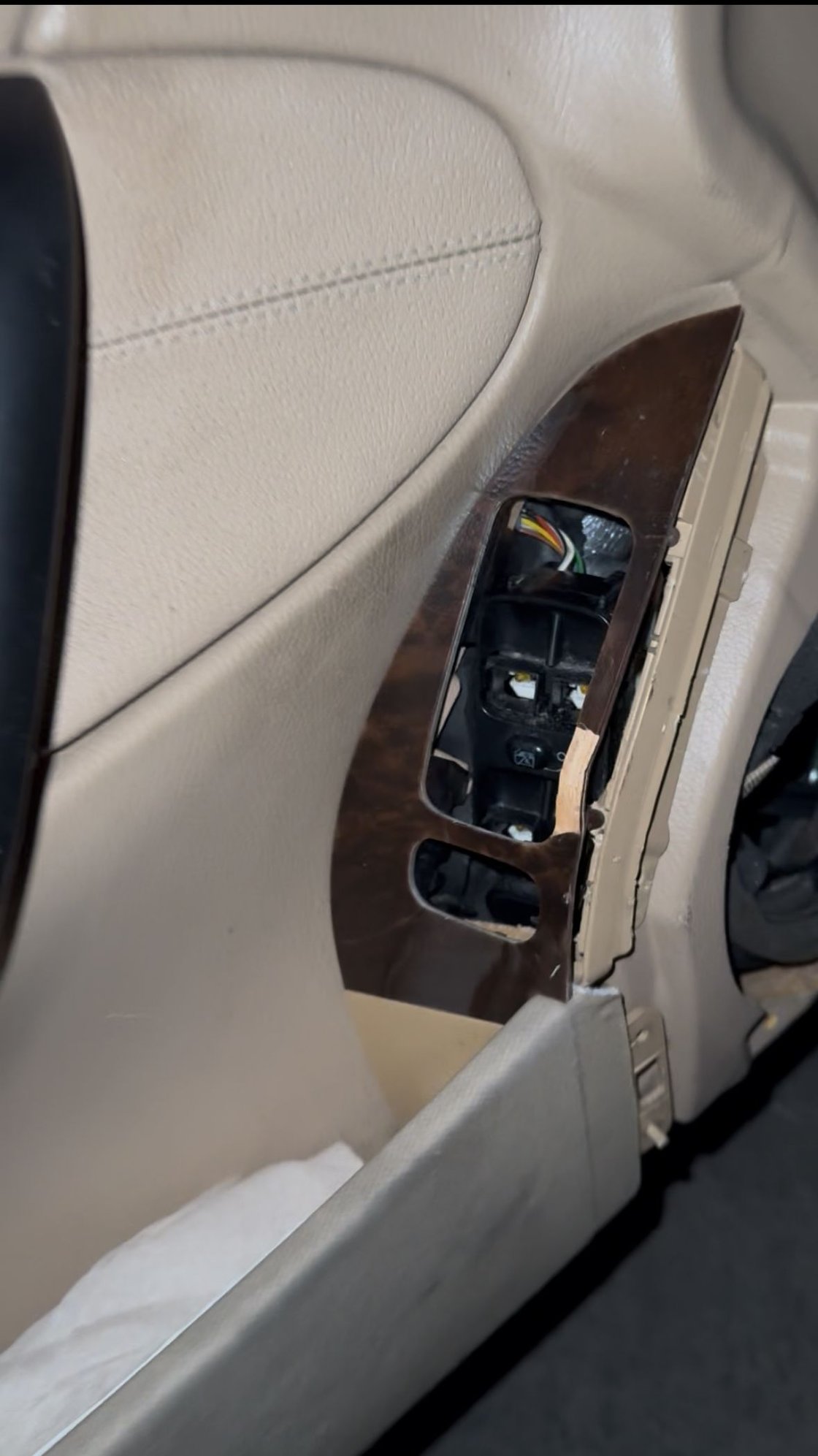

Window button damage

This is the color of the vehicle ignore the cosmetic damage on the outside

Welcome to the world of DIY. Guessing you damaged the wiring (specifically the individual wire that sends the "lock" command).
Based on the photos, you tried to access the wiring the incorrect way. The correct way is to completely remove the interior door panel. The speaker grille and speaker area are accessed from behind the panel. The good news is I imagine the door panel isn't actually damaged, though you'd have to check the tabs that hold the window switches in.
The grille can be purchased separately from the dealership. It is held in place by tabs that are "melted" from the inside. Because of this, they're "one time use". Once you remove the door panel and look at it from the other side, it'll make sense.
There are posts on removing the door trim. You'll need a plastic pry tool (do not use a slot screwdriver!) and a T20 screwdriver. Not sure exactly where the screws are for the sedan, but on a coupe door there is a screw a) behind the SRS logo (the thing just pulls out), and b) beneath the arm rest (look for a circular cover).
From there, I would poke around and look for damaged wiring.
The speaker can also be replaced (I'd recommend something from a local wrecker), assuming the mounting hardware isn't broken.
The one big thing to remember for any repair job is that the entire car was assembled in a certain order/member. To properly access a part without damaging anything, one has to disassemble the car in the "same" but reversed order. In this case, the speaker and lock switches were attached to the door trim, then the wiring connected to the other door modules (hidden near the interior door latch handle).

If memory serves, there are 2 torx under the armrest, 1 behind the SRS logo, and 1 for a "C" shaped trim piece around the door latch. Unscrew your door lock button, pry off the upper speaker grill (carefully!). The window switch uses a cam lock to connect to the wood trim. The wood trim is held in place by 4 torx screws from underneath. The wiring to the switch is also a cam lock. (look for a lever and rotate it). Remove at least one of these so the door "card" (what they call the interior of the door) is free of any wiring. You can now lift straight up on the door card. There are hooks at the top. Next, you will have to disconnect the interior latch cable before everything is free.
The speaker is mounted directly to the metal door once you remove all that. There should be access holes to look at the other interior bits and wiring. Having the window up is most useful to get to these things. Having the window down will be easier to remove the door card.
