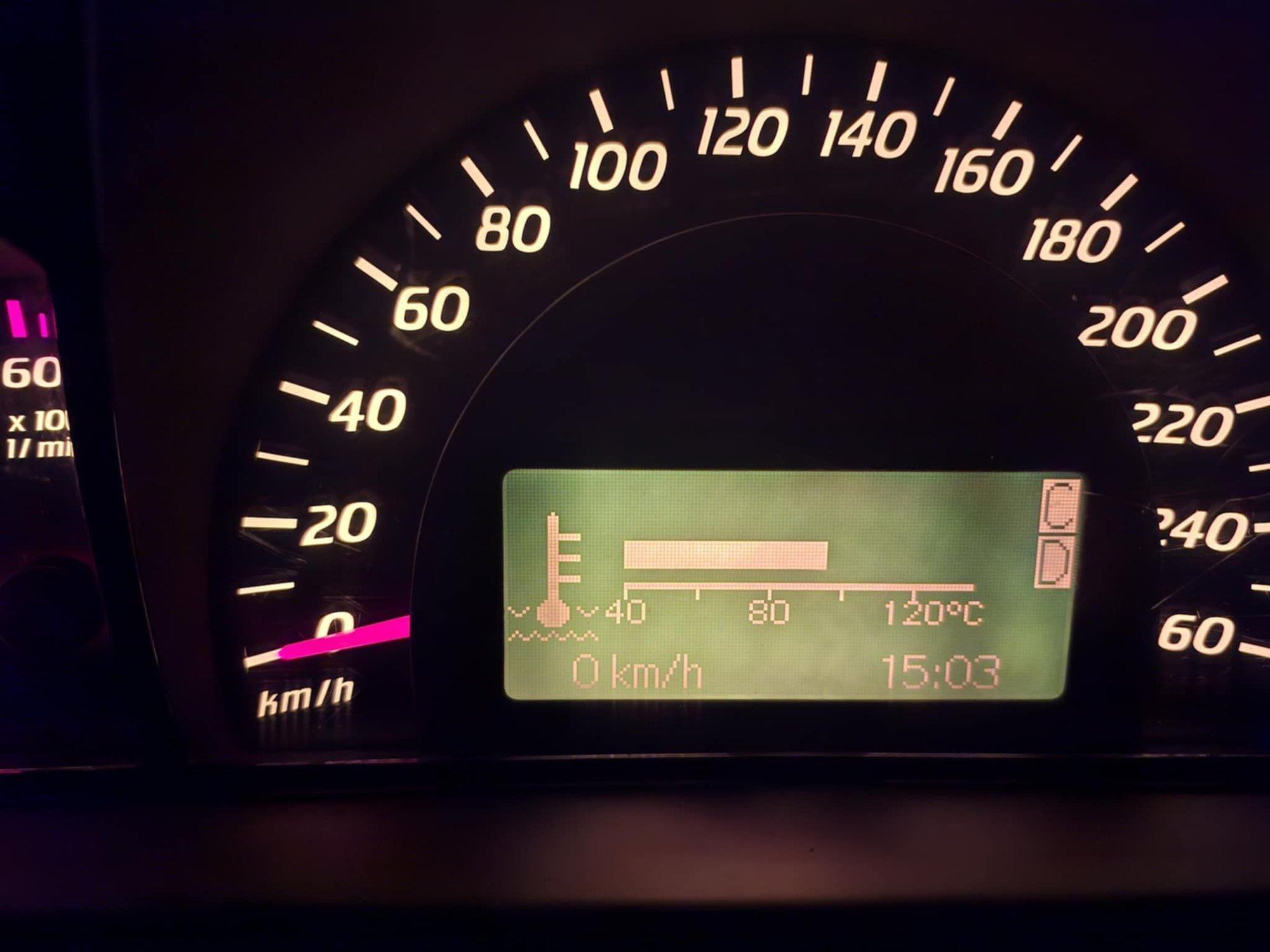

Hi fellow W203 owners.
I'm a new owner to a W203 Sport Coupe C180 kompressor. I'm curious to know how accurate is the temperature readout on the digital display? As I am fixing and testing things out I noticed the temperature gauge move up slightly under hard acceleration.
I am aware coolant temperature fluctuates but I am also aware not all cars reflect it. For example I own both a 2010 C207 E350 and a 2010 W212 E350 4matic both with the M272 engine and when the needle reaches ~95C (which is where it stays) I cannot get it to move no matter how hard I drive them. I'm planning to hand the W203 to my girlfriend as a gift and I'd like to know if I am looking at possible cooling issues before she overheats the engine due to ignorance / neglect.
This is how high it goes and is also the temperature at which the fan kicks in. Under normal driving it sits perfectly at the middle between 80C and 100C.

It's accurate if the coolant is at the correct level. The sensor is attached to the plastic pipe that runs along the R side (facing the direction of the car) of the engine, above the exhaust manifold.
The thermostat is set to open at either 87C or 90C (MB had 2 versions in the past but now only sell the 90C one), which is exactly what you're seeing. When the thermostat fails, the car fails to reach operating temperature (it will run cool) and the car will throw a CEL.

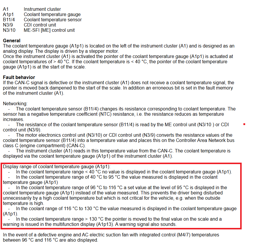

Appears at operating temp it stays the same. Probably similar to the 207. Seems similar to my W204.
This is from a 2005 W203 manual. https://charm.li/Mercedes%20Benz/200...2C%20Function/

That explains what I have seen after replacing the radiator. Temp was higher measured with a probe than in the display. Everybody is lying to you these days.

Thatsgood to know and in general it applies to all new-ish vehicles.
