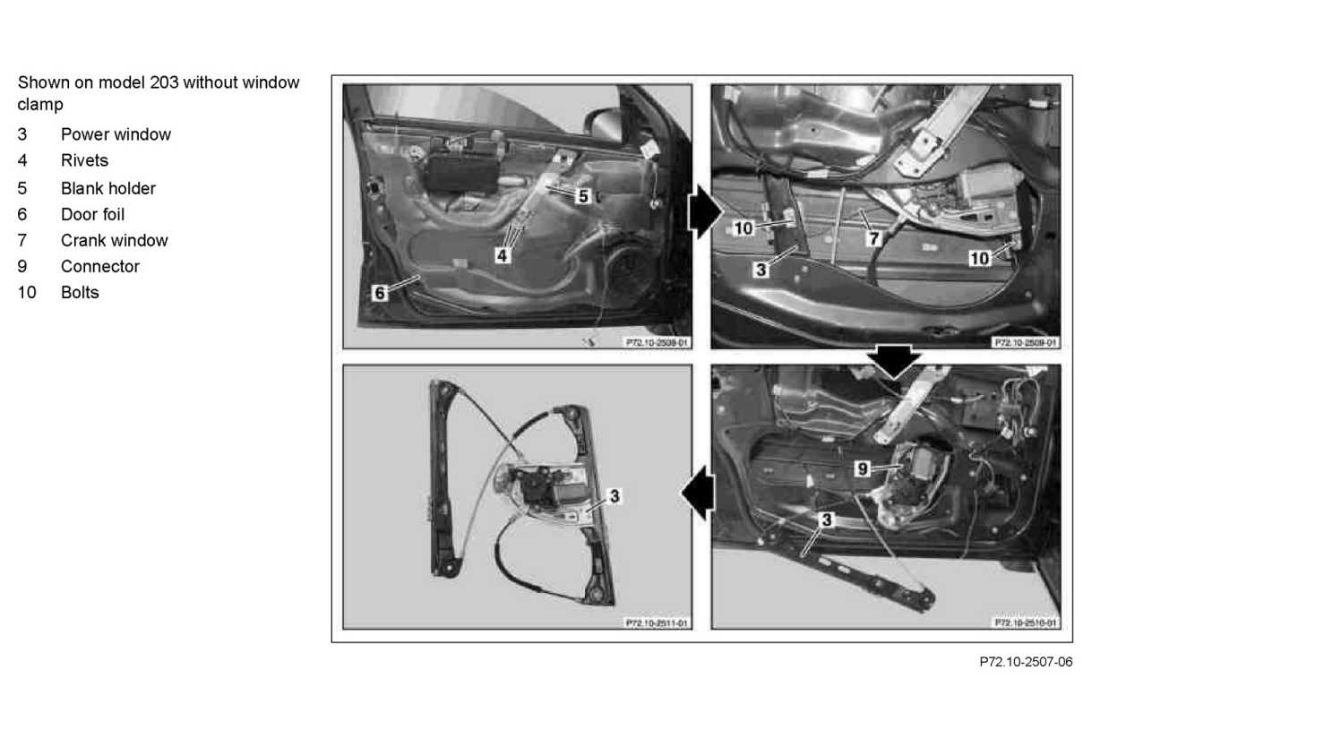

Remove the door panel and have a look.
Can find repair instructions in this link under Windows and Glass: https://charm.li/Mercedes%20Benz/200...d%20Diagnosis/
