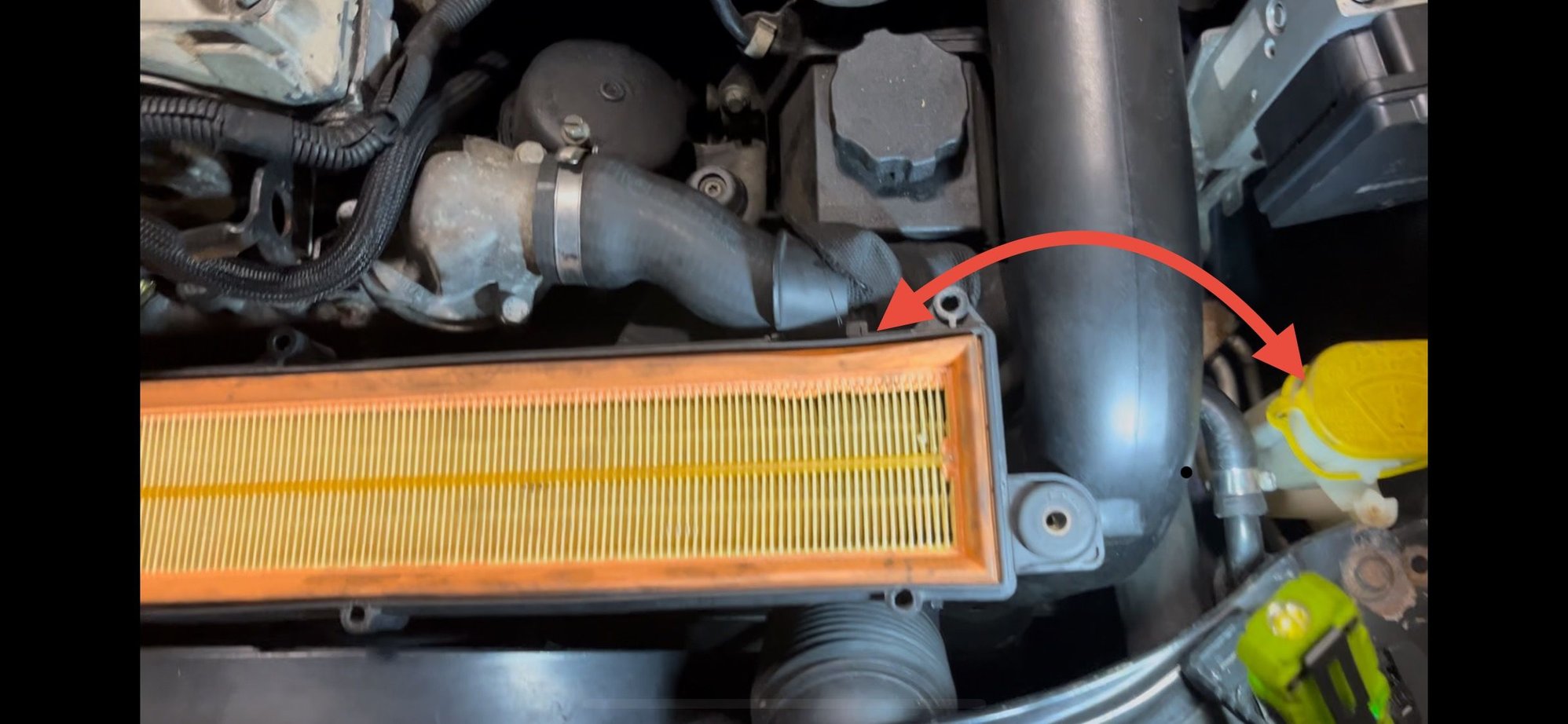

@C230 Sport Coup , it’s the area near the power steering pump. The closest pic you have to that area is pic #2, but it’s too dark & I can’t see if you have the same smaller 0.5” width hose which is touching the pulley in my pic & that I have running underneath the bigger 2” fabric covered (frayed in mine) hose to the upper left area of your pic.
Could you record a video of that area that pans to the right facing towards the car & “over” the black plastic pipe that runs from the back of the engine bay to the front (I think it goes to the filter box) ending where the yellow washer fluid reservoir cap is showing the end of the hose connections going into the front? (radiator?) (I seem to have 2: the large 2” hose & the problematic 0.5” one (I still have no idea what it is! ), see 3rd pic in my original post)
(I’ve attached a more zoomed out photo facing the engine bay, driver’s side, showing the filter box, plastic black pipe (with red arrow indicating the pan) & yellow washer fluid reservoir cap for reference if it helps).
Facing front engine bay, (US) drivers’ side, near filter box
PS: I think the forum only allows .MP(E)G & .MOV (QT) videos, so if it won’t post, please DM or text it to me.
This would help greatly, thanks!

Ummm to the right of the filter box. OK, what are you looking for ?
Do you know how to remove the filter box? Just unscrew hose on left, slide clip in
intake, and pull straght up to get a beter photo of what it is thats in issue.
From memory to the right of the filter box is a hose coming from the supercharger via the intercooler.
So....what's the question?

@C230 Sport Coup I want to see from a *stock car* (which yours seems to be) some lighted pics (see pic1~3 in original post) and/or a video pan as shown in my reply (post #19) above (see red pan arrow) to confirm the routing/length of this hose is incorrect & not OEM spec.
For your convenience I am reattaching the photos mentioned, below (for spatial reference the large black (plastic?) pipe right above the power steering pump is colored purple in the images below):
Closer left view
Closer left view of power steering pump pulley & belt showing contact point (see top right of image)
Right view (smaller hose exits at bottom left of pic & enters from center area)
Right view of opposite side near washer fluid reservoir cap (smaller hose exits at bottom left of pic & enters from center area)
Zoomed out view facing front engine bay, (US) drivers’ side, near filter box (before removal, sorry)- large pipe on right is what is purple in earlier images
I hope this makes clear which area of the car I am talking about?
Summary: In the original post I have 3 photos showing the issue after the filter box was removed, ie: a hose of some sort that has a (frayed) fabric wrap around it that is dangerously close to the power steering pump pulley. I don’t think a zip tie will help, it just seems badly routed (I’m guessing it was too long and they were too lazy to trim it to length before installing it). I am thinking of cutting it to length but am afraid it will lose pressure & spew whatever flows in it.

Old Mar 22, 2026 | 03:01 PM
C230 Sport Coup's Avatar
Joined: Jun 2002
Posts: 7,268
Likes: 172
From: So. Oregon Coast
I honestly thought you would have fixed this by now...
It's still not clear to me what the issue is.
So PM your ph number,. I'll text you and we'll set up a time
where I can be standing in front of the car and get this sorted out.
And provide your 1st name at least in the PM. Sound good?
