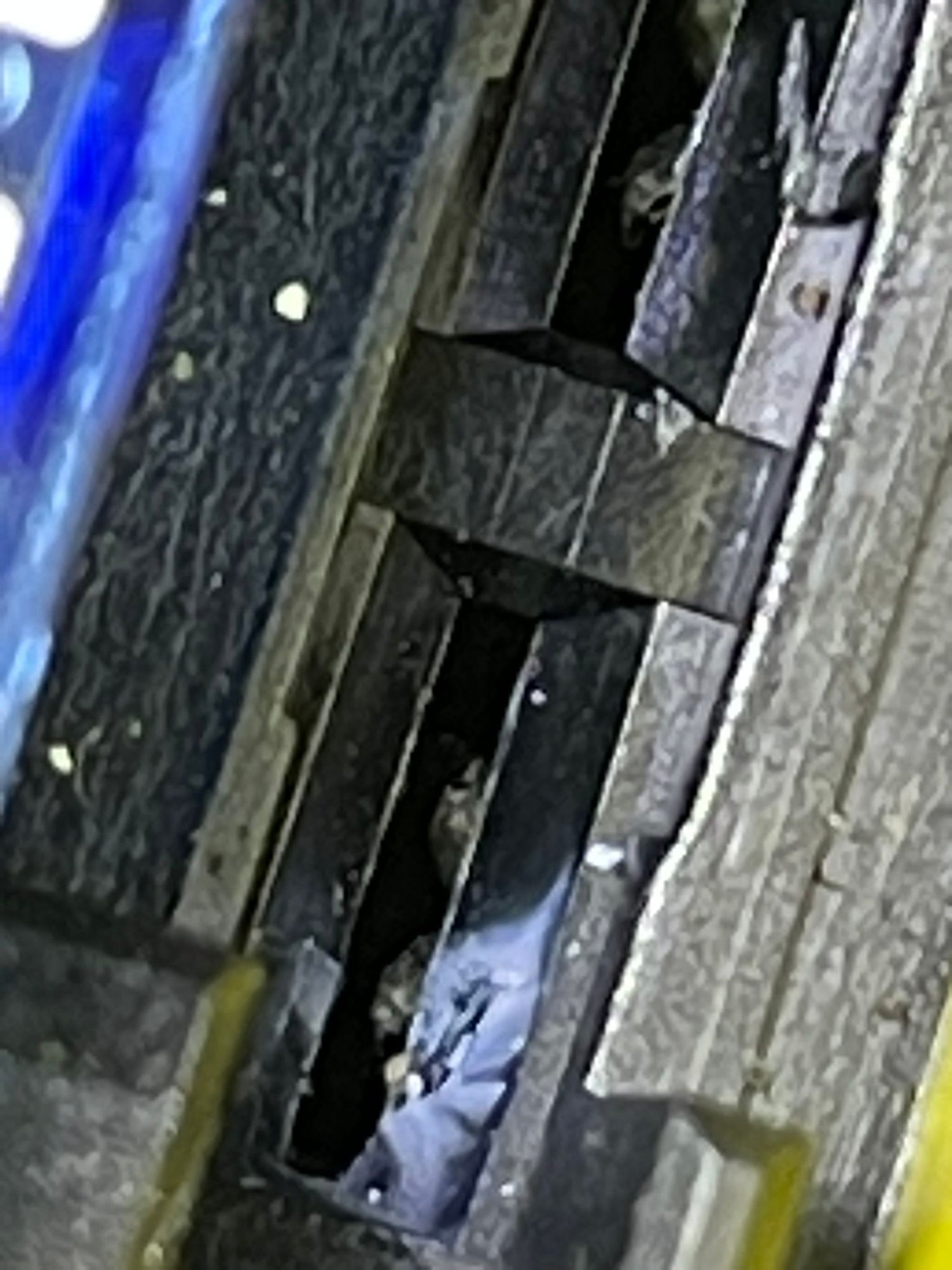

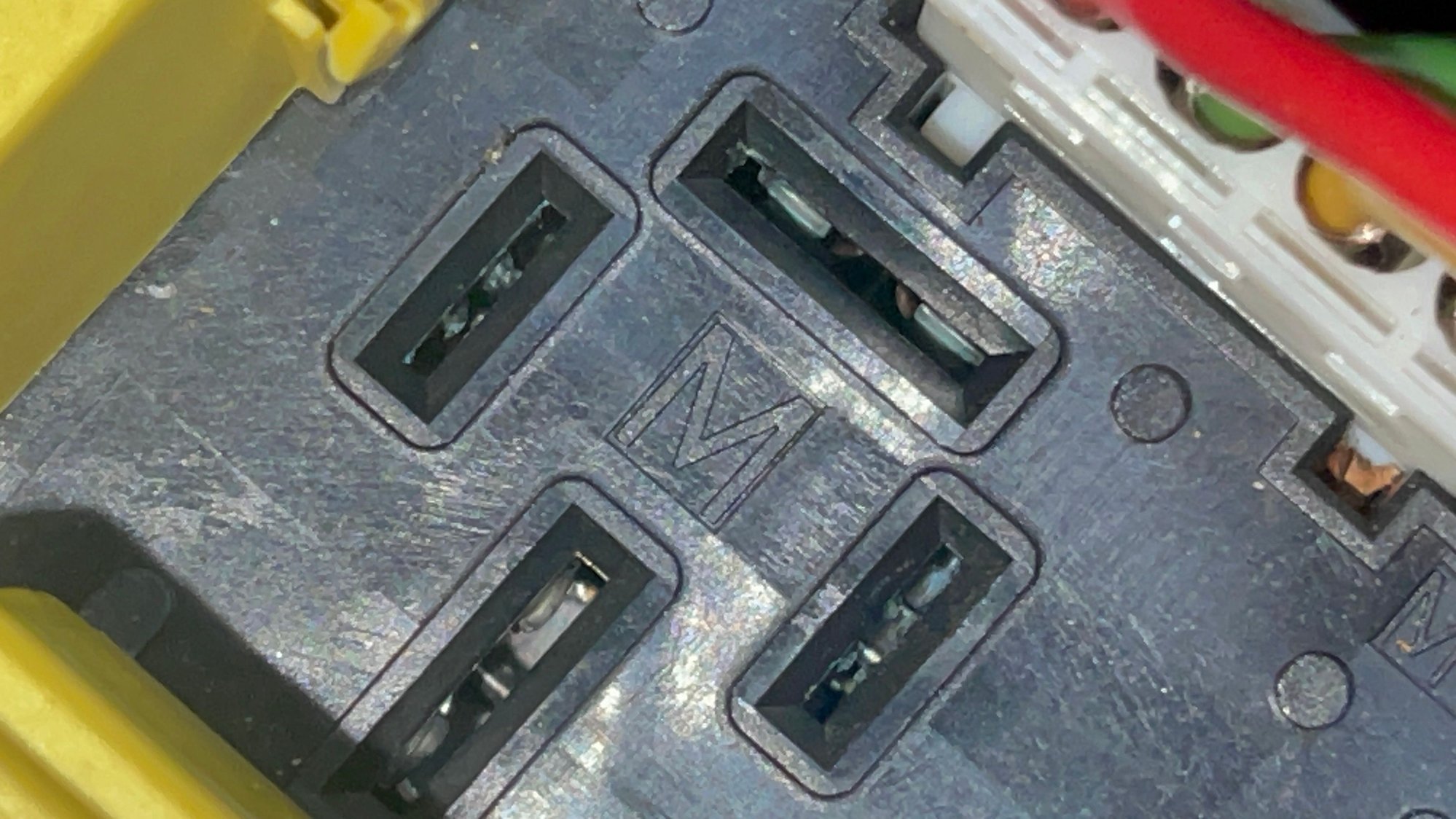

the only evidence of any electrical issues are.. Front Sam had some corrosion under some of the relays and fuses. tried my best to clean them up and put them back in (might take the whole sam out and check inside)

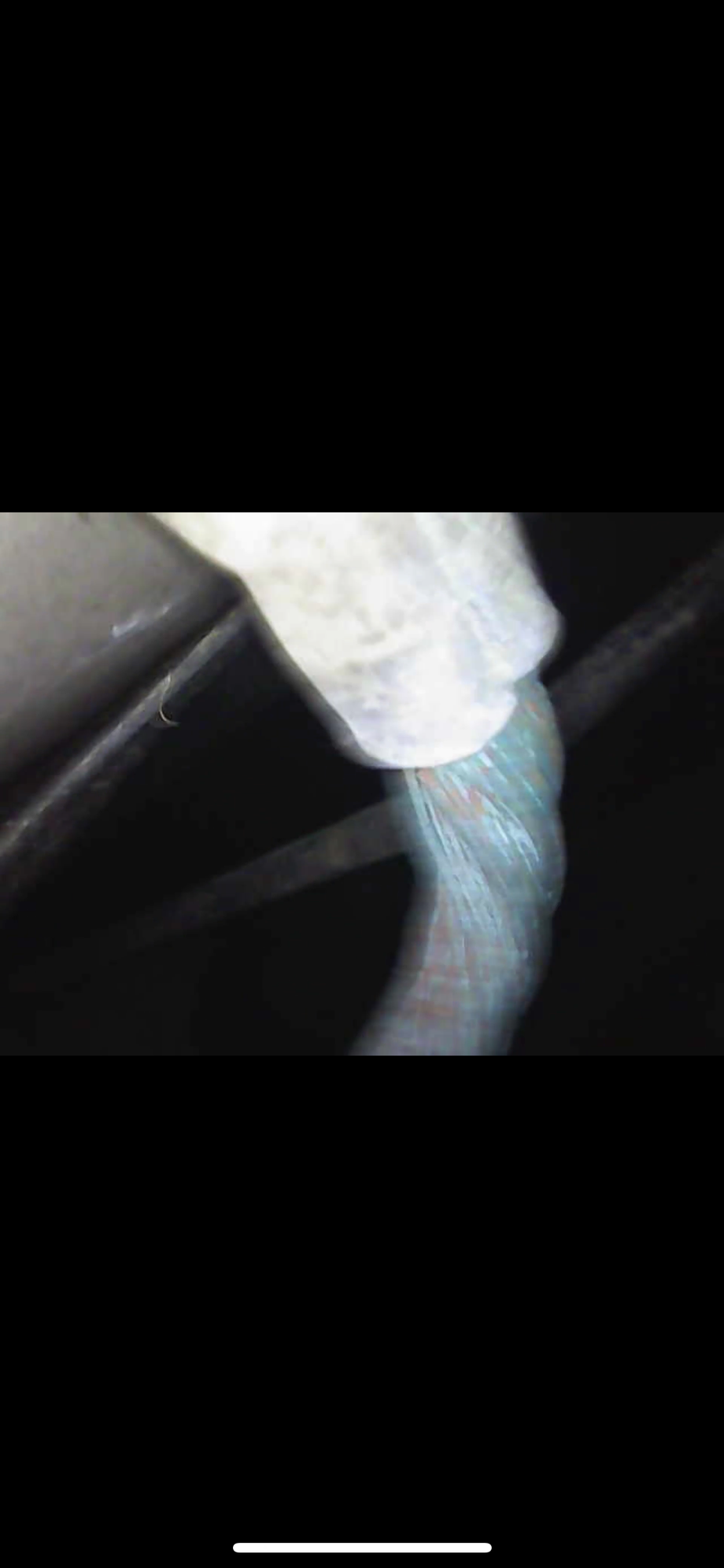

ground strap from the transmission is green/corroded
and a bit frayed (i will upload some pictures)

It probably isnt the source of your problems but check the resistance of the ground cable from the battery to the chassis. I had weird electrical issues a while ago and although it looked completely fine on the outside when i checked the cable it was like 150 ohm and when i pulled off the ring terminal there was massive corrosion that had worked its way up and inside the wire.
