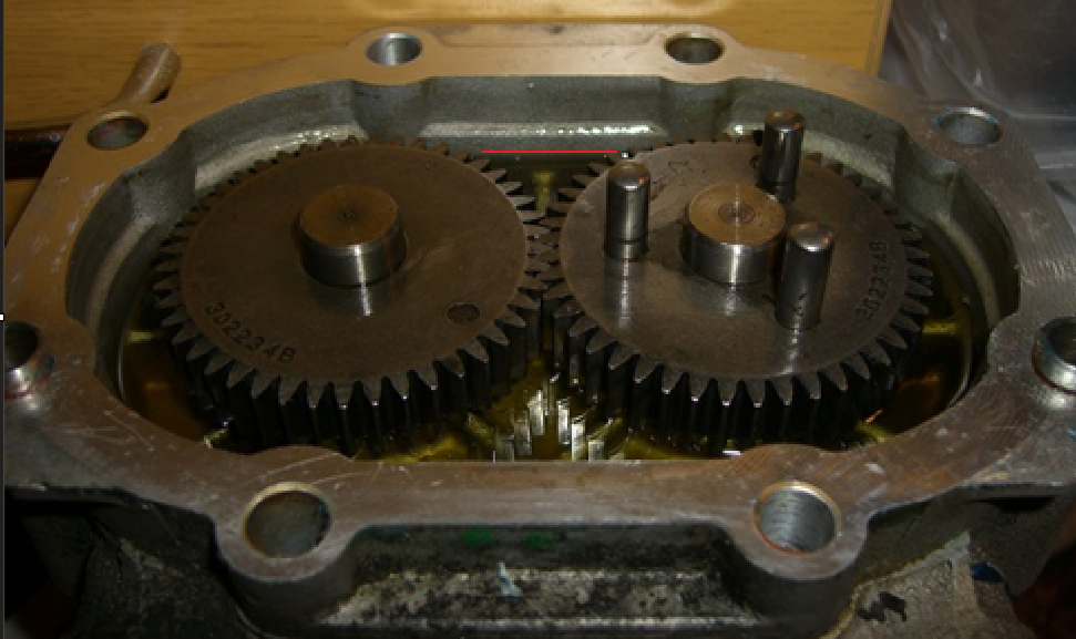

oil level
oil level
The red line is the 110 ml level. So it is not much.
