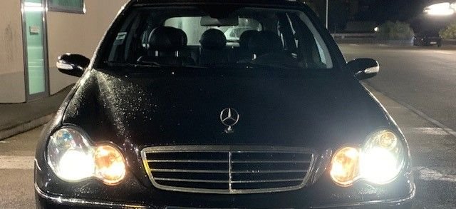

For the past three years i've had some trouble with the right headlamp. In the beginning it would light a few seconds after the left one, so i didn't really take it serious. This past few months, it rarely lights up when i start the car, only comes on when i hit a pothole or a bump, which is really weird. It is really dim compared to the other one as you can see in the image attached. I have tried to switch the bulb, with no effect.
Since i don't want to waste any more money than what i have to in this matter, i need to be certain it is the ballast.

Swap the ballasts between both headlamps and see if the problem follows.

Go get you some canbus decoders and wire them in behind your bulbs... it'll stop that "flicker" looks like you upgraded to LEDs and if yours was the halogen model the halogen runs off a pulse.... you'd have to have low grade LEDs in order for it not to affect it but those canbus decoders should do the trick..
also take off the covers from behind your headlight assemblies and look in at your wiring harnesses internally on the headlight... only saying this because certain years they used a degradable shielding on the wiring..... it could be deteriorated and just shorting out on itself.
