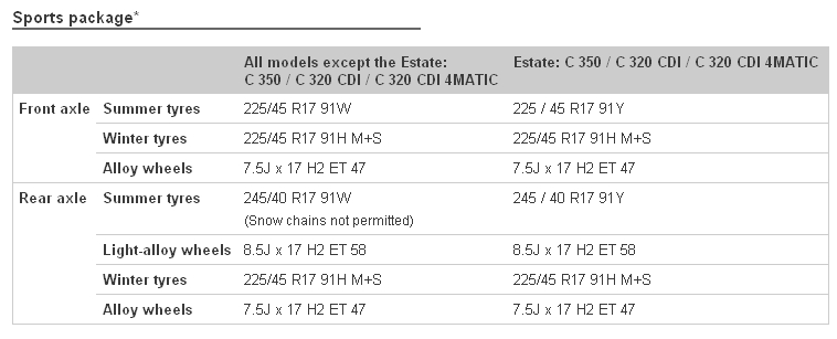

From the Mercedes C Class interactive on-line manual
http://www4.mercedes-benz.com/e/cars...en/N28877.html
wheel offsets for the standard sport package are as per the attached jpg.
(Note: Wheel size: 7.5J x 17 H2 ET 47 <--- means offset of 47)
