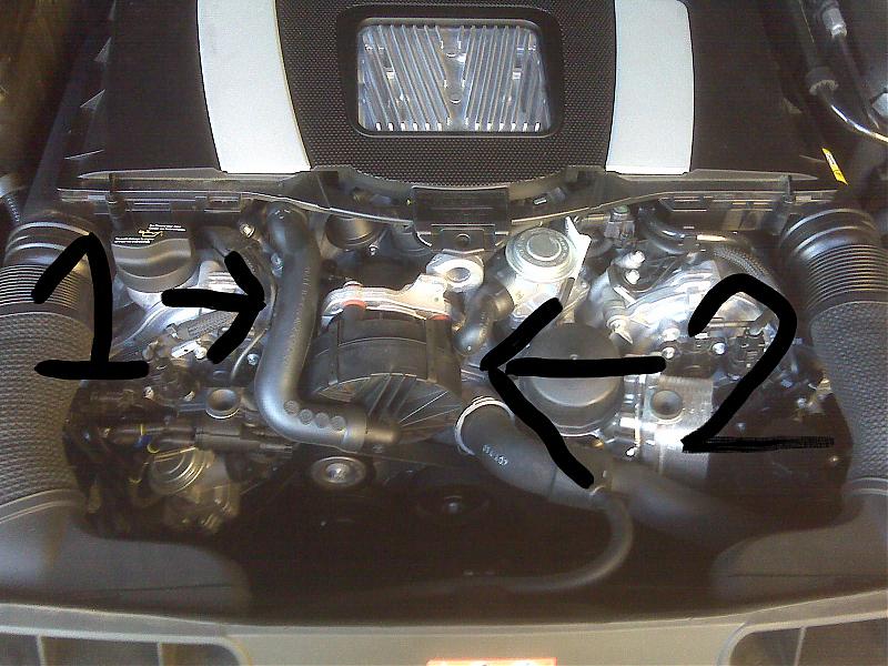

Im trying to put new K&N filters in but this tub (number1) is part of the air box i think from how it looks. If so what dose the tub hook in to (number two)

You can remove the air box by lifting up which will remove the air box off it's clips the hose will come off but be sure to put it back on when you done with it

The two intake hoses on the far right and left need to be disconnected too. The #1 hose comes off easily. You can then pull the airbox up and off of the engine.
