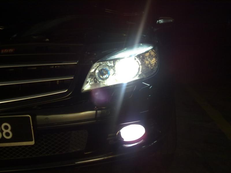

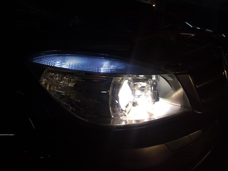

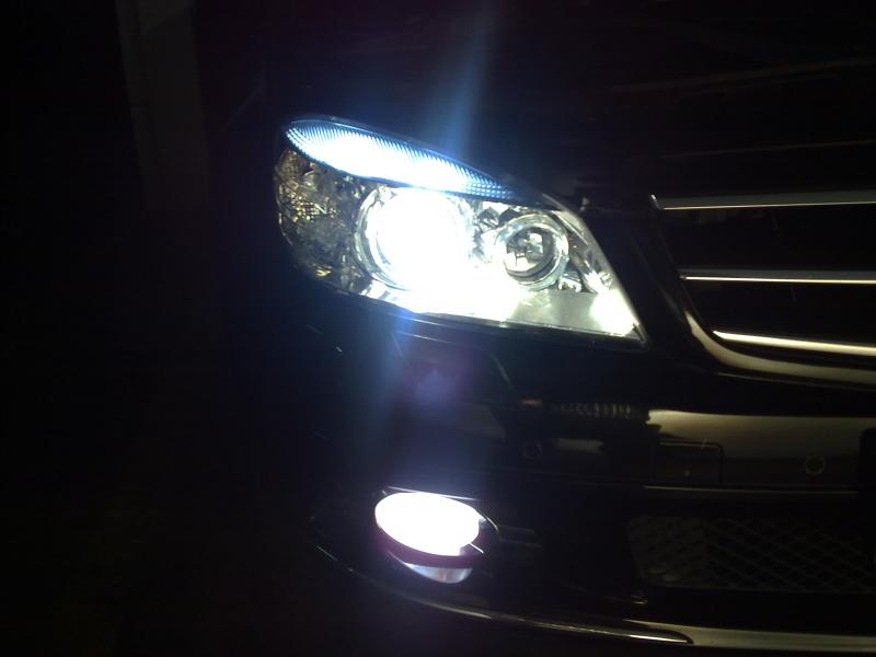

A review i am doing for the LEDs.
Shipment took about 3 weeks from there to South East Asia
A little tip that i found, if I push the LEDs far too into the socket, the light wouldnt come on and the LED would get super heated, I have to pull out a little bit for them to work, I figured it is because the connector inside the socket would "touch" the resistors on the board and thus creating short circuit, therefore to properly place them you have to be careful not to push it all the way in.
below are some pictures of Ebay LEDs ( they claimed it is white but you'll see) vs AZN White LEDs, with stock xenon and Michiba White Fog lights.
photos are taken by my N97.. couldnt be assed to get the DSRL .. so picture color might not be as true
Ebay LEDs
AZN white LEDs
To me the blueish LED looks cooler, colder, looks slightly better to have them alone on, but it does not match with my stock xenon and my white fogs.
AZN's LEDs are significantly brighter, the color matches my stock xenon and my white fogs as you may see for them attachments.
Compare with Polargs that I tried before, these are whiter, brighter, more accurate in color.
Attached Thumbnails AZN'S NEW LED REVIEW THREAD-11082010703.jpg   AZN'S NEW LED REVIEW THREAD-11082010704.jpg   AZN'S NEW LED REVIEW THREAD-11082010705.jpg   AZN'S NEW LED REVIEW THREAD-11082010706.jpg
