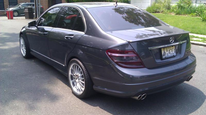

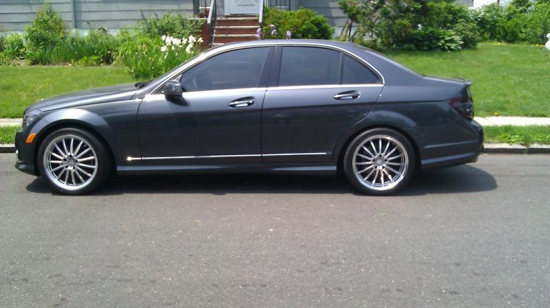

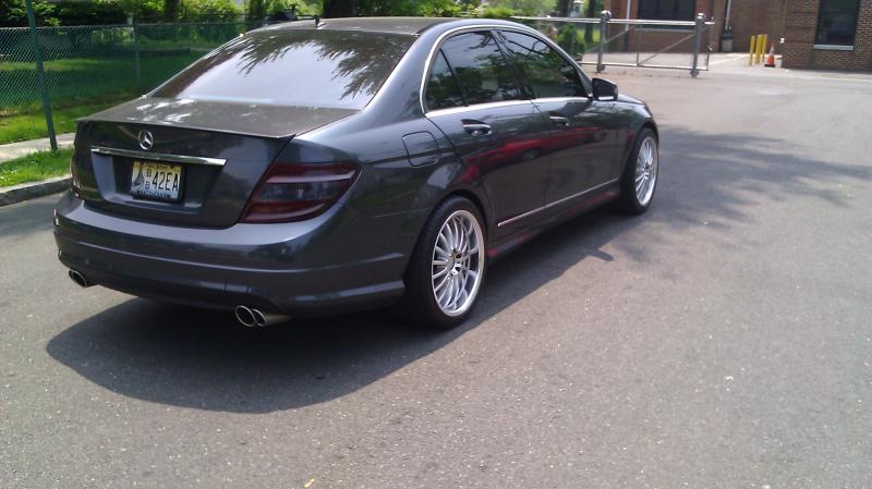

I found a good deal on a set of Mandrus wheels that came off an E55 so I jumped on it! Here are the specs and pics!
Offset 32 front-35 rear
Tires 245 40 18 front - 265 35 18 rear

Nice wheels but looks like they are sticking out

Rubbing a little in the rear when I go over bumps, getting 255 35 18 tires for the rear tomorrow. 265 is too wide.

Offsets are pretty low but still looks good to me.
I run Mandrus wheels at 42front 52 Rear

Really nice wheels, looks just a little off, but still really sharp - how good was the deal that made you settle with the not so perfect offset?
Any better pics or details on the exhaust tips? they also look really nice...
