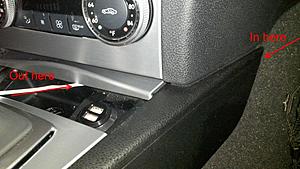

Is it possible to run a cable under the side panel of the center console through to the ashtray with drilling a hole? See pic. I am trying to run a micro USB cable into the ashtray. Thanks.

yes it is. 2 ways to do it. go through the center console behind the cup holders, theres a bolt under the pull out "change" holder or whatever it is. Then just snap it up and fish. OR pull the shift boot up and out with a careful pry tool, cover it or use plastic so u dont scratch anything and fish from there. U will have to remove the whole front section if you wanna pull it out and work under there, thats a pain, I ran remote bass control next to command knob and it took a while
