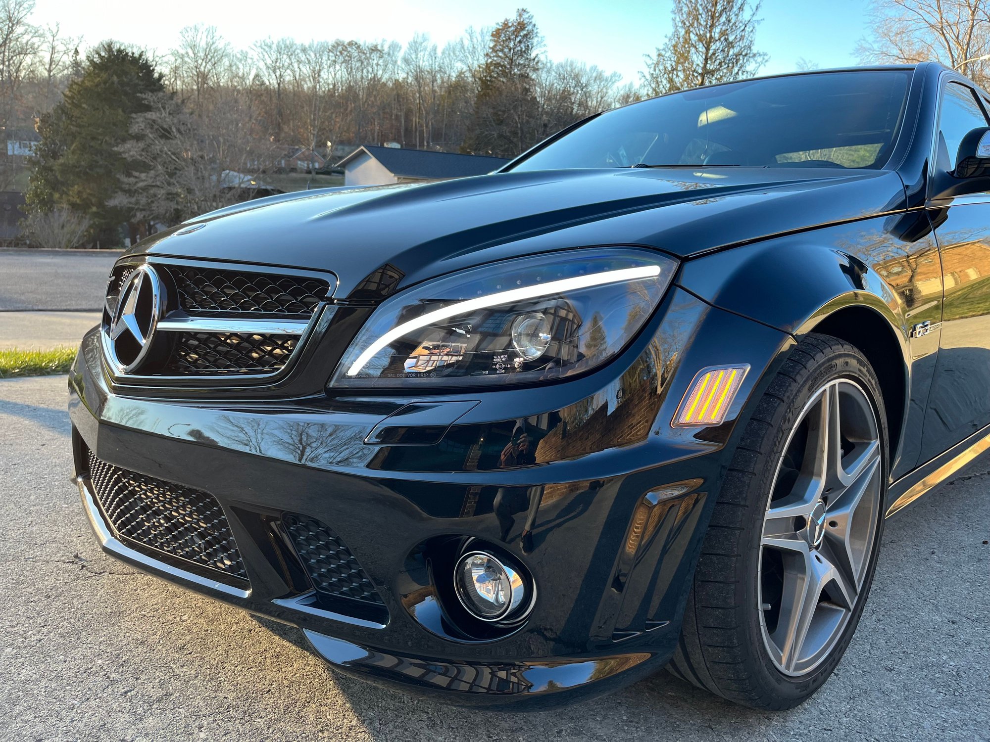

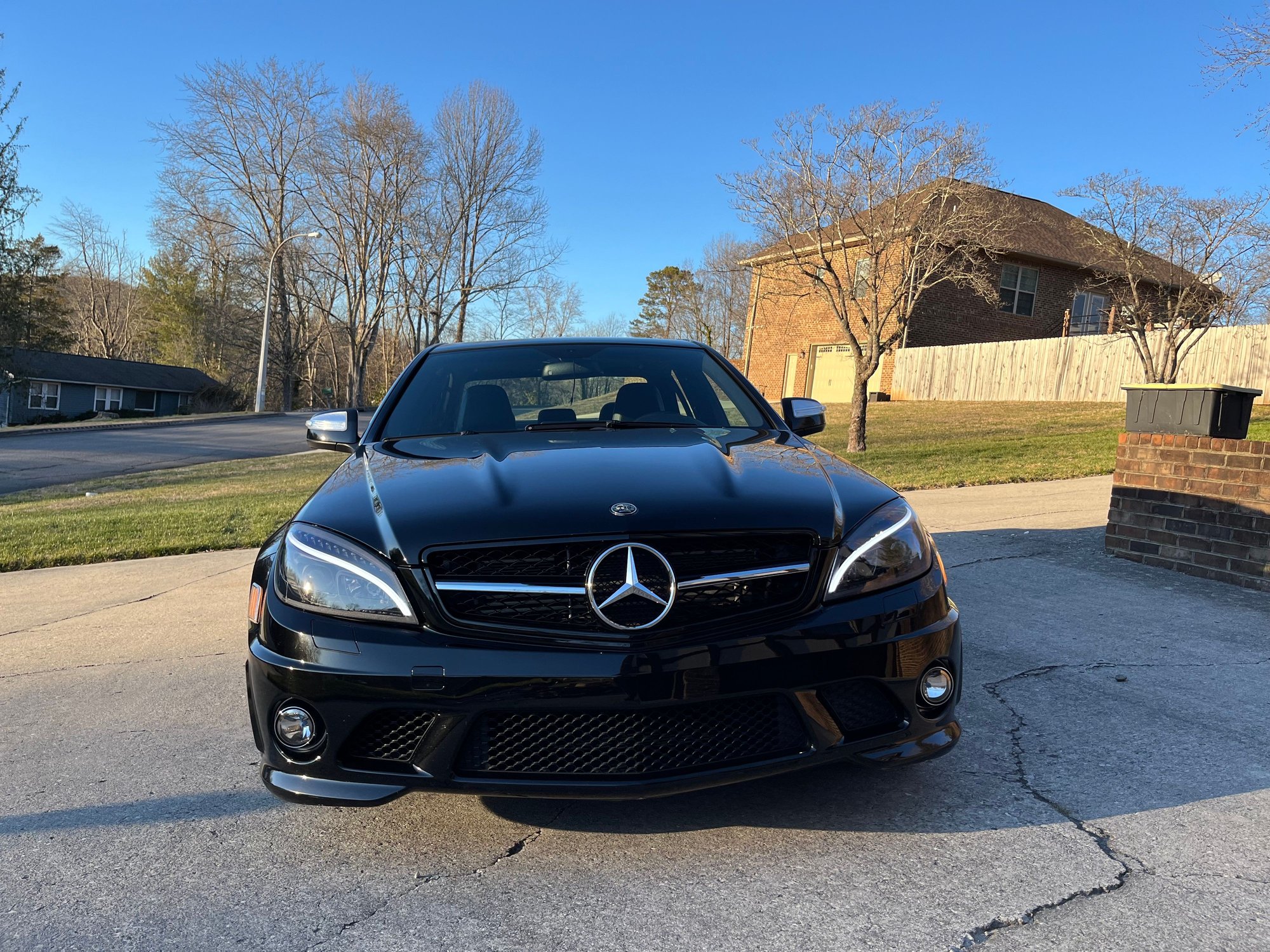

Here you go @Krille_krille I know this is a old post but replaced mine recently. Just replaced the clear lenses on the OEM HID's and storing them while they look new if...big if....I ever sell my C63. Had to make a custom adapter to make these work. . Can also try to hit up SpecD as they have an adapter that goes from HID factory plug to halogen. Not advertised anywhere....but they have it. Supposed to go with the "new" W204 LED head lights they sell. But they may sell them separately. I reversed engineered off that plug before I returned them. I liked those lights but produced parking light errors that they say is a known issue. So returned those until they figure out the issue and went with these instead.
