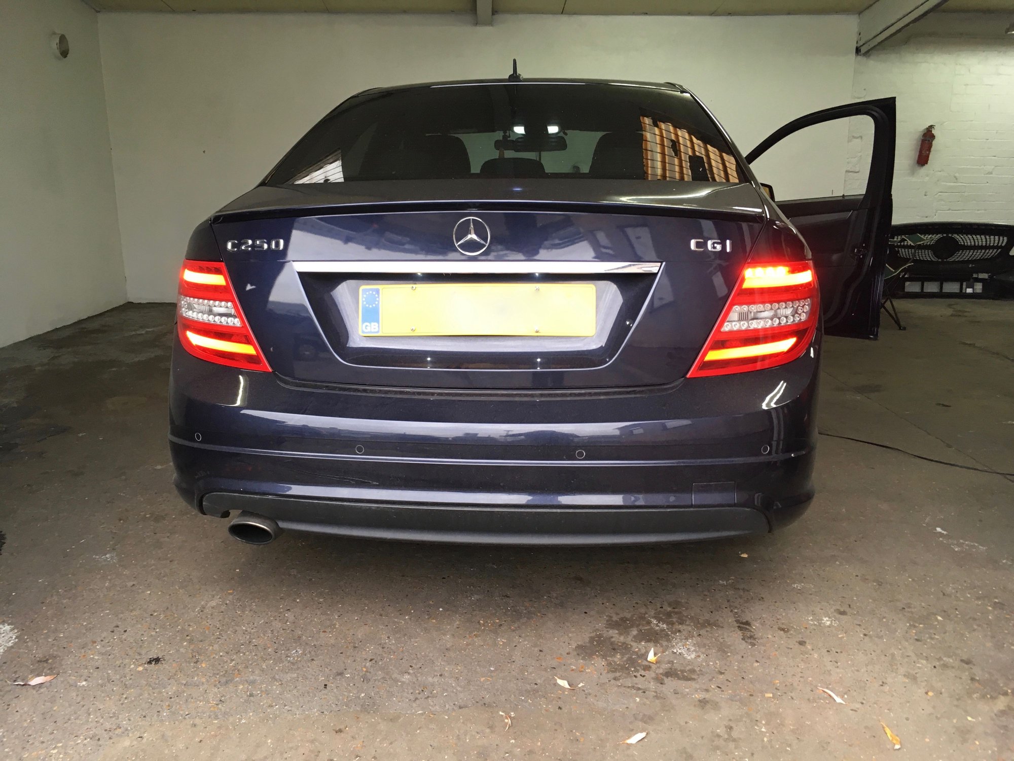

Many thanks to Paul for recommending London Code. Ask for Faheim. He knows his stuff. Well worth the trip!
For all those who have said that you need to buy a new SAM from a facelift model and then program it, Its all BS. No need for that. You just need a competent mechanic who can program your 2010 SAM with the new face lift rears.
The last pic is with tail lights and fog lights on working as they should and most importantly no stupid Fog light error!!
My car is C250 CGi first registered on 30/12/2010 (I'm in the UK)
Thanks
Minesh
