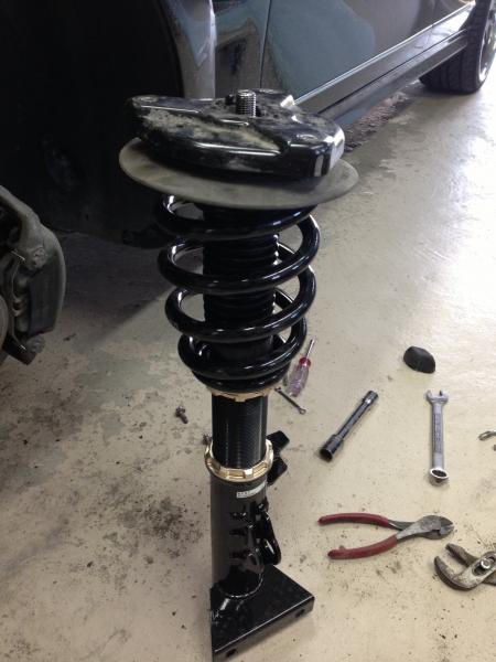

I have received the coilovers a couple of weeks ago. They were on back order so it's been a long while since I ordered them now.
I was busy doing the facelift conversion of my 2010 C350 to a 2012 C63. Now that esthetics are all done I will unwrap my BC coilovers
I have found out thet there is NO camber adjustment on my BC coilovers (as they picture on their websites) That sucks big time because it was one of the main reason why I chose BC over the other brands.. I guess i will have to play with the adjustment from the bottom.

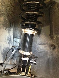

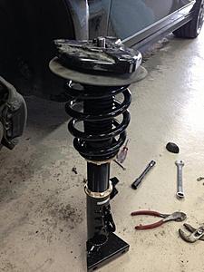

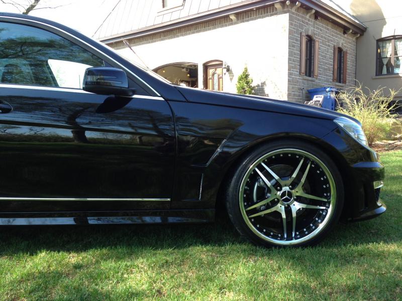

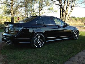

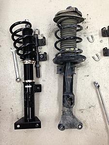

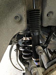

Here we are! I have installed my BC coilovers last week-end. It took me about 5hrs to install them and another 4-5hrs to find the right height and adjust the camber.
For those who might wonder, there is enough stock camber adjustment on the front. I have managed to bring it to spec without any problems. I used a 24inch level on the wheel to find the original camber and I have set the same adjustment to my new set-up. I must have removed the wheels like 100 times (well, at least 5 times) I could have lowered more and still have adjustment left to play with. Also I used a filler gauge between the camber bolt and spindle to be able to set it to the right position at first try on every spring. On the rear I have a little negative camber but I doubt I can do much about it. I was thinking of buying adjustable upper arm but this would push the top of the wheels to the outside and I have no play at all.
My wheels do not rub the fenders under normal driving conditions, even on a rough road but my wife came back with the trunk full of grocery and it rubbed just a bit on the rear at a place that was predictible because of the road condition. I might raise the rear just a little if this happens again.
Positive points: Ride is as smooth as original, Front coilovers can be adjusted for height in 5 minutes each side.
Negative point: Rear camber is not perfect, height adjustment on the rear is a little longer because you need to drop the A-arm in order to have enough room. (no need to remove the coil spring though). That is 3 bolts: the lower shock bolt, the upper sway bar link bolt and the lower spindle bolt which is a pain in the butt to remove in my opinion.
I would recomand the BC coilovers to anyone who is using his car for daily driving and occasional track days. i guess it would be fun to play with the damping in race conditions.
Oh yes end I want to assure everyone, you will see on the photos that my wheel wells are extremely dirty but that is the result of the winter in Canada. Everything is now clean just like brand new
Attached Thumbnails Coilovers D2 Racing VS KSport Kontrol Pro-photo-1.jpg   Coilovers D2 Racing VS KSport Kontrol Pro-photo-2.jpg   Coilovers D2 Racing VS KSport Kontrol Pro-photo-3.jpg   Coilovers D2 Racing VS KSport Kontrol Pro-photo-4.jpg

Now I understand why people post photos of their cars.. I mean, after all those hours spent on them we have a little pride right? Here is the final look.
Cheers!

Look TIGHT !!!! Nice Job !!!! Mind me asking where did you get the exhaust

Thanks mate! I got them off from eBay. The seller is in Hawai. The quality seems really good and the shipping was really fast. They have the AMG logo casted on the top.

Nice work man! I like the front end and rear! Looks great! Take some pictures whenever you slam it

specs on wheels/tires?

Tires are 235-35-ZR19 front and 265-30-ZR19 rear. This car is a rear Wheel drive, you could not run this set-up on a 4-matic.
Wheels are 19X9 front and 19X10 rear but I can't remember the offset. I think it was 45 all around.
