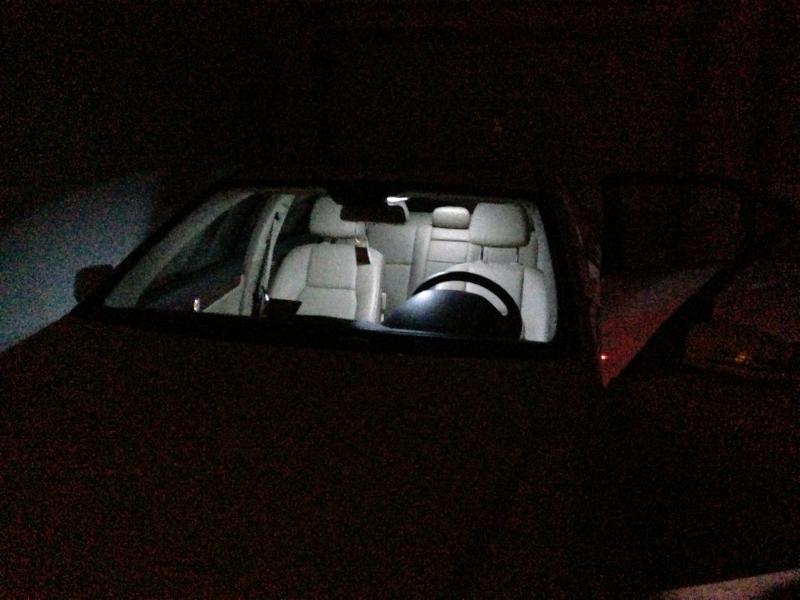

My PrecisonLED 8000k interior lights. Nice and cool bright
Attached Thumbnails Interior LED help-photo.jpg   Interior LED help-photo1.jpg
