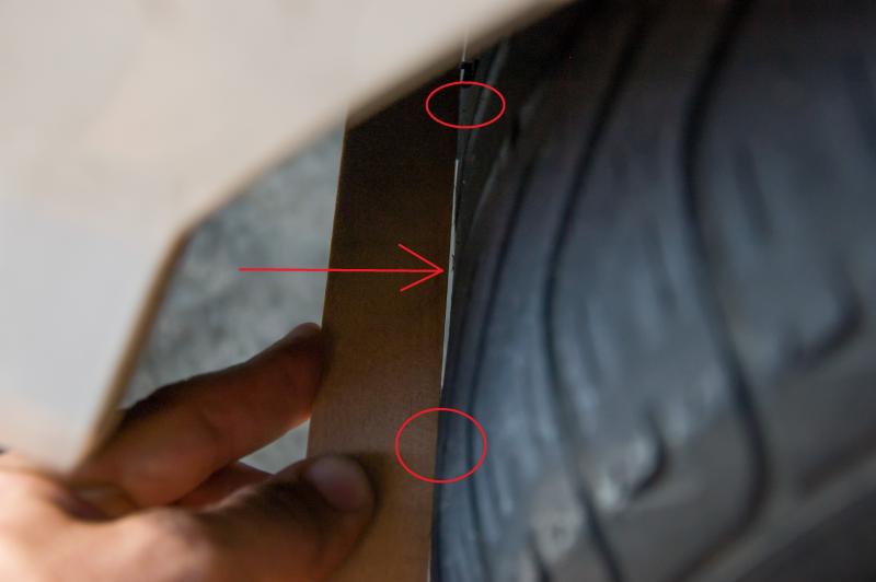

C300 (W204)
Can Someone Please Explain This (Tires)
See picture
C300
Rear tires inflated to 34 psi

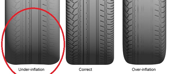

The tire wears out like it's under-inflated (http://www.rpmdaily.co.uk/wp-content...e-pressure.jpg)
Tried increasing pressure to 36 psi, tire still looks the same
Someone please chime in before I have to get new tires
Thank you

I assume you have staggered wheels. This is a problem with cars where you cannot rotate the tires. There will always be some sort of uneven tread wear and the tires do not last as long. You didn't mention lowering your car and that can do it also.
Is this on all the tires or just the rear?
Adam

Only on the rears (both). Stock suspension, not lowered. Staggered wheels with Michelin Pilot Sport A/S Plus, stock size.
I understand uneven wear due to changes in suspension or worn struts, bad alignment, etc. but this does not look like it.

Am on my mobile, so the pic is a little hard to see.
It looks like the center is worn more than the sides? If so, you're over-inflated, not under...
This is exactly what happens when tires cannot be rotated. If you pulled mine I bet the same thing....
