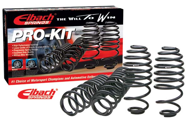

You could try the Eibach Anti-roll kit, some stiffer springs and a strut bar
http://www.cksperformance.com/index....h=27_71_41_111
http://www.cksperformance.com/index....7_71_1493_1855

would not it will be wrong if I change springs on a stock suspension ?

From what I read by other posters, the eibach sway bars help a lot. Some even say to change those before you change springs as springs are more so aesthetics.

I've written about the handling improvements I've made so search for my threads. In short, Eibach antisway bars, Bilstein B6 struts, and SMERC strut tower brace make for outstanding handling, very good ride comfort, and no loss of ride height, which was important to me (driveway entrances, snow, etc.). I did not want to change the springs and in retrospect am glad I kept the stock spec. Also, Michelin Pilot Sport AS3 should be a consideration.
