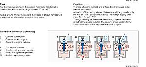

I would say so. This thermostat is well over engineer! It got a center shaft which is heated to help opening of one of the three stages valves! I don't see anything else that can trigger this message…. I just replace mine, took me about two hours. And the thermostat was order from states for $112.00 + shipping and duties… Just in case , take a good look at the wires connected to it and if you got access to an ohmmeter, there should be 15.2 ohms between the two connections...
Attached Thumbnails P0128 code please help-capture-di-cran-2014-01-25-16.19.50.jpeg
