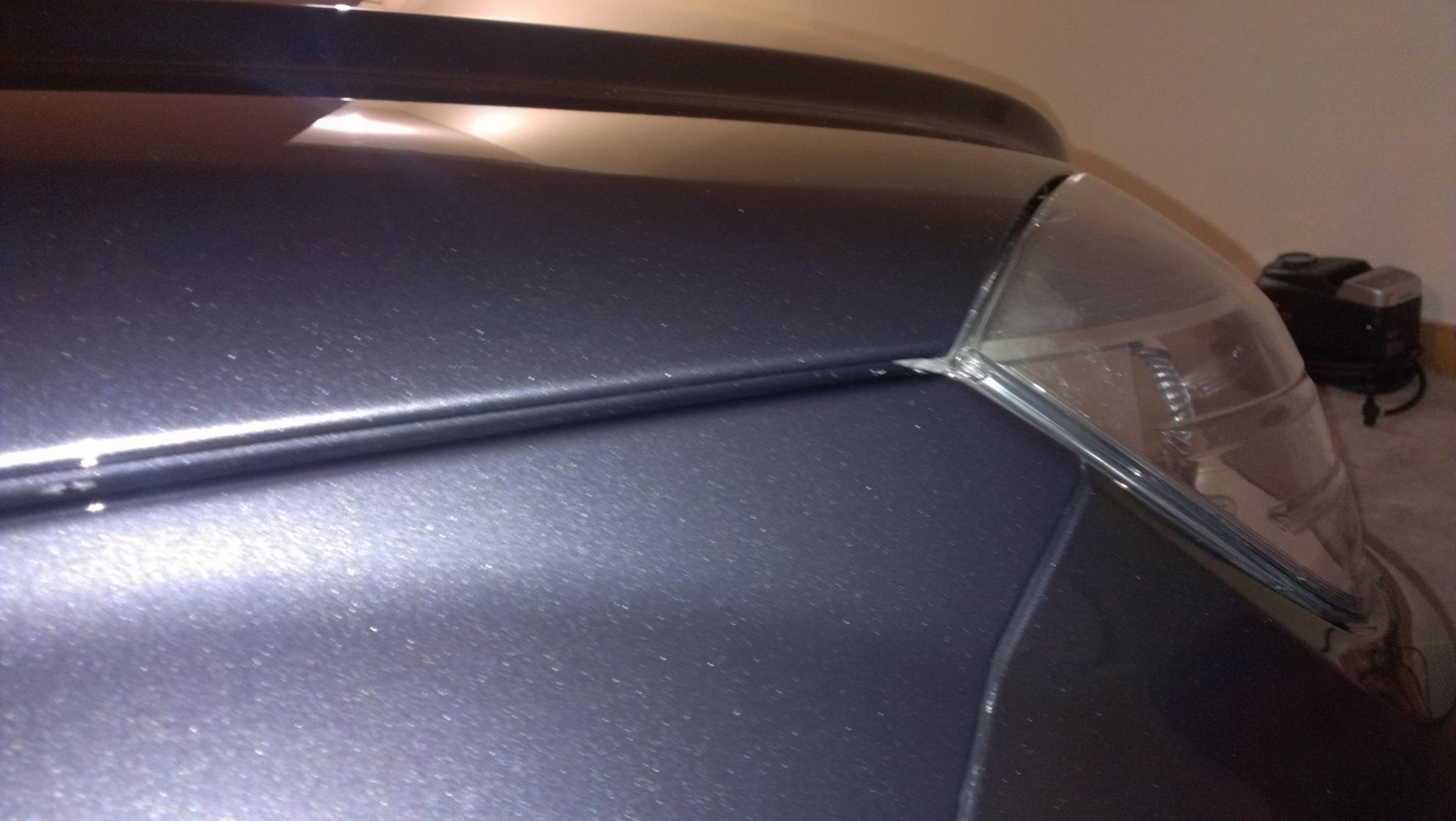

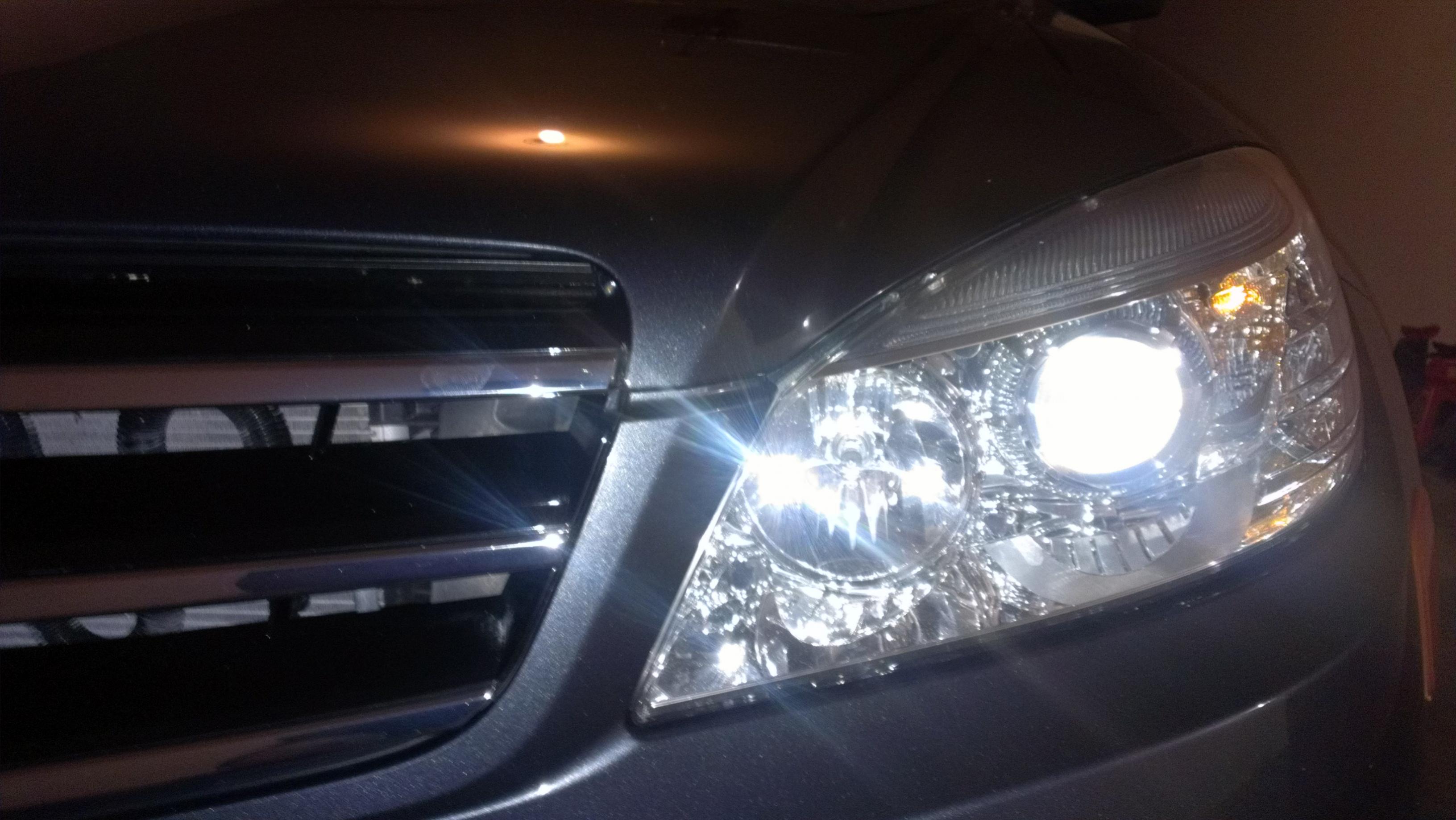

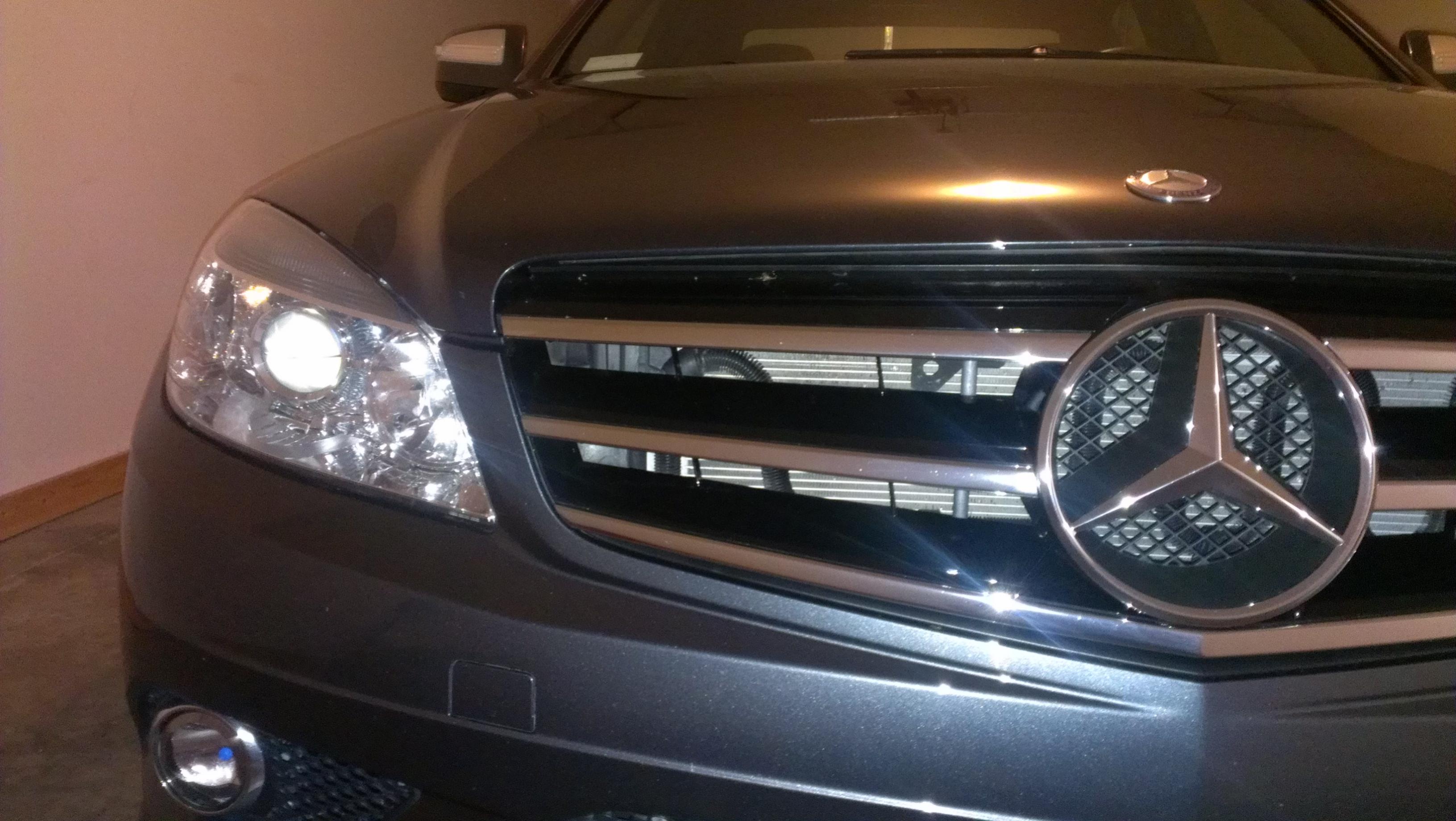

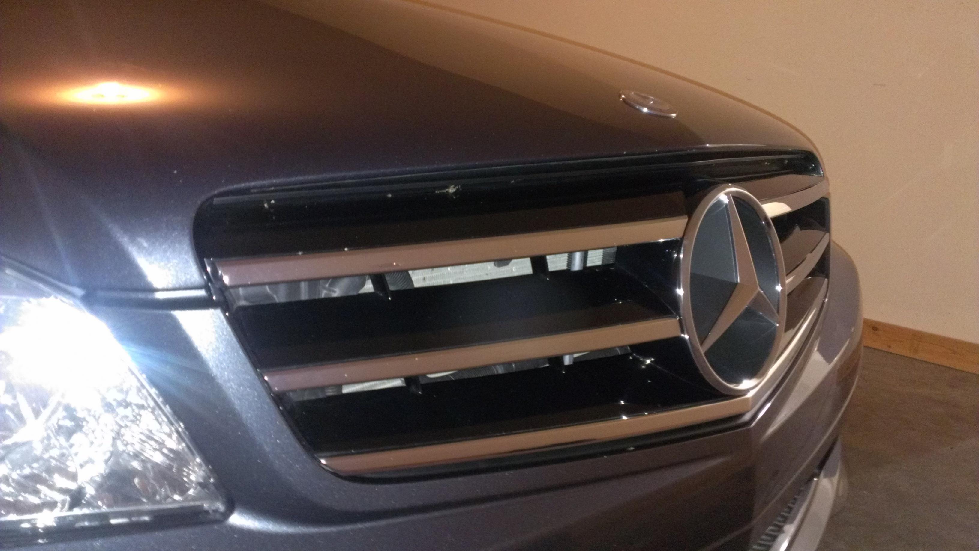

I bought an OEM Black Sport Grill to replace the silver one.
Does fitment look right to you?
Looks off to me. Seems like the hood should go down farther?
Attached Thumbnails OEM Sport Grill not fitting correctly?-imag0335.jpg   OEM Sport Grill not fitting correctly?-imag0337.jpg   OEM Sport Grill not fitting correctly?-imag0336.jpg   OEM Sport Grill not fitting correctly?-imag0338.jpg

I think this is coming from your hood. Lift up the hood and you will see 2 stoppers under the hood. I think they're adjustable.

+1 on stoppers. not from the grille itself

Thanks! Yeah I did tweak the stopper back then but was afraid I might mess up something serious LOL. The stopper on my driver side wasn't tweak that but in the end the hood on that side was still lower than the one on passenger side. This made me second guessed myself. I will go lower on that this time then ...
