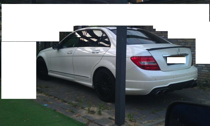

Hello everyone,
Im thinking of putting ML 63 Rims under my w204,Ive been looking all over the internet for pictures but I cant find a single one,was wondering maybe if any of you have a picture of that.
Also at this moment Im running 18 inch brock rims and the ML rims I want to get are 19 inch, my car is stock w204 with the AMG package.
Will the new rims give me any problems like rubbing etc?
Thanks for your help
Ive included a photo of my car and the rims Im thinking of if that helps

Need offsets and wheel widths to further assist you..

I think these are the numbers
ET: 45
Width : 8.5 J
5x 112
and there is a number without describtion 66.60
Thank you

well if there 8.5 45et all 4 corners they will fit.. I would do 235/35 in the front, and 245/35 rear with the proper spacer to be more fender flush. good luck
