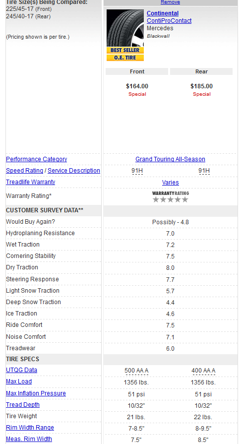

Old Aug 2, 2014 | 07:39 AM
Spec_Davis's Avatar
Joined: Jul 2008
Posts: 2,439
From: The Jersey Shore
W204 Color: 090 / 1999 Honda Civic EX / 2003 Acura TL
